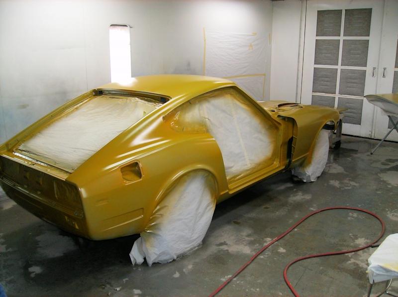

There's no need to remove those items if the cabin is properly sealed off. My car had the headliner, header vinyl, and some of the diamond cloth in place while the car was being painted, all well protected by the paint shop.
