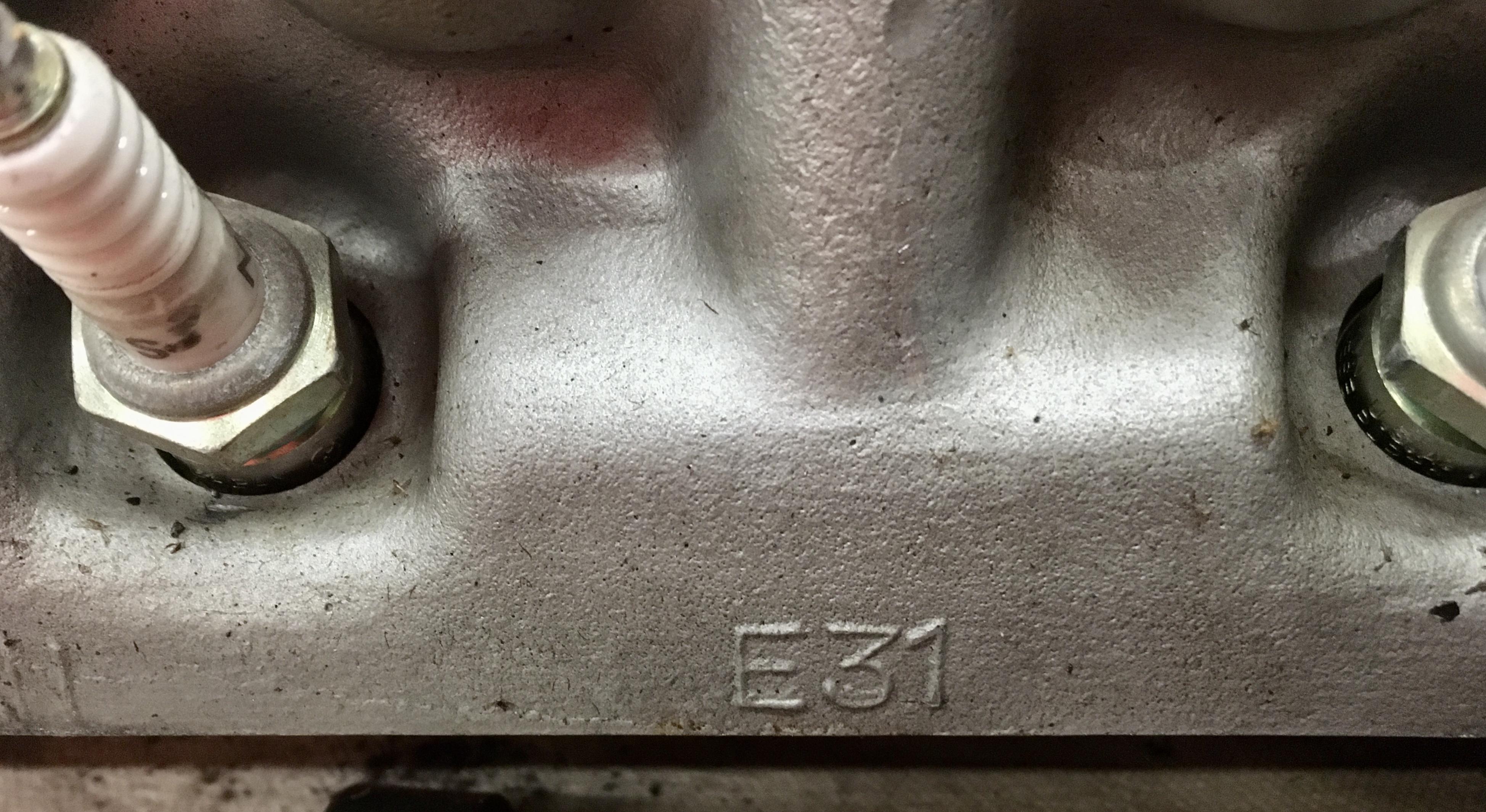

But an E31 . . . . . . .
. . . . . . the E31 that has been on 3 engines I built for my race car from 1989 to now.
It breathes very well. Dave at FloTechnics ported it for me, larger valves, cc'd the chambers, and had the head, intake and exhaust on his flowbench.
