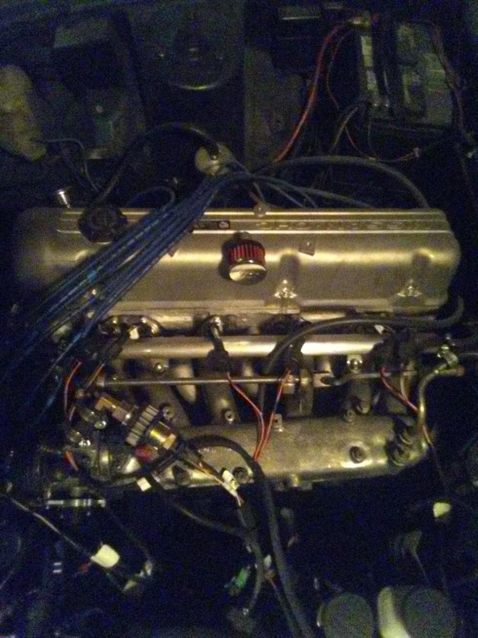

As far as new fuel rails go, I have been using this one from Z car depot that comes with an adjustable FPR. Of course you can get a separate FPR altogether and piece it all together yourself. I am using aftermarket EFI (FAST EFI) and decided to use the 14mm injectors that are found in post 2000 Ford and GM vehicles.  It is my understanding that the stock EFI won't run them properly.  So you'd have to select the option for stock fuel injectors for stock EFI.
https://zcardepot.com/collections/fuel-injection/products/fuel-injection-rail-kit-with-regulator-efi-280z-280zx#

You can install headers and run stock EFI, or aftermarket with no modifications/tuning required.  I have these headers:
