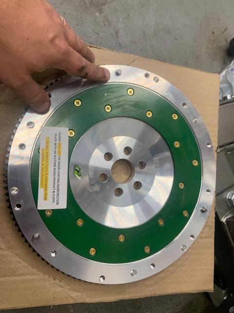

15 minutes ago, Wally said:
wonder why it says to get acetone and remove the green?
thanks
The green stuff is a protective coating to maintain the friction surface on the flywheel. If not removed before use it will foul the clutch disc. Lacquer thinner will probably work too, but acetone is a cleaner, better refined solvent. Be sure to do a wet wipe/dry wipe for final cleaning after getting all the protective coating off, to ensure it is completely clean.
Ah! I had no idea about this cleaning it off business and put mine together as is - a few thousand miles later and no clutch slip yet!! Fingers crossed [emoji848][emoji1696]
Ps. LOVING the orange Z@Wally !!!! Orange Zs are 23.6% cooler than the rest! [emoji106]
Fidanza has done a terrible job explaining what the green coating is and how it should be handled. They also refer to installation instructions on their web site but there are none to be found.  They have videos on Facebook, but none on their Youtube channel.
They're lucky that people like their product because their "media" presence is crap.  They've created lots of confusion.

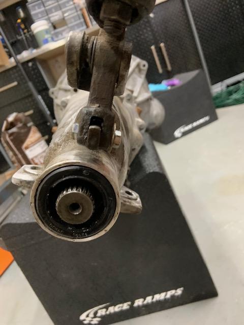

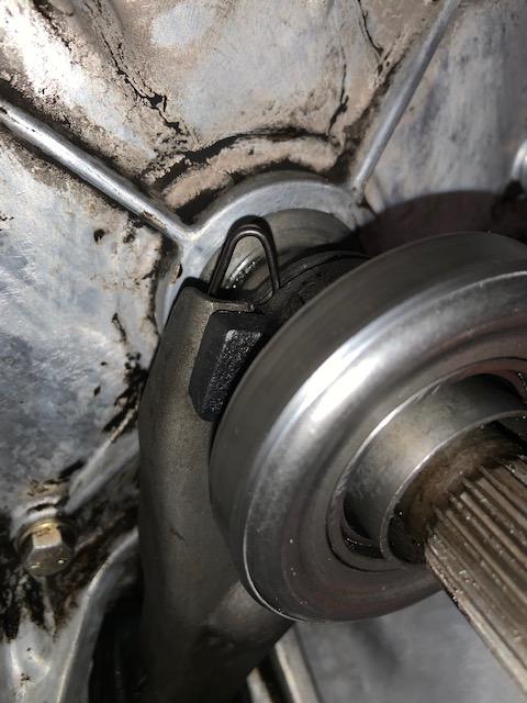

This doesn't help you at all Wally.  Make sure you get that throwout sleeve right though.  Post the number of the kit you got, or a picture, and the parts that came with it.  And the bearing/sleeve is just clipped on to the clutch fork, and the fork is clipped on to the pivot ball.  They both just pull off by hand.  Pull them out of your transmission and take a close look.  they should be cleaned up anyway.
