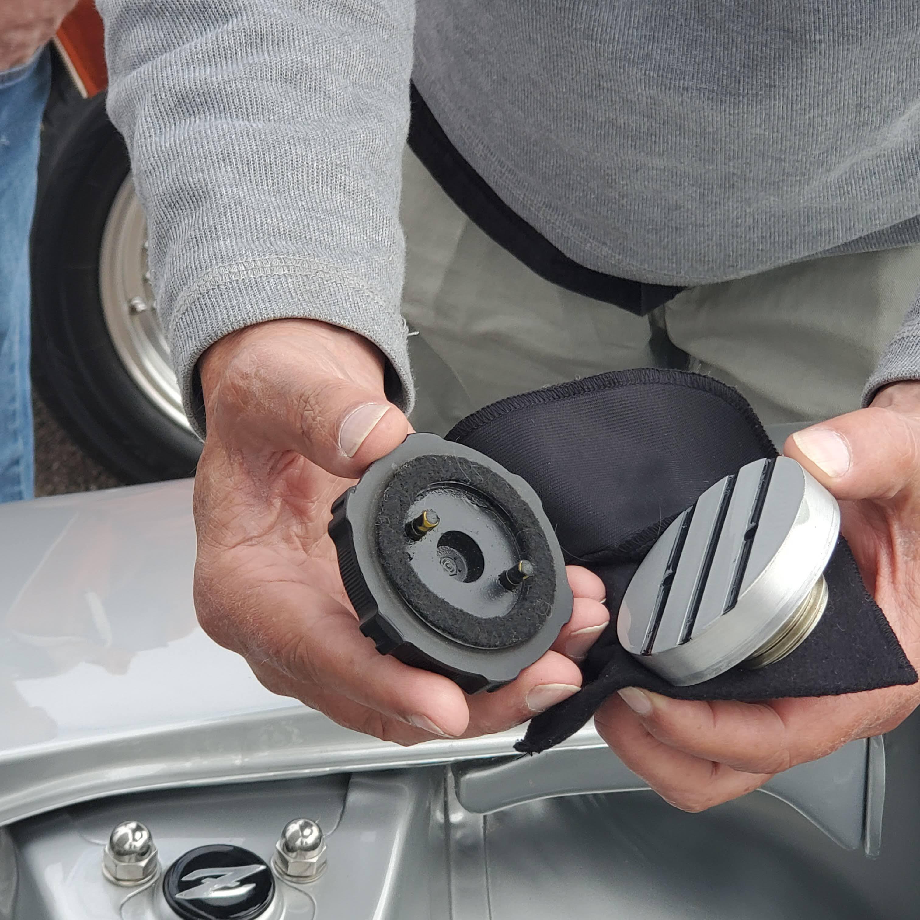

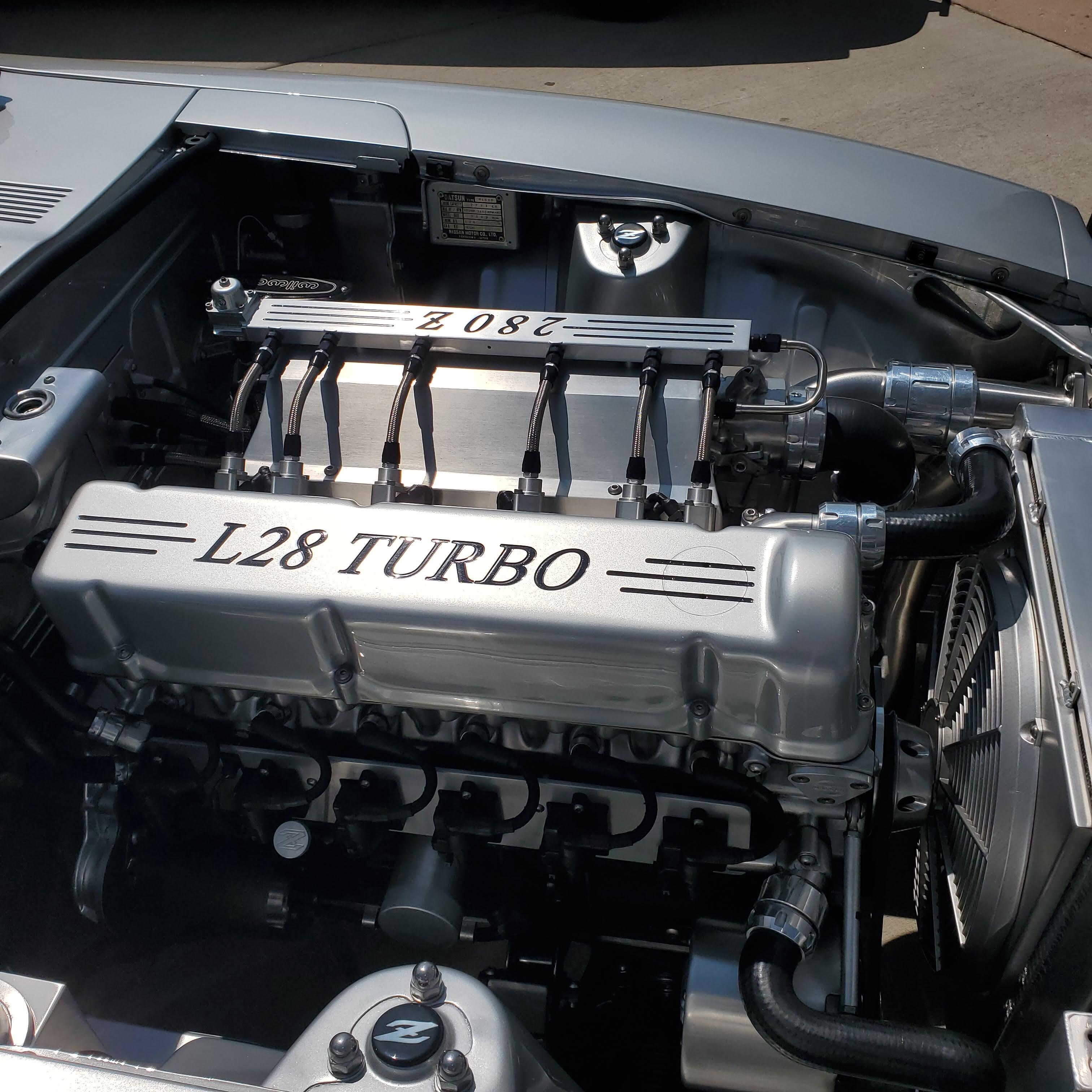

The top of the valve cover was cut out and a flat piece was welded in.  The "L28 Turbo" and grooves were machined in by CNC.  Note the oil filler.  The cap has an o-ring seal on its mating face with the welded-in plate.  He modified the OEM cap to make it a tool for operating the new one:

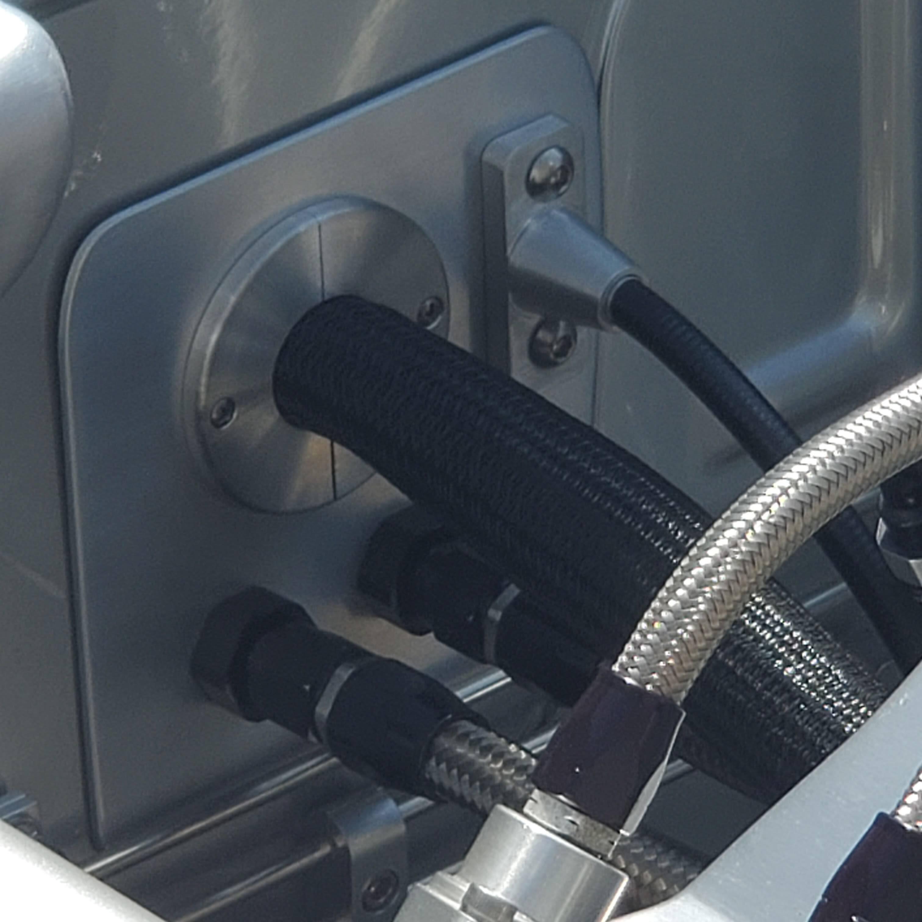

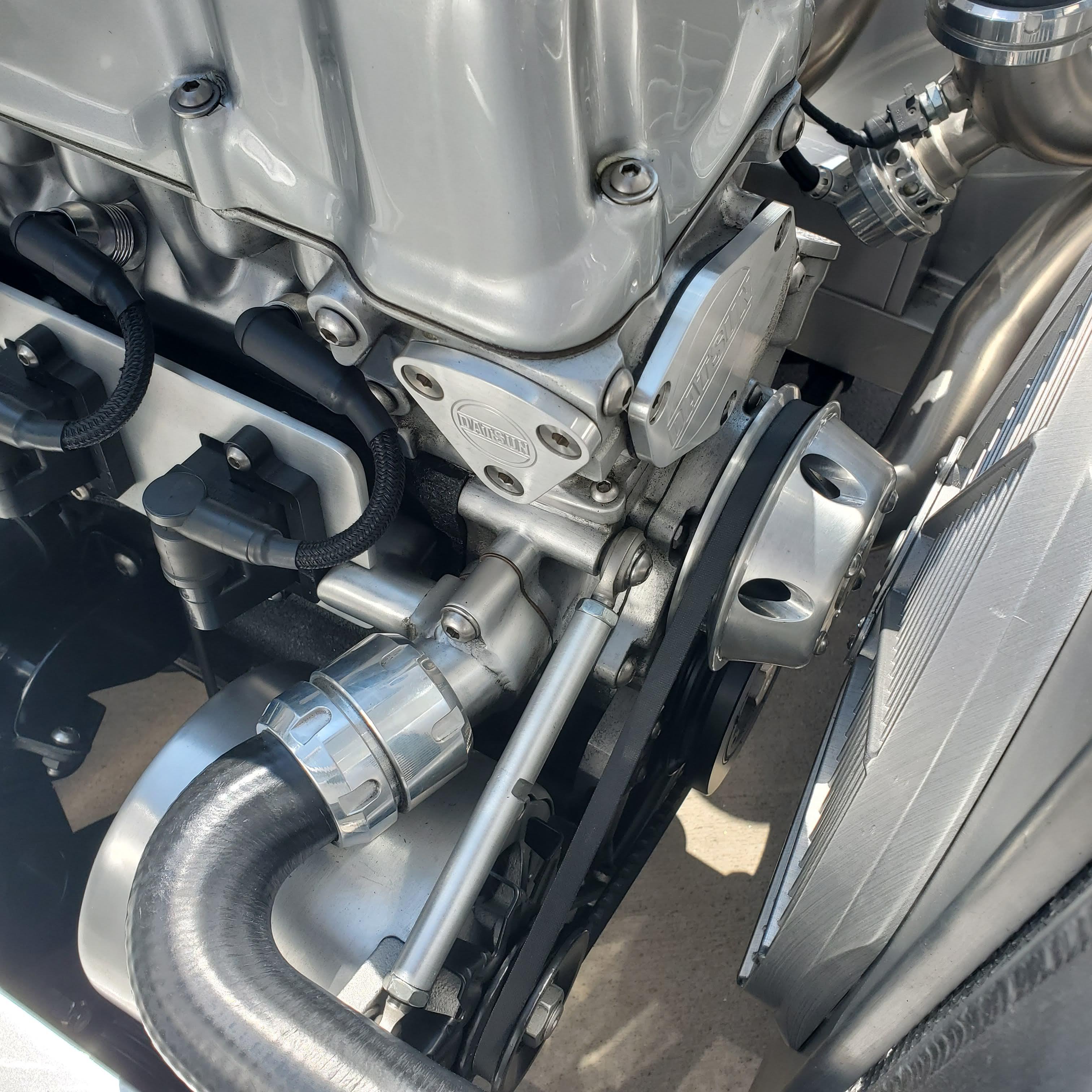

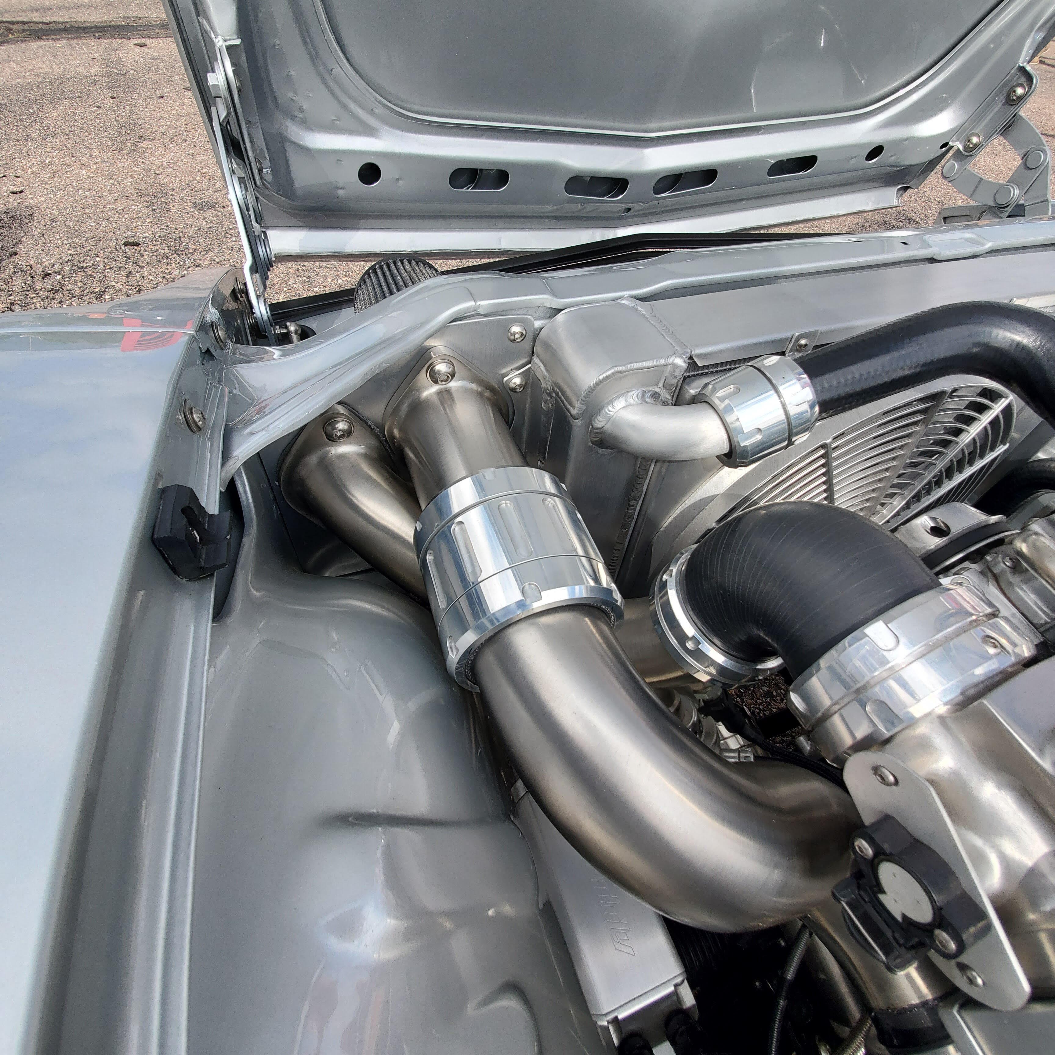

The heater supply hose was changed to a rigid pipe that was routed behind the coil mounting plate.  This required a custom fitting for the lower radiator hose:
With few exceptions, every hose/tube clamp used these fittings.  According to Robin, when they found them, the company was going out of business, so he bought all they had.  I plan to reach out to him to see if he'd temporarily part with one so I can utilize "prior art" to make some more.

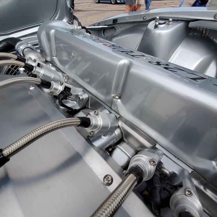

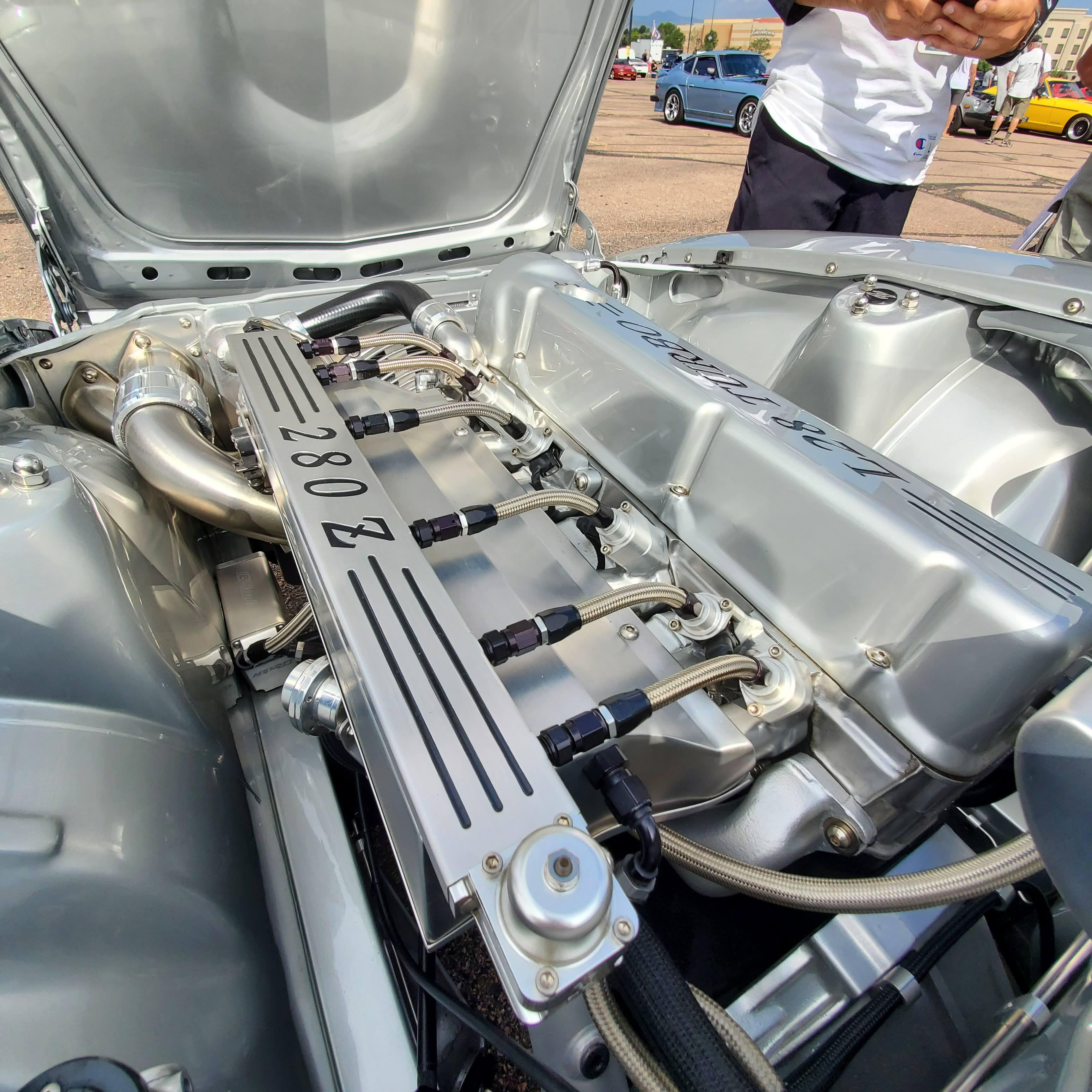

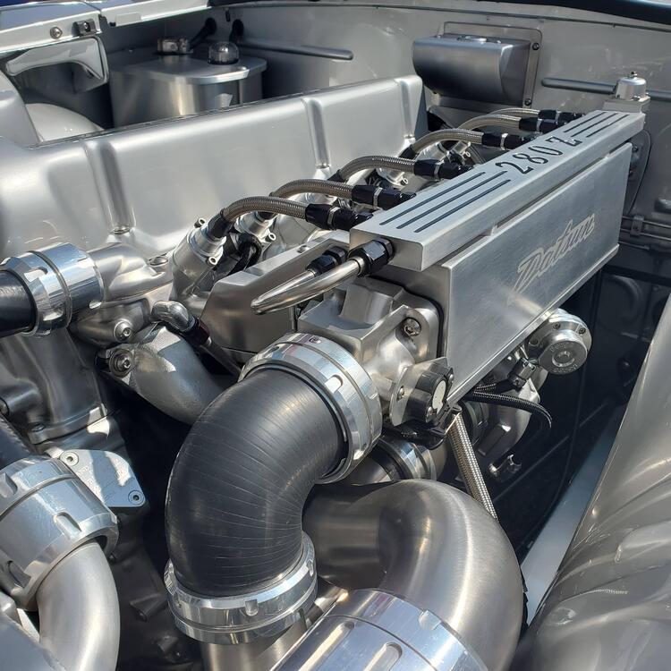

He wanted the fuel rail to run parallel with the valve cover, but the intake body runs at an angle to it which he thought detracted from his design intent.  So they made a cover for the entire intake to mask its "angle" then mounted the fuel rail on top of it.

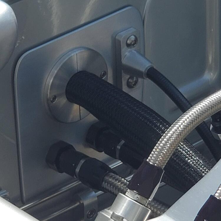

Note the battery cable treatment:

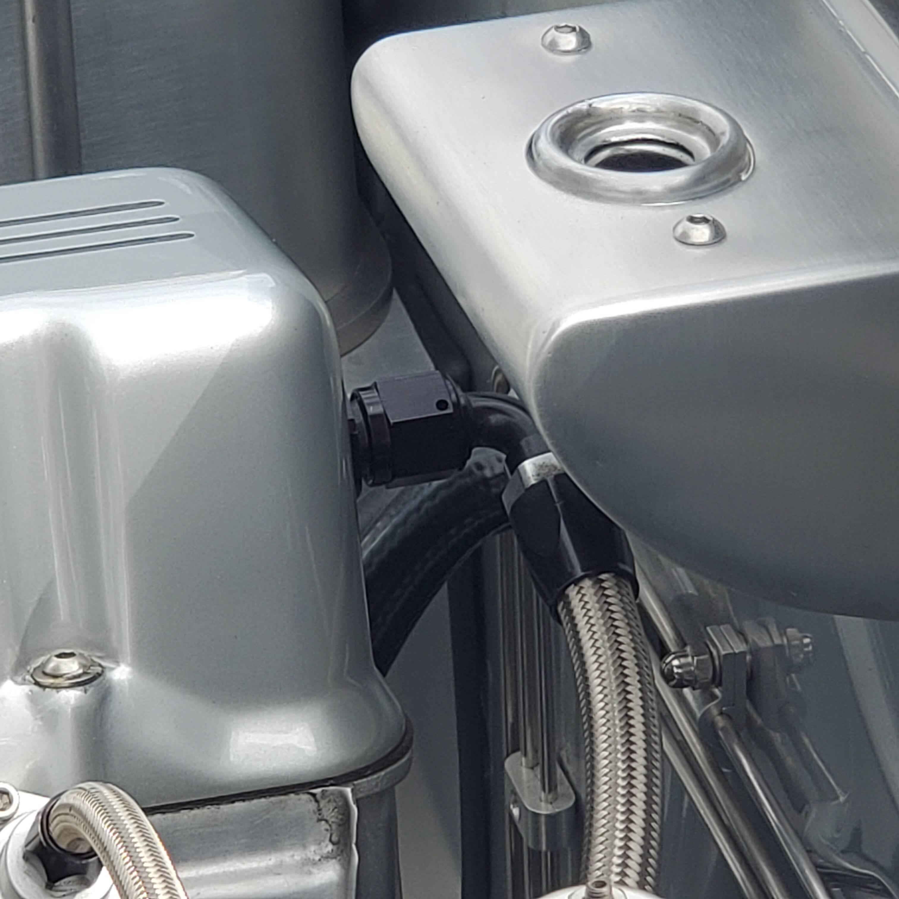

No one could recall if the new location for the valve cover vent hose was baffled internally as the work was completed about 10 years ago.  The consensus was that it was not - since there's no room for anything behind the last cam tower.  The hose runs to a catch can and there's no way to determine the can's fluid volume, so they just open a drain valve periodically.  The car is NOT a daily driver - big surprise there, right?
