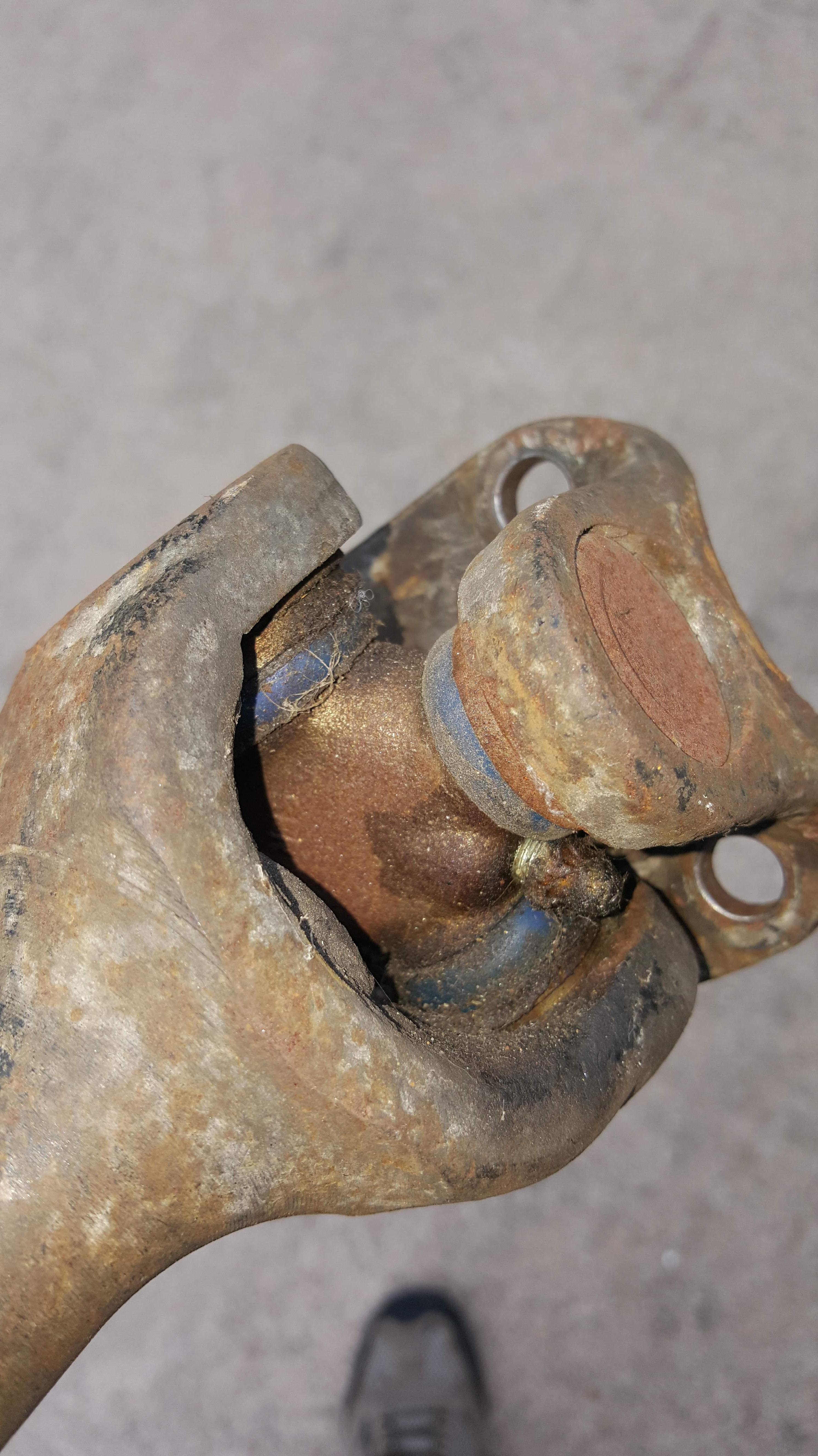

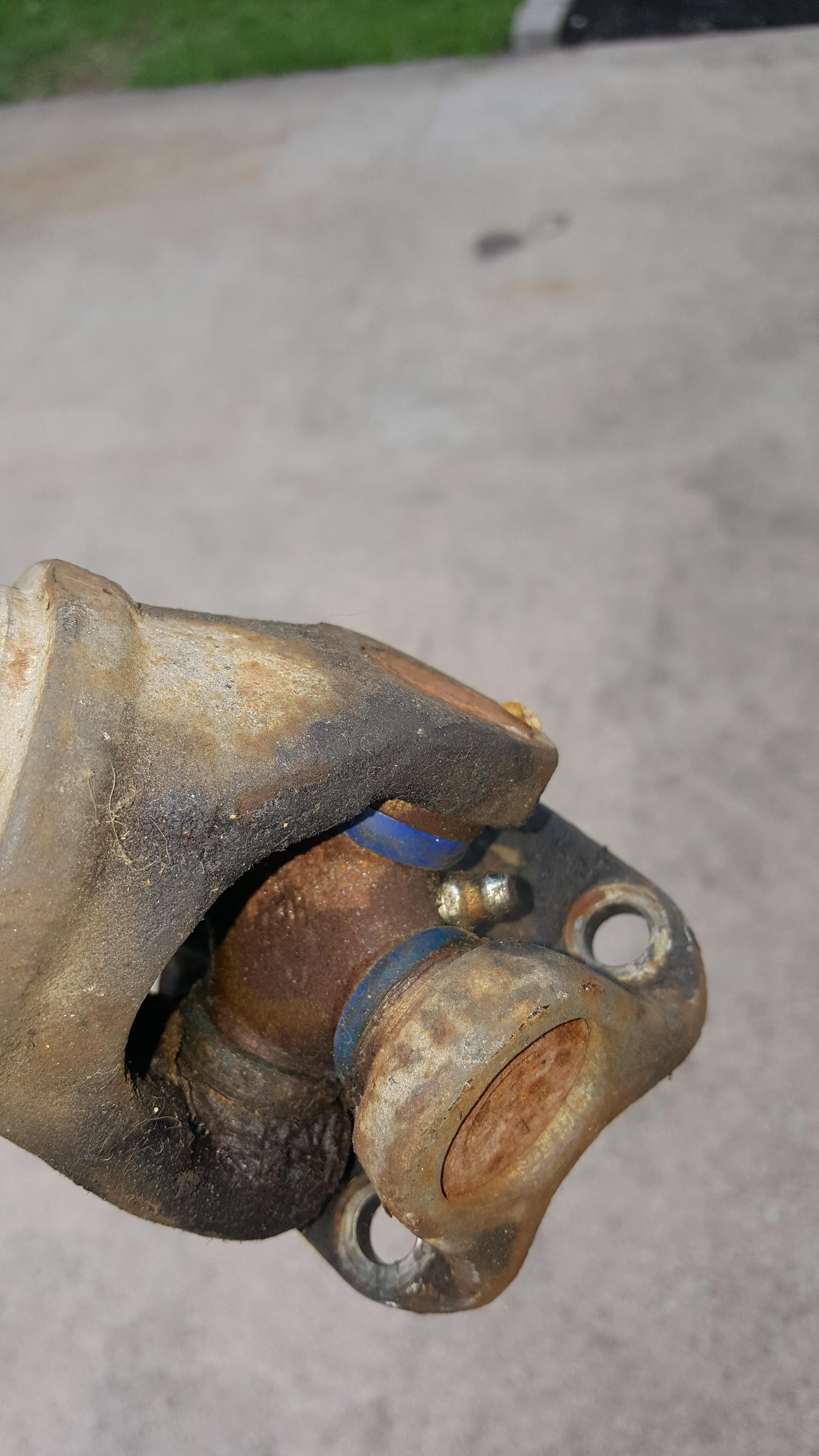

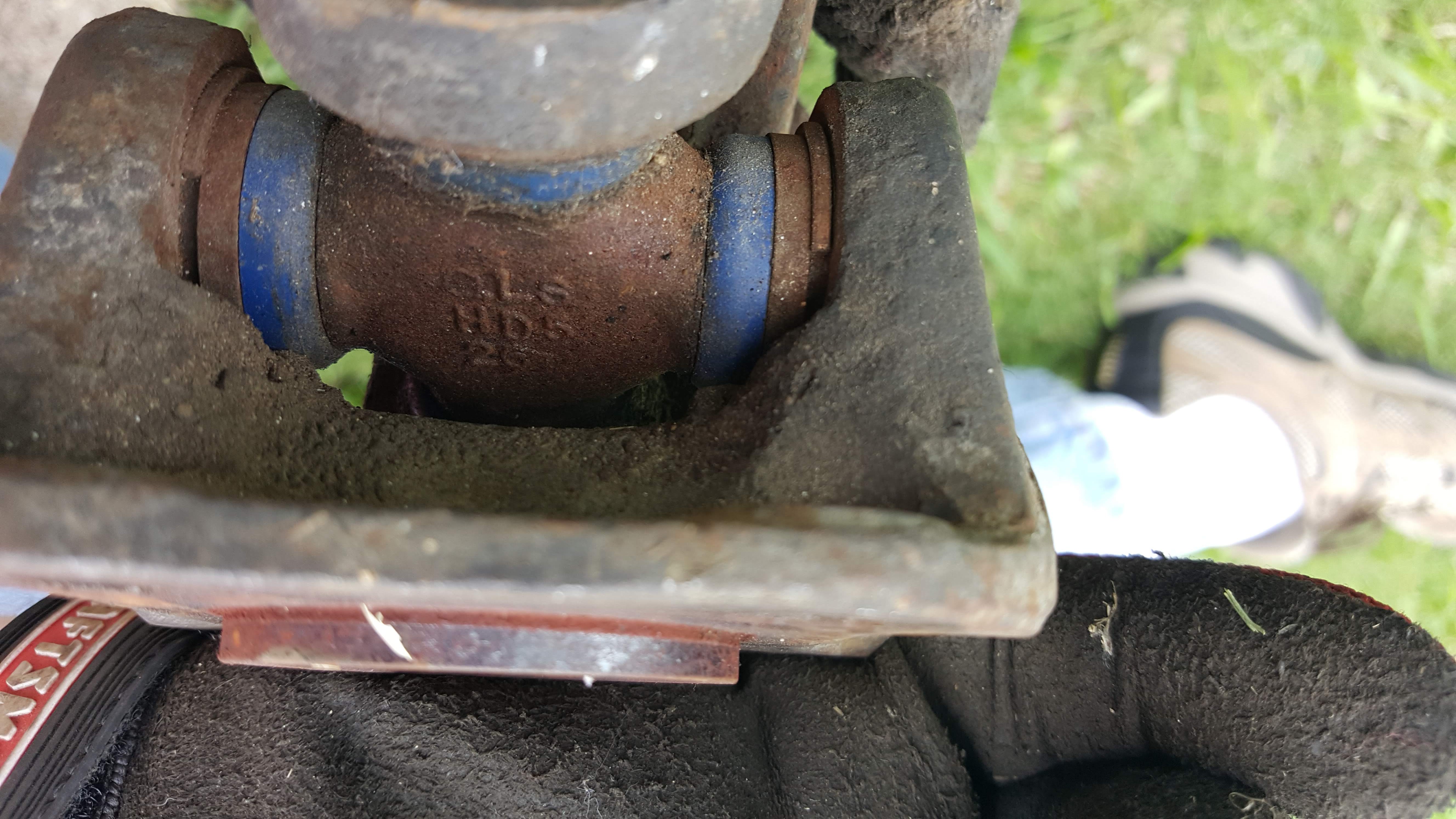

Several years ago I bought a pair of Spicer u-joints for one of my half shafts, I'm pretty sure I bought them from Black Dragon (may have even still been Victoria British at the time).  I now want to replace the ones on the other half shaft and the drive shaft.  Is Spicer still a great choice?  If so can someone help me determine which one to get (I cannot find any of my old paperwork to pull part numbers from).  On the ones I have I can see some blue on them if that helps identify what I have to match new ones to.

@240260280, I've found that as well as a 1310 series.  I'm having troubles 1) determining what I have as I'd like to match as closely as possible and 2) the difference between the two series (I cannot seem to locate info on the 1500 series you posted only the 1310) and finally 3) contact info for Spicer/Dana where I could call/chat/email them to get more info, all of their contact info pushes you to retailers.  That being said, I may just make a trip to the local auto parts store to see if they can help.
