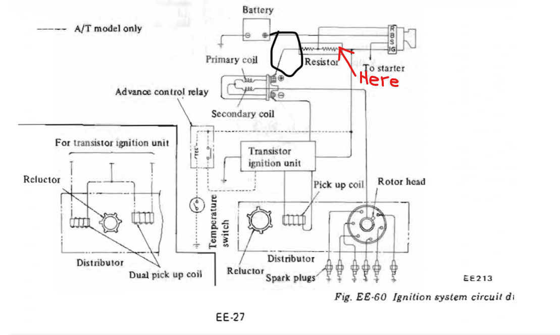

If you have a stock setup on your ignition, you are wiring it contrary to the instructions you posted.
So, here is how you should have the control box wired to the car according to the instructions:
  1. Black - Grounded
  2. Green - Nothing (assuming you don't have AC)
  3. Yellow - To the black/white wire at the ballast resistor
  4. Red - Battery
Note, if you have the red and yellow reversed, the car will probably die/not start because you are trying to draw too much current from the ignition circuit.
I don’t believe I have them reversed, I am positive the red and yellow are going to the right spot (it’s a lot more clear with newer wires haha). Regarding the black/white wire at the ballast resistor, i should hook it up after the resistor but before the coil right? I attached a picture of the wiring diagram and circled where I intend to wire it into.

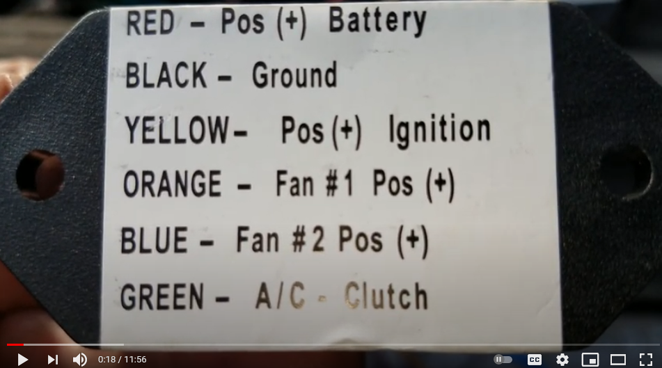

2 hours ago, Zed Head said:
Here are the super-simplified instructions.  There's a youtube link, if the embedded image doesn't show.
https://www.youtube.com/watch?v=Yr_8-AnEMRo
Got it, just watched this video, thank you so much
No, it goes to the black/white wire on the resistor.
Got it, I will take a look when I get into it tomorrow morning, hopefully it works. Unfortunately won’t be able to take it out until I get the mustang that’s blocking off the jack stands 😆. More motivation to get its transmission back in I guess
I did not watch the whole video so can't speak to its correctness.  I posted it for the label on the part, and maybe the video is right.  Good luck.
