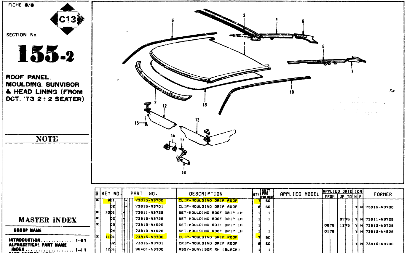

I stripped down another 78 280z a fews years ago in order to have it painted and there were clips on that car's trim.  When I look at the underside of the uninstalled trim piece that came with this car, I see several darker areas, about an 3/4" long, where the clips originaly sat on the trim.  When I try to install this trim over the drip rail, it's much too wide to hold in place, from one end to the other.  Perhaps the trim could be flattened a bit to help it pinch the drip rail and stay on, but I'm reluctant to do this and end up with a wavy and dented trim piece.  But if I can't source what I want, and as a last resort, this may be my only option.  I do have some time to  locat the clips due to the long list of other, under to hood items that need my attention.  Thanks for the replys but I'm still lookin'!
I know that the stainless steel roof trims (see image below) on late model coupes (01/76 on) are fitted with clips (see image below), certainly to part number 73812-N4425 and 73813-N4425, for example. In NOS examples, they are normally contained in a little bag (see image below) as part of the roof trim assembly itself, but not clipped into it (I say normally, as a couple I purchased didn't have them).
