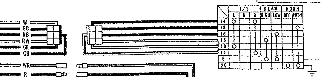

The dimmer switch just supplies a ground to the headlight circuit. Looking at those three wires (in your first picture above) that came loose out of the broken switch, the Black is the ground, The Red/White is the High Beam ground (I think) and the Red/Yellow is the Low Beam ground.  The switch just changes which wire gets connected to the Black ground wire.
To get by, you could just connect the black wire with the Red/Yellow (If that gives you high beams when you switch the lights on, I was wrong - so, just connect the Black to the Red/White instead). Then you'll have Low Beams for driving while you find a replacement for the broken switch.
The Ground is always connected to one or the other depending on the position of the switch so you don't need to worry about leaving the wires connected. Power to the headlights comes from the headlamp switch on the right of the steering column.

Sorry dylancorrea, I was right with my first picture but got distracted by the parts you were holding in your hand.  My mistake.  I had you on a wild goose chase.
cgsheen1 is right.  Here is that first drawing that I should have left in.  Run a switch to ground for the Red with Black stripe (RB) and you have low beam.  Do the same for Red with White stripe (RW) and you have high beam.  "E" is ground.
The colors I'm talking about are from the main harness.  Always good to use the diagram, because Nissan used different colors on the sub-harnesses.
cgsheen1 is right.  Here is that first drawing that I should have left in.  Run a switch to ground for the Red with Black stripe and you have low beam.  Do the same for Red with White stripe and you have high beam.  "E" is ground.

Thank you, I will do this tomorrow my car is pretty close to being on the road, I just need to fine tune things like this, I appreciate the help from both of you.
I should add that if you're trying to figure out the wiring diagrams and thinking "man, this is really difficult" you're not alone.  My eyeballs started getting sore trying to follow the various traces around the page, and jumping across the connection points.  But if you take the time and put the effort in you'll find that it gets easier and you can solve a lot of your problems just by studying the drawings.  For what it's worth.
