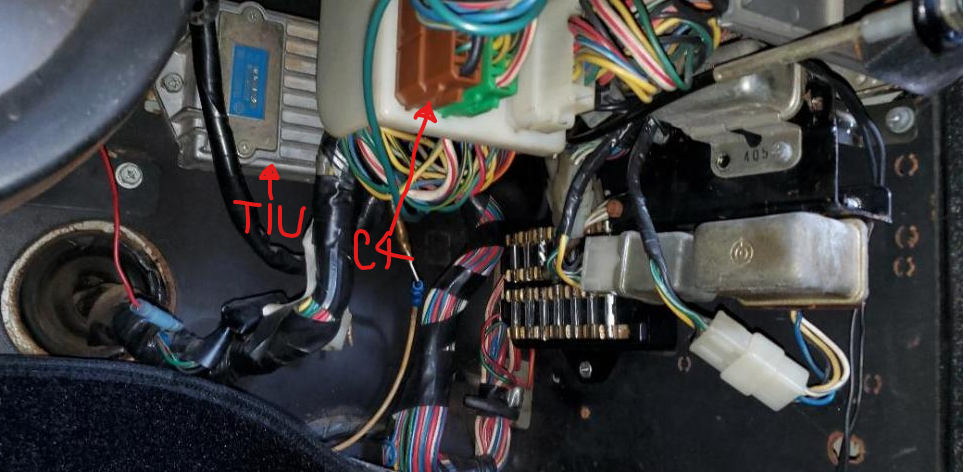

I marked the TIU. Make sure it is unplugged.
The resistor is wrapped in tape. It should be on a blue wire on the engine harness side of the C4 connector. Depending upon how the MSD ignition was wired into the car, that could be affecting your tach signal, too.
