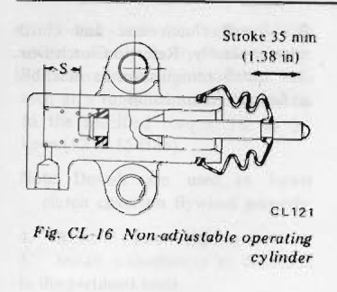

We've posted about the correct distance from the slave cylinder bolt head to the fork.  You might measure that at rest.  That will tell you something about the TOB collar/sleeve inside.  If it's too short the distance will be too long.
It doesn't look like the fork is hitting the back of the hole.  That's what usually happens with the wrong TOB sleeve/collar.  Yous still looks like it's back farther than normal, but there might enough room to make it work even though it's wrong.
The FSM shows the slave cylinder travel number.  You could measure that to see if you're getting full travel.  People have made their own slave cylinder rods to get more reach to the fork.  But it might also be that the rod at the master cylinder is the one that needs to be extended.  You said that you adjusted the pedal, but not the rod from the pedal to the MC piston.  You can do that by loosening the lock nut and turning the rod with a pair of pliers, while everything is assembled. Take the return spring off of the pedal and extend the rod until the play is removed, but leave a small amount, the put the return spring back on. It's cramped under there but it's doable.
It does look you should get more travel in your video, which might let you get by with the wrong parts for a while.
