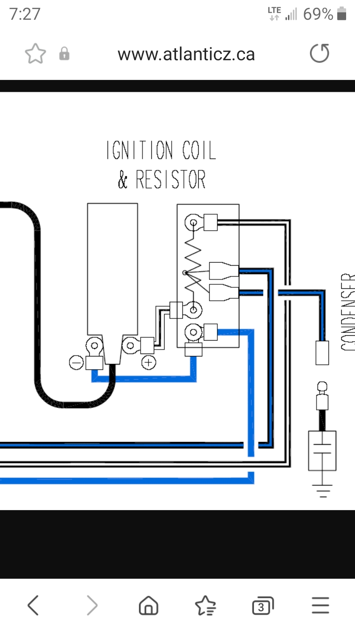

Shawninvancouver Posted June 10, 2021 Author Share #73 Posted June 10, 2021 (edited) hooked up as per fsm.. does it look correct to you?? blue to neg on coil and wb to pos.. Edited June 10, 2021 by Shawninvancouver Link to comment https://www.classiczcars.com/topic/65481-74-260z-distributor-on-wrong/?page=7#findComment-623183 Share on other sites More sharing options...

Shawninvancouver Posted June 10, 2021 Author Share #77 Posted June 10, 2021 (edited) here is a shot from the 260 fsm shown here.. i think i have mine hooked up like this.. also.. the wire with power was the black white hooked up to left of ballast closest to front of car -- Edited June 10, 2021 by Shawninvancouver 1 Link to comment https://www.classiczcars.com/topic/65481-74-260z-distributor-on-wrong/?page=7#findComment-623187 Share on other sites More sharing options...
Zed Head Posted June 10, 2021 Share #78 Posted June 10, 2021 The ballast is still broken if all three terminals don't have power. The way it's wired won't affect what you showed with your test light. Link to comment https://www.classiczcars.com/topic/65481-74-260z-distributor-on-wrong/?page=7#findComment-623190 Share on other sites More sharing options...
