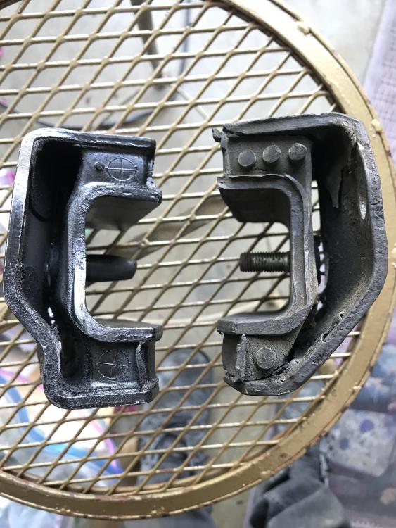

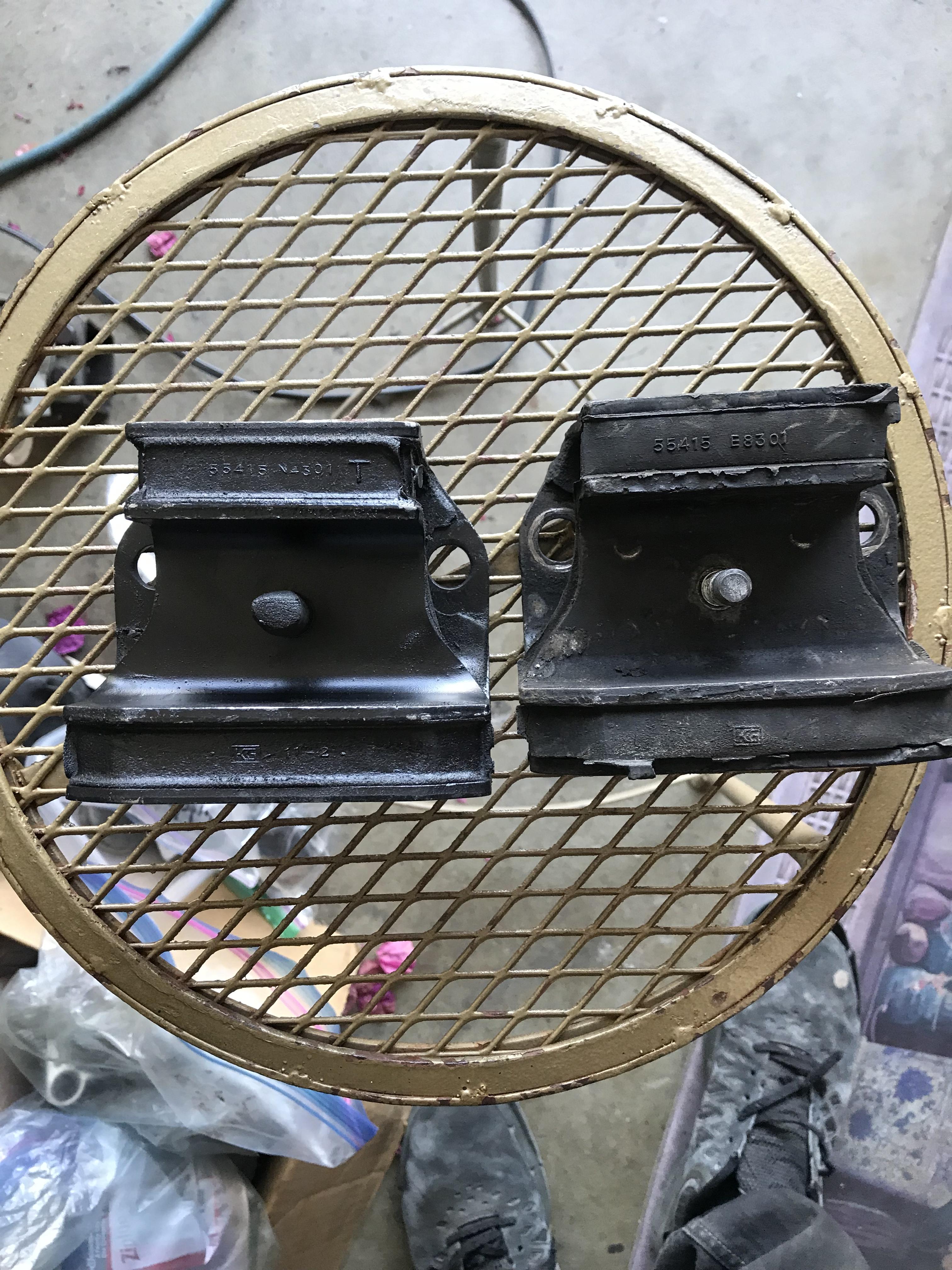

7 hours ago, Racer X said:
Here is how I check the diff nose mount. Stick the pry bar in, push up on the handle. If the mount is torn, you’ll see it separate.
Mine was broken (the rubber) and as a cheap repair i once welded a u type of metal under it with a fat piece of rubber in between... HAHAHA after 10 years it's still on there !!!  😂
