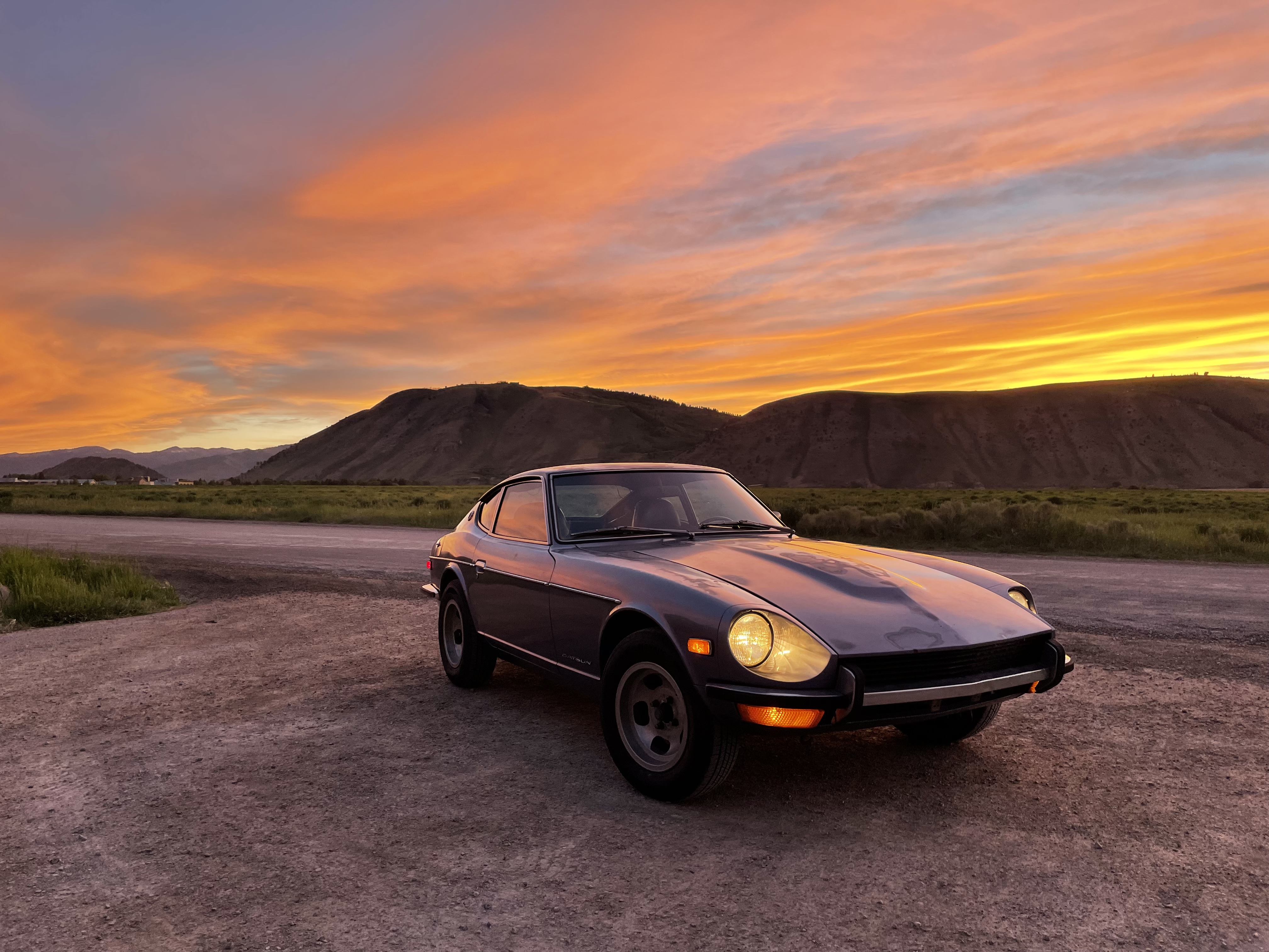

I’ve been thinking about doing some body work (small rust spots mainly) and getting an exterior respray (?) or quick paint job, something that hopefully matches the under hood factory color. The car is 90% original from Southern California and the clear coat has definitely disappeared in some places. Would this hinder the opportunity to sell my Z as a “survivor” later down the road?
Pic for reference
I think it's original.

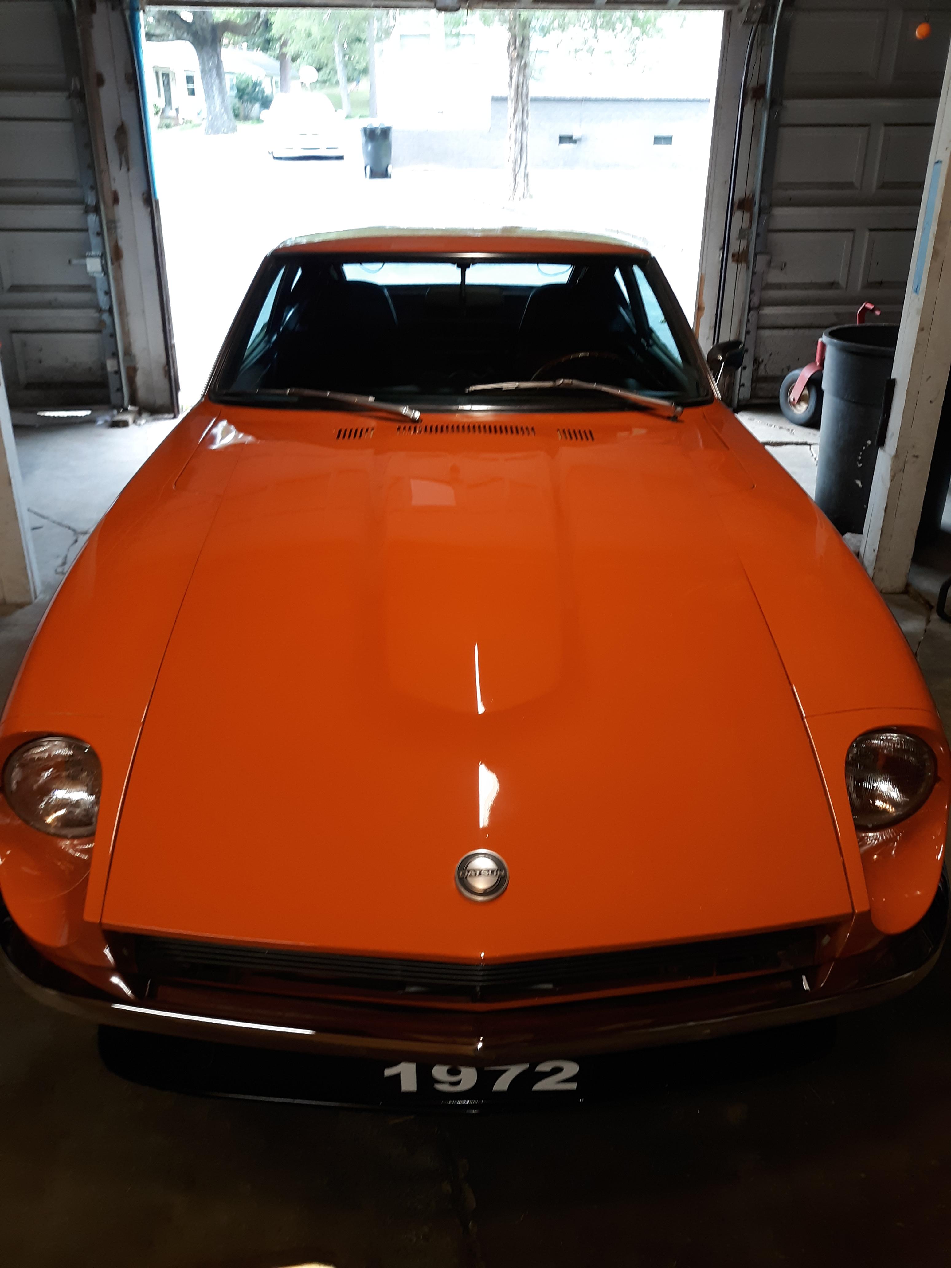

Went down and took a few pics for you to compare your's too. Hope it helps determine if it's  OE paint?
Looks like that! I have much to learn! Every car I’ve owned before this has had clear coat so I just thought that was the norm. I was my fathers car in the 70’s and he never painted it, then it sat in the sun for a very long time.

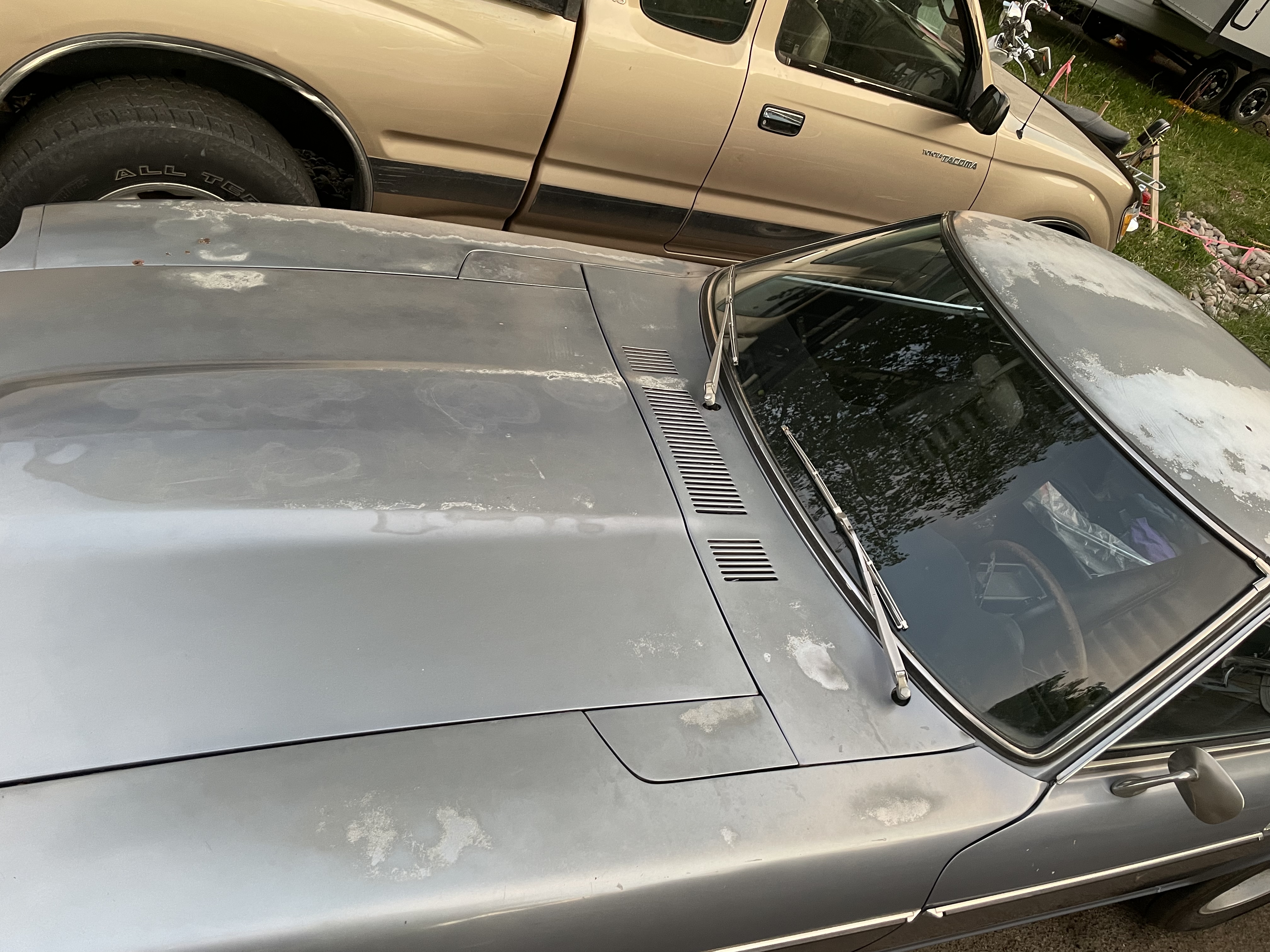

Looks it's down to the primer like my 280. You can wax it up and live with it or get it painted. $5,000 for a good paint job around here. There's the "shake and bake" Maaco painters.
https://www.maaco.com/
Thanks for all your insight, I really appreciate it! Probably just gonna rock it! Doesn’t look half bad in pics from 30 feet 😂

I didn't read all of this thread completely but there's a lot of misinformation here. Any S30 that had Metallic paint WAS TWO STAGE from the factory. Solid colors (nonmetallic) were single stage enamel.
If (where) your CLEARCOAT is gone or peeling off you will NOT get good results trying to buff it! You can't buff basecoat and get a good result. You need to either leave your paint as is or have the car repainted - especially since you're dealing with silver.
