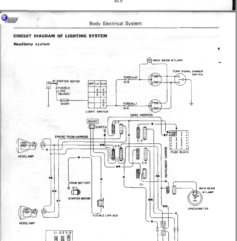

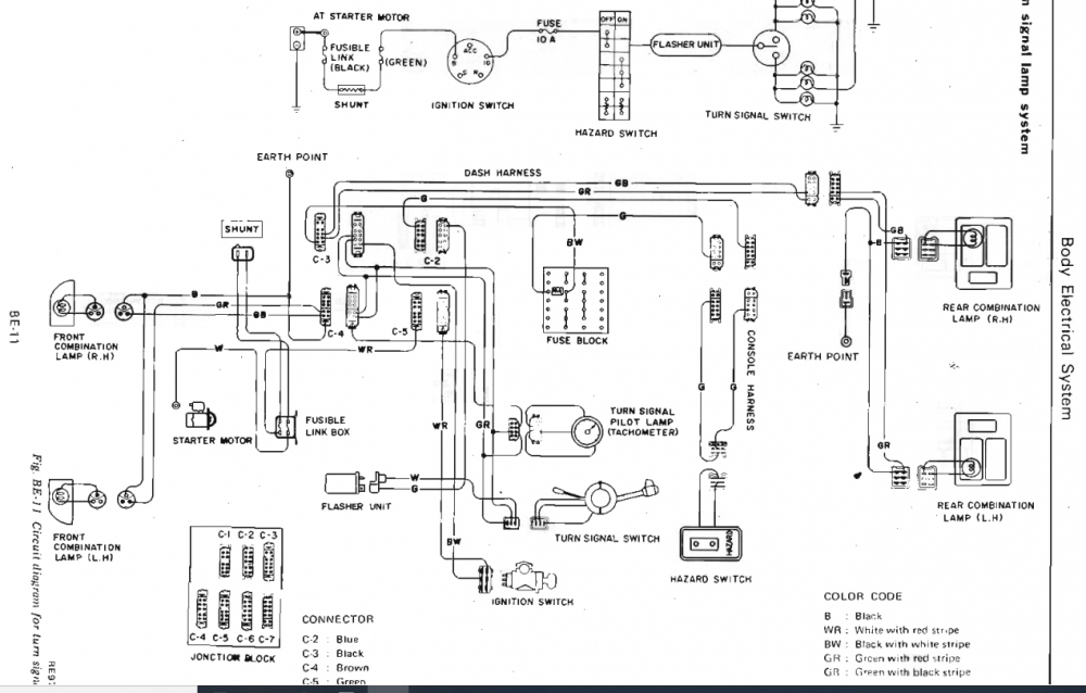

Somebody has been hacking around in there.  No easy solutions.  Find a friend who knows electrical and get those wiring diagrams ready.  The Body Electrical chapter has good ones.
16 minutes ago, Shawninvancouver said:
does that relay look like something??
It's a flasher.  I'm going to guess that somebody tired tried to bypass the Hazard switch.  @SteveJ
