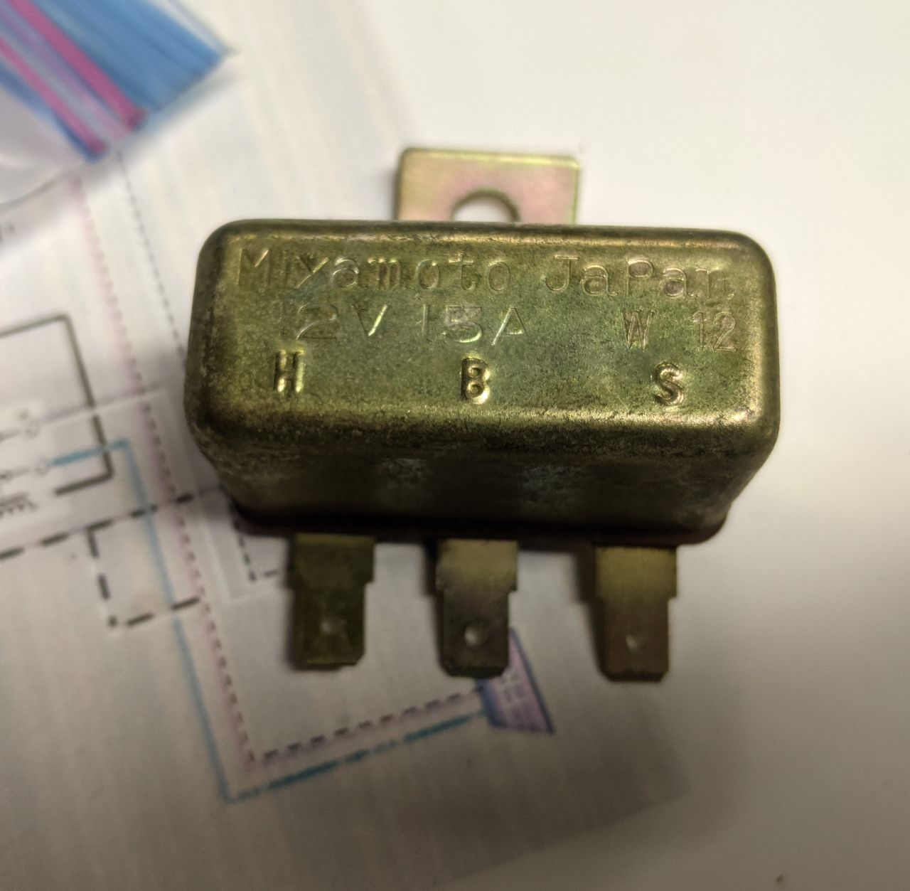

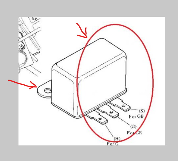

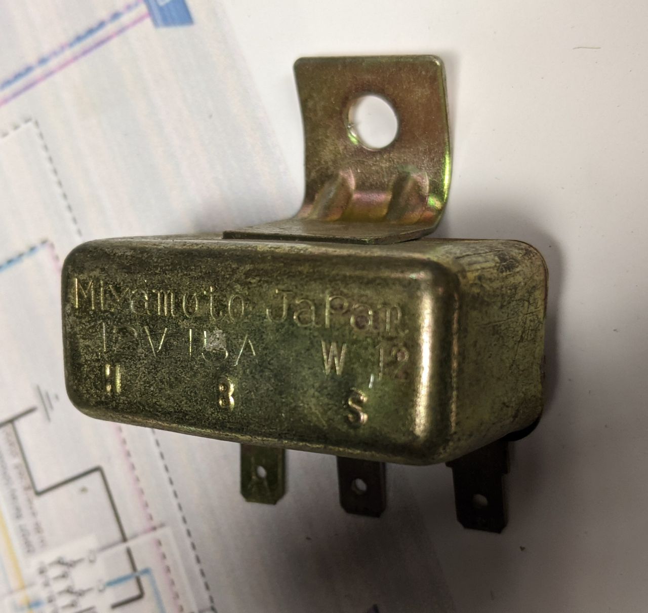

ZH, correct me if I'm wrong, but I think the relay panel can be unbolted. This might make it easier to get to the relay.
Remember these relays are old so they can wear out. Once you figure out the terminals, (i.e. which one does what) you can substitute a modern relay.
It might, I'm not sure.  I'd use a short Phillips head and see if could get the screws out.  Or a long one, sometimes a long blade will reach through the morass and get to the screw heads.  Looks like two and it should fall right out.
Ok.  I will try to get it out. But here is my main question.  With power on car on - when I touch the green wire coming from horn with tester it lights up. When I press the horn button the light goes out. Is that correct ??
