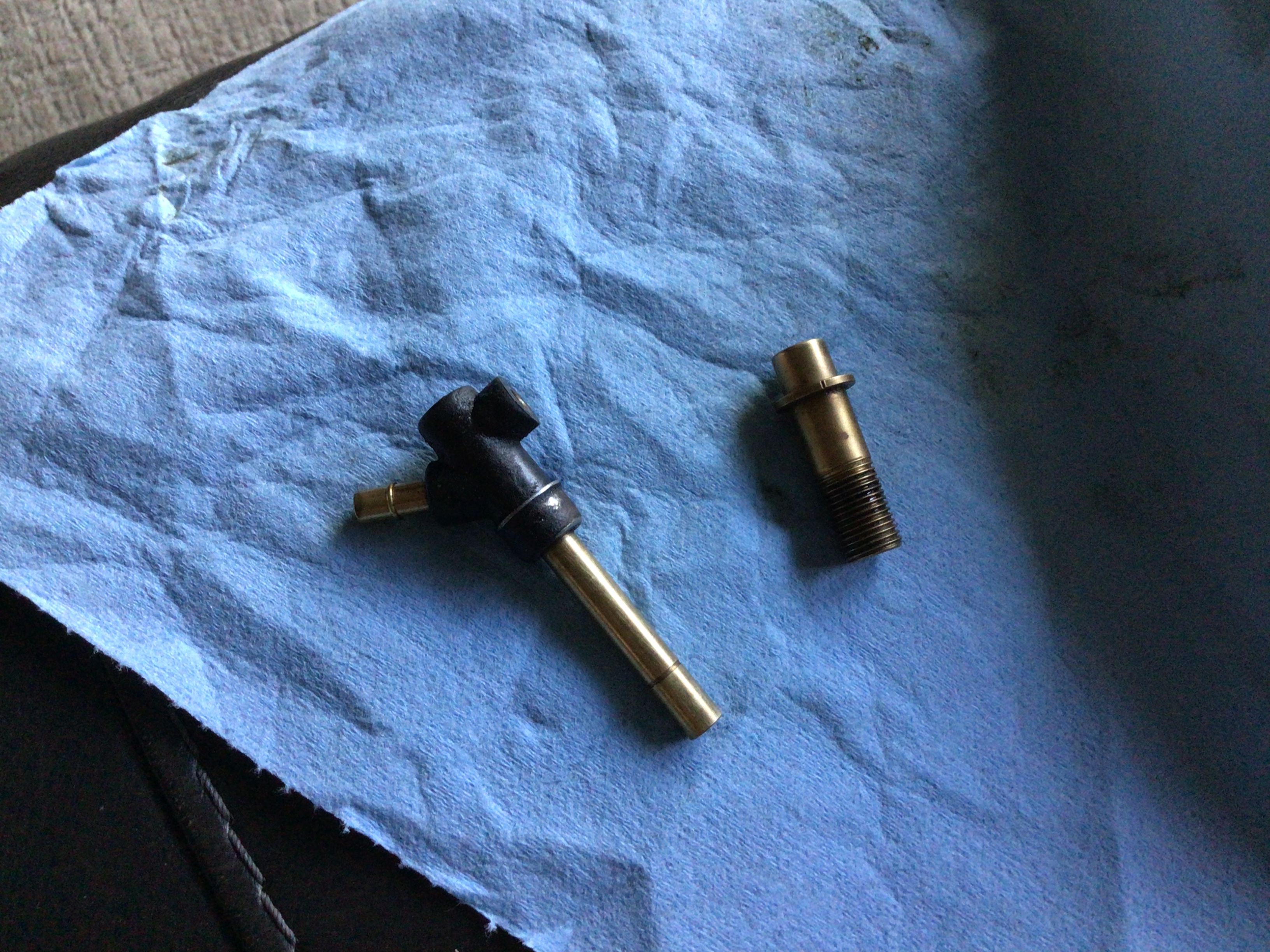

Well as I’ve come to discover there is another nasty vacuum leak area of concern on SU’s that I think is JUST as prevalent as shaft wear. The nozzle fit in its sleeve is often very worn.
