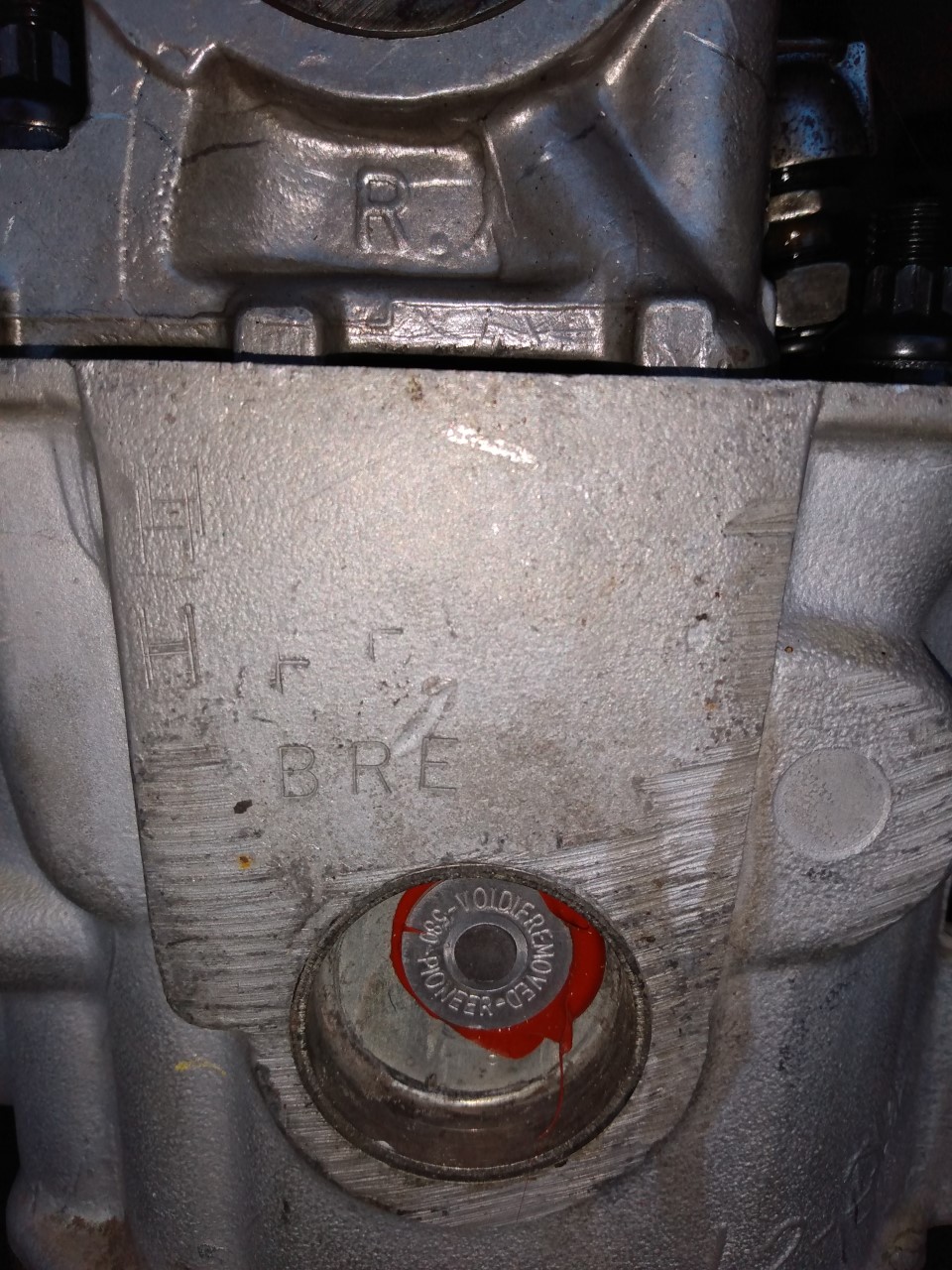

A friend and I have been inventorying the loose parts of his '77 280z prior to paint and reassembly.   He has an N42 engine he says is from an '80ZX.
The head has the letters "BRE" stamped on the back of it. I have the original N47/N42 I pulled from my '80ZX years ago, and found no such markings.
Any idea what it means?
I see no obvious evidence of porting, and it was said to only be checked for straightness by a local machine shop(Don't know if its been shaved). The block does have Nissan flat top pistons. I don't know if it's been bored out at all, it's currently assembled.  He says it's a .480 lift cam.

The thing glued on with the red goop looks like a heat indicator used for rebuilt parts, to show that they've been overheated.
BRE?  Maybe Brock had a head ready for a race car and somebody ended up with it.
https://bre2.net/the-racing/datsun/
I would doubt that BRE on that block would have anything to do with Brock Racing Enterprises. Pete disbanded BRE in 72 when he decided to get into hang gliding. The N42 block came out in the 280Z.
However, to cover my bases, I did send the picture to Randy Jaffe. Considering how much of a BRE fanatic he is, he may be able to shed some light onto that.
The little disc glued to the core plug on the head was placed there by Pioneer Engine Rebuilders. Like Zed says, it has a thermal indicator, to show if the head has, or has not, been subjected to overheating.
It also gives a clue about the history of the head, and possibly the engine.

I have an E88 with "Birmingham Cylinder Head" on those. Seems like there's one on each end? From what I've been told it's the glue? that holds them on that gets too hot and releases the button/disc. That voids their warranty if one is missing.
  • Thanks 1
