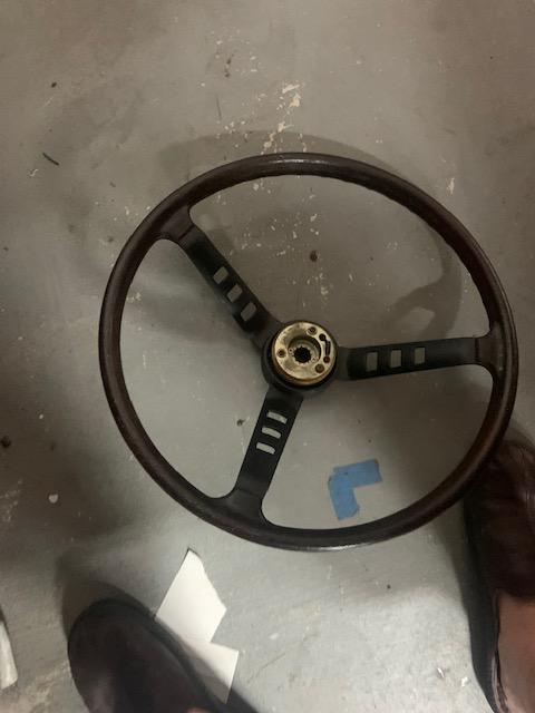

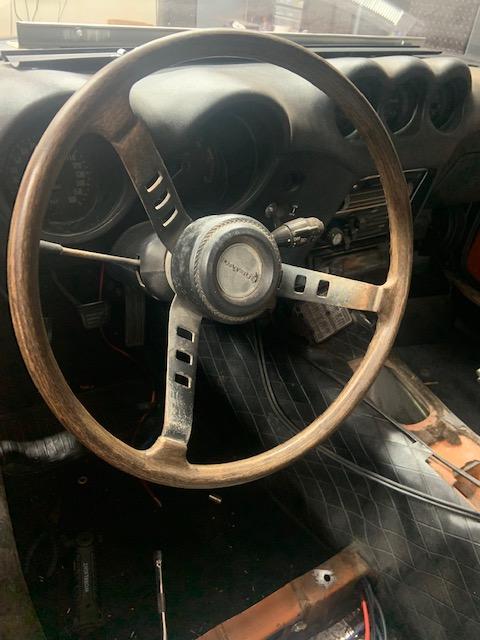

I have 2 steering wheels. I would like to get at least one refreshed like new. I dont think i have the skills to do that and make it look 100%. Any suggestions on who could do this? LIke should i call local carpenters?

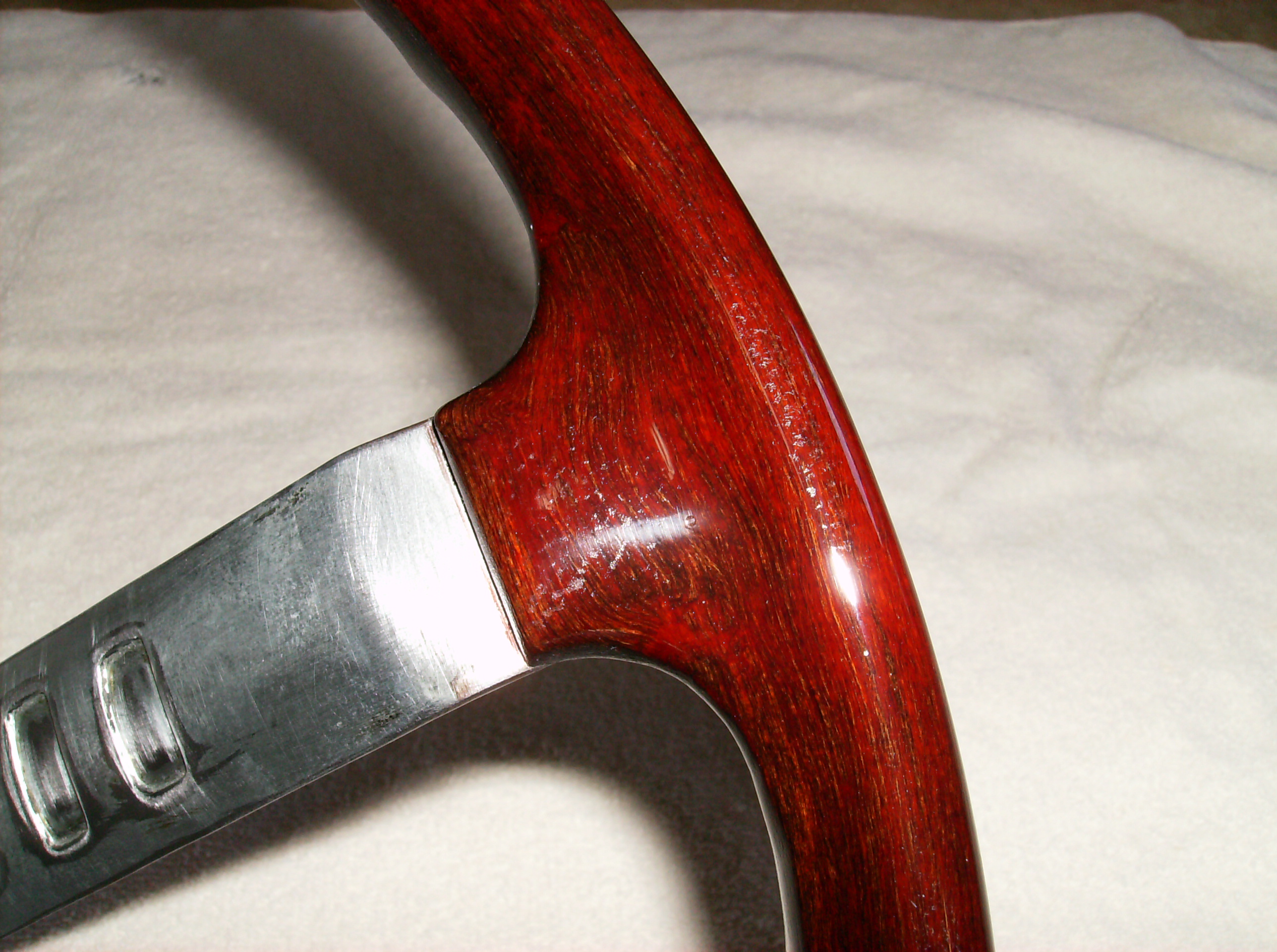

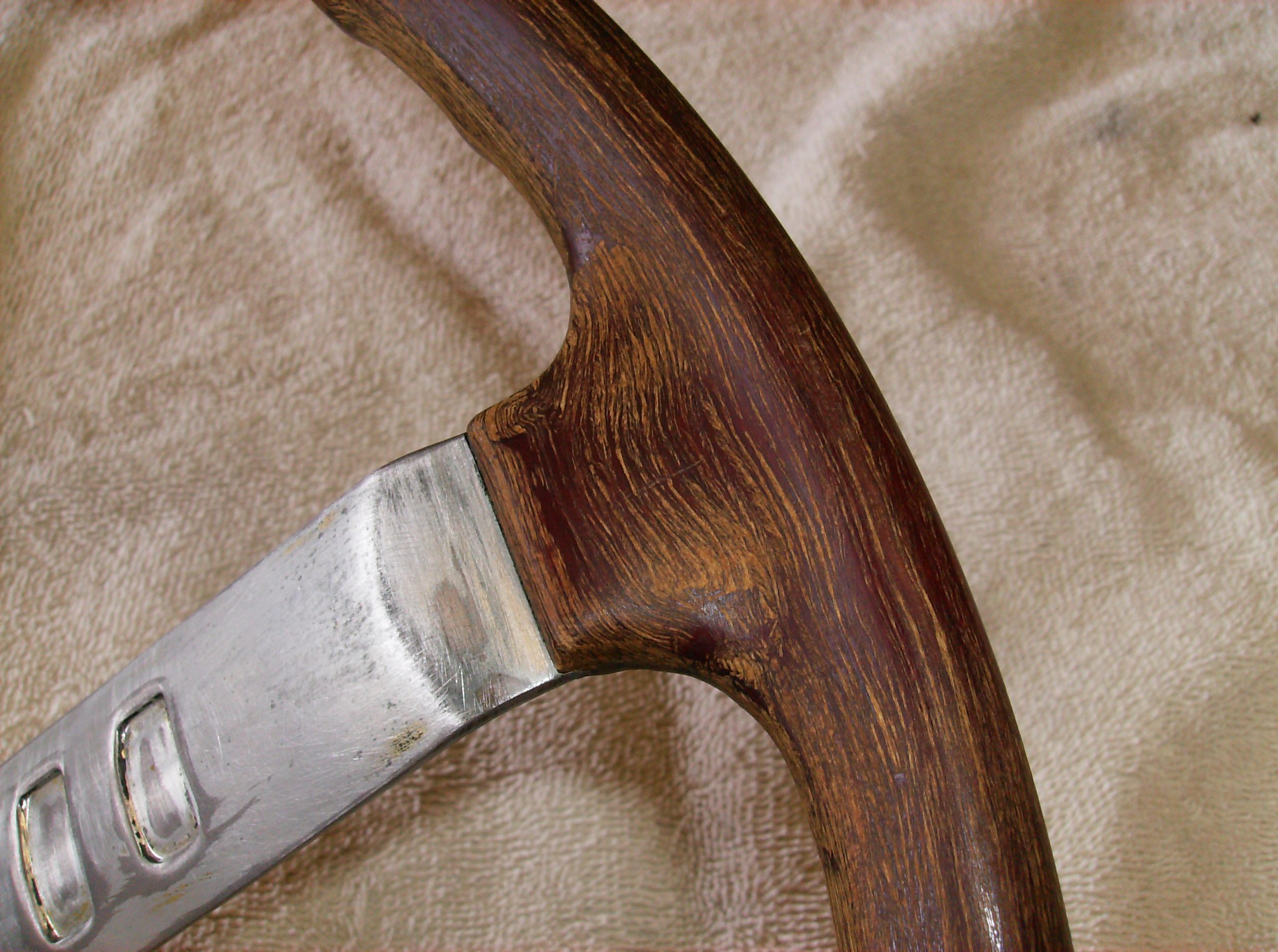

The wheel rim is a type of resin that has wood fibers impregnated. A good way to clean it is a soapy solution in the kitchen sink and VERY GENTLY rub it down with a fine steel wool. You don't want to damage or remove the wood fibers. Strip the spokes and hub to bare metal and finish out as @Patcon mentioned.
