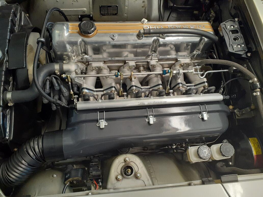

Hi All,
Close to turning the key on the Haltech ECU / EFI conversion. I decided to move the inlet fuel filter to the engine bay. See pic. Felt it was easier to service.

Hi All,
240z Wiring harness , L28
The EFI set-up is complete. Worked with Haltech remotely engine is running but chasing down a vacuum leak. Also having a weird issue with the electronic distributor connection to the ECU. Losing the signal grounds randomly.
Question. Need to add a grounding strap from the chassis to engine block. Why, attempting to move my star ground (all required ECU ground connections) to another point (currently chassis).  Where is the best connection point? The engine bay harness is a stock 73 240Z. Is the chassis ground under the battery box off the harness a good point for a chassis to engine block strap? The FSM manual will not help with this issue, adding ground connections.
Also running a single coil with igniter (no problems), all the stock 240z distributor coil, distributor, resistor wires have been terminated and secured. Harness is still intact on left front fender. Is there a usable ground wire in from the old harness for a chassis ground?

Ordinarily if you're adding a ground strap it would be from the block to the firewall - normally from the starter or transmission bolt to a bolt location nearby on the firewall. I've never found that necessary on a Z car but it certainly can't hurt especially if you're unsure if the stock wiring is "still stock".
The intake manifold is generally where you ground all your EFI equipment. EFI grounding can be very specific, and you need to avoid ground loops. Most standalones require all signal grounds to a single point (usually on the ECU itself OR prescribed in the documentation to a specific location) and the other ECU grounds all tied to one spot - either directly to the BAT or block (intake manifold IS same as block (and normally the main battery ground goes directly to the block at the starter...)).
The engine is a very "noisy" environment - electrically speaking. Some equipment needs to be wired using shielded cable and the shield needs to be grounded only on one if it's ends to eliminate as much noise as possible for the sensors to report properly. This all should have been in the Haltech wiring information.
We installed ITB's on the Swiss 240Z and Tony at UMS here in Phoenix installed and tuned an AEM infinity ECU. It made decent power for a mostly stock engine (mild cam) -  180 RWHP.
Edited by cgsheen1
Thanks for the response and info.
Moved the star ground from the chassis to the head and the issue with the hall effect signals gone. Haltech signal grounds are all connected to the main battery ground, correct the trigger and sync are shielded cables (2). Haltech suggested adding grounds to reduce the noise on the block.
ITB's, coil and hall effect distributor are AUS based products. Straight forward install the hurdles have been ECU functions. All good now, starts, idles, all outputs on the CAN look good. Working through transient throttle tuning or additional vacuum sync on the ITB's, she's coughing (no backfire) though the ITB's when stabbing the pedal.
Encouraged by your HP gains. I'll enjoy the stock L28 this year. Pull the engine end of year to stroke and head work (N42 head). Wanted to understand the ECU / EFI conversion before the rebuild and reinstall.
Enjoy the drive.
