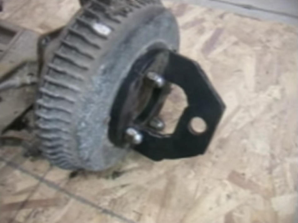

I love making tools and jigs.  My latest was a modification to the spindle pin puller I made.  Since I already had the puller, I made another sleeve and turned it into a rear outer bushing puller.  It made removing the OE bushings almost easy.
