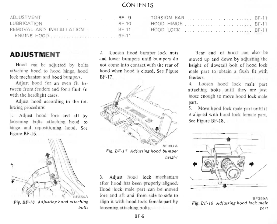

There is adjustment in this part - it can be screwed farther in or out so it properly mates with the depth of the hood latching mechanism below. You should also check the latching plate for wear. If it's worn to a bevel underneath, it may be unable to hold this part securely in place.
Thank you so much. I am going to look  at the latching plate for wear. I think that is what it is, but it also seems to be only slightly protruding as if it doesn't get a good grip on the male portion. The spring works, but I wonder if it doesn't have enough tension. I'll be back on later this evening. Thanks.
