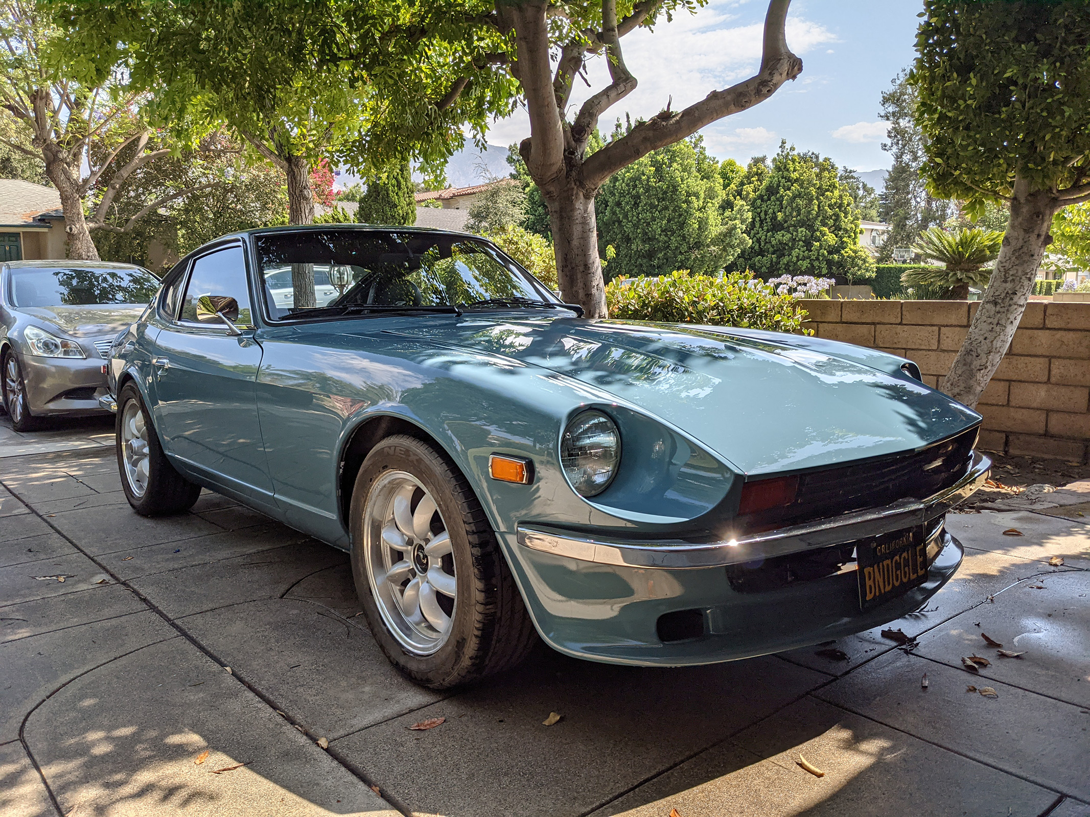

Exactly what I did on my car. I really like the look and have (somewhat surprisingly) only seen a couple other cars where it's been done. Probably not great for the value of the car since it's not original, but my guess is Nissan would have made them this way if they could have.
Hardest part of the job is not banging the fender into something when moving it around in the garage...the headlight bucket adds a surprising amount of length!
Some photos in my build log starting here:

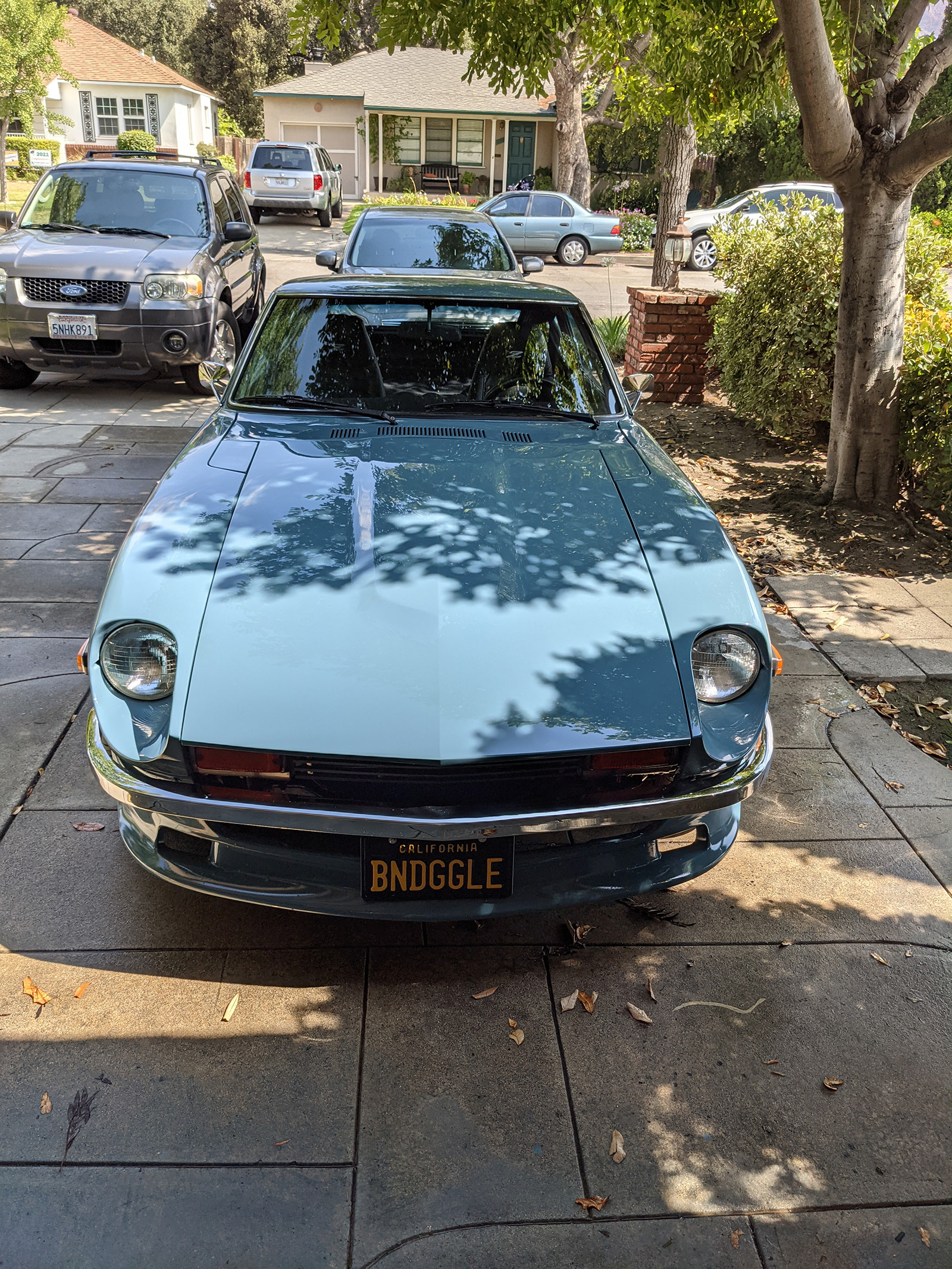

And two pictures I took today after finishing the repairs from a fender bender last summer:
  • Like 4
Nope, no issues with warping that I could see, and I'm a very inexperienced welder. Did just what you said: a bunch of tack welds, grinder, filler.
Nothing I would do differently, other than maybe a bit of extra metal work to cut down on the amount of filler that I used. That could be said about the whole car, though 😉
