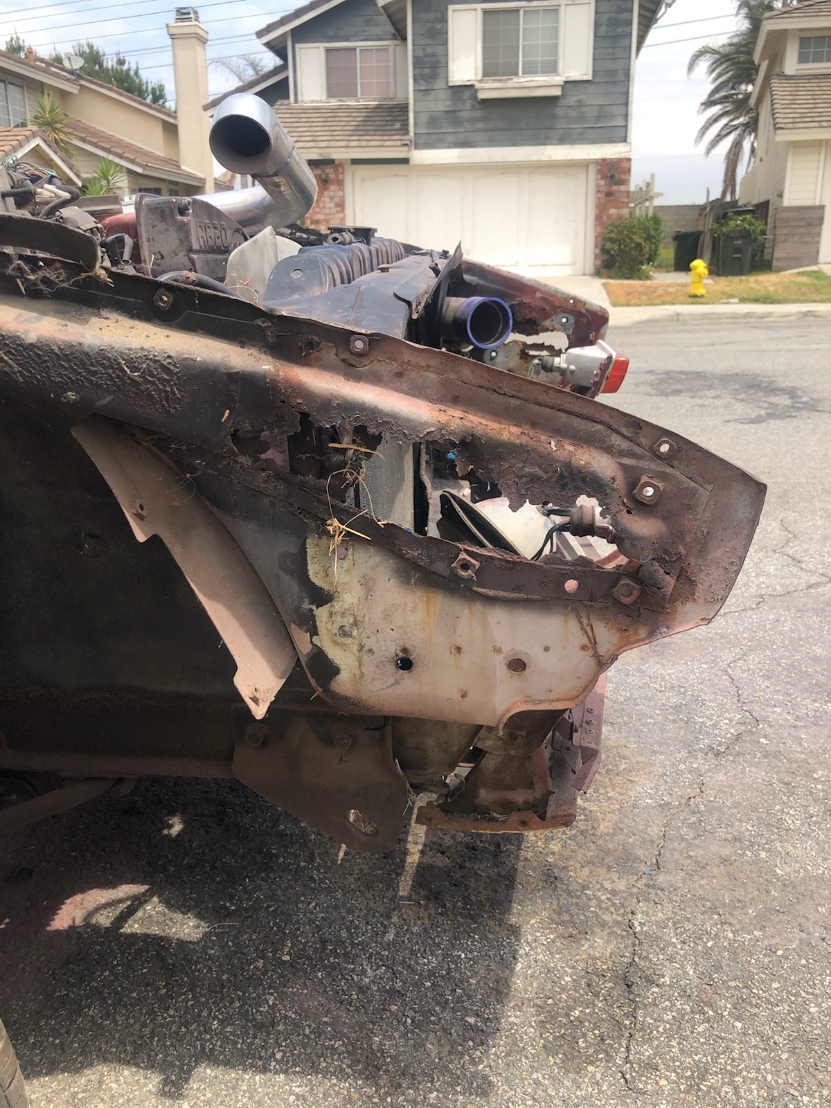

14 hours ago, Hallow_Z said:
Door hood hinge area
Looking a replacement for both driver side and passenger side for the metal area of where the hood hinge goes.

The only source that I know of for ready-made sheet metal for this area is UK-based Automotive Panel Solutions (no website, but can be found on Facebook).  The proprietor does beautiful work but -- as noted above -- it ain't cheap.  A third solution will be to find a donor car, cut out the required sections, and then graft them into your car.
I can't see the rest of your car from the photo you've offered.  However, if this level of rust is typical of the entire vehicle, you may want to consider acquiring a better vehicle to start your project with.
Yes!  Agree, i have had a car here in the Netherlands that had that.. and it was not salvagable/beyond repair..  BUT.. it made a great parts car!  It was a euro version and lots of parts were very good..
I never seen a californian car that bad.. may be because it was not there all it's life.,. (for sure..)
Well I don't plan on getting a different vehicle. I actually think the one I have is not bad. Every rusted area that is currently semi-rusted or completely rusted I have bought the replacement for... L+R Inner/outer rocker panels,  L+R lower door panel, L+R rocker panel ends, and countless others. I honestly don't even mind the budget either, but to be honest that is the only area that is that bad. When I got it I checked everything else and that part was the worst. Everything else was easily replaceable.
Thank you I appreciate the opinion/advice because I need all that I need going into this.

I got it from APS already thank you. I appreciate all of your for the speedy response.
