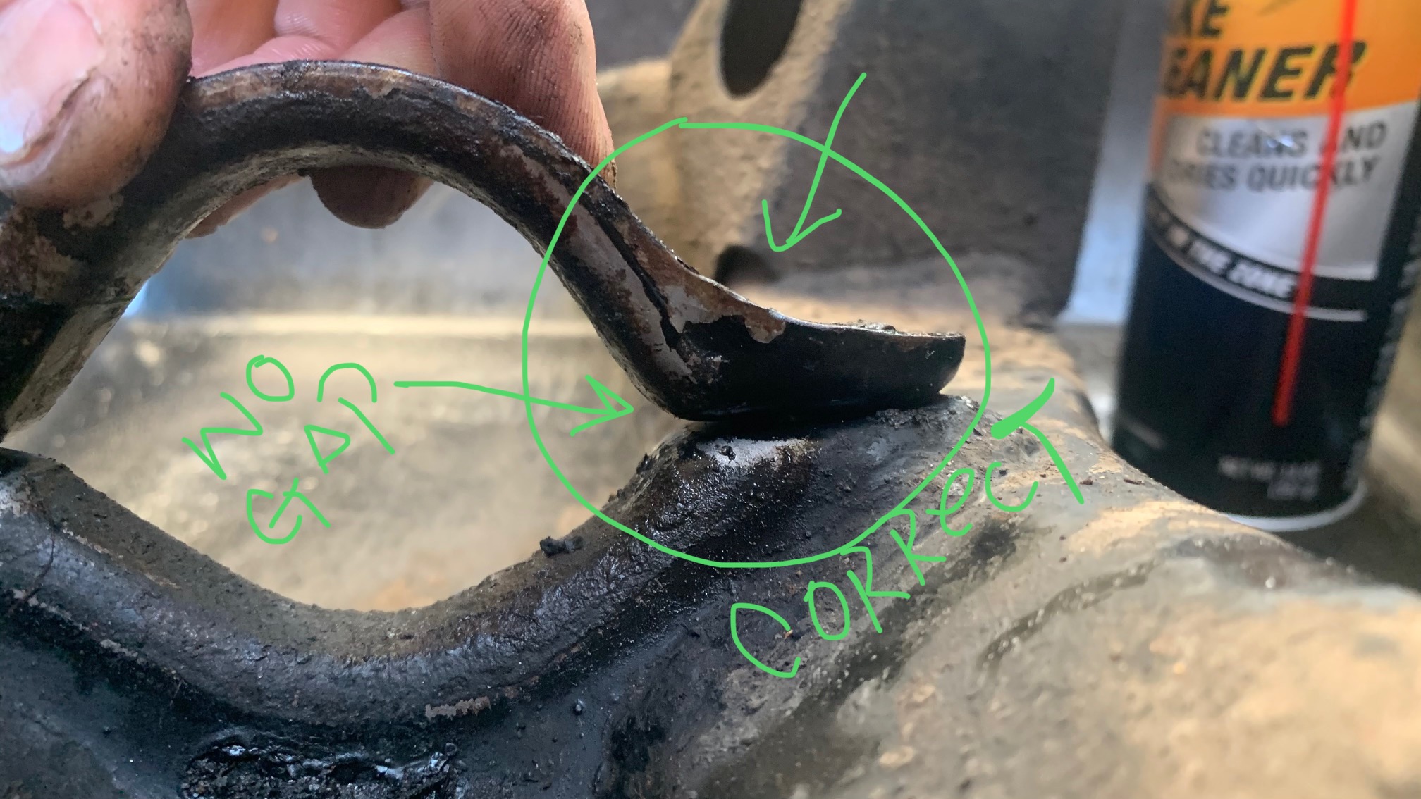

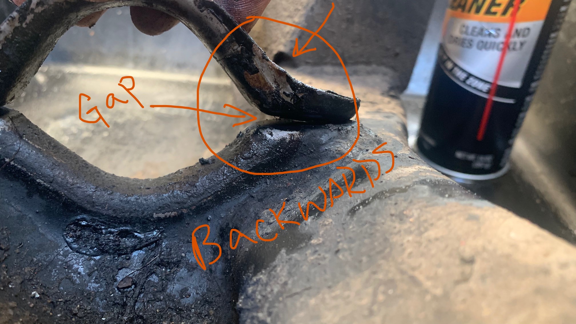

So I was able to find rubber bushings for the steering rack but it seems people prefer the poly there.  I guess it provides better steering response? I just don’t want any squeaking so hopefully that’s not a problem.  I have rubber for all other bushings.   So Captain Obvious made an interesting observation regarding the steering rack brackets, the ones that connect the rack to the crossmember.  There are two half moon shaped brackets and looking at them they appear symmetrical but he had noticed a slight variation in them.  I went to test fit mine on the rack and discovered there is a front and back to these brackets.  If you put them on wrong there is a noticeable gap in the rear matting surface.  Astonishing, he was able to see the suttle difference in the way the bracket transitions to horizontal on the outer flange of the bracket.   See pics below.

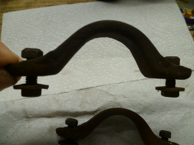

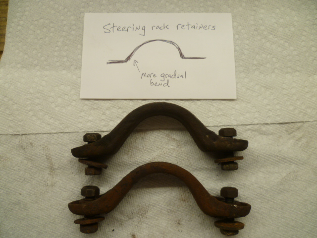

Here's some pics of the rack retaining straps that try to show the asymmetry I noticed.

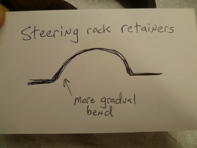

I've never ever seen any chatter about it, but it appears to me that these straps have a "front and a back"? The difference is subtle... I've included a sketch I whipped up to exaggerate and highlight the difference:
The jury is still out on which way the straps should be installed, but here's what I found. I think the more gradual end goes towards the front of the car, but since I've never been in possession of a rack that hasn't been worked on in the past, I can't be sure:
Thoughts from the collective?
Bruce, concur with you 100%.  Do you agree the flange doesn’t sit flat if they’re installed backwards?

I haven't held those retaining straps against the rack since I took them off. If I get a chance today, I'll do that and snap some pics. Back when I first noticed the seeming asymmetry, I'm sure I tried that, but I don't remember how it turned out.
And yes, they're rusty. Not "bottom of the sea boat anchor" rusty, but typical "fifty year old east coast car" rusty.
Interesting, Good eye @Captain Obvious. My front suspension is out so I thought I would check the clamps on my 7/70. I took the left clamp of and took measurements of the angle for the forward and rearward ends. The forward end measured 56 degrees and the rear measured 50 degrees, the bottom face was quite parallel for both ends.
