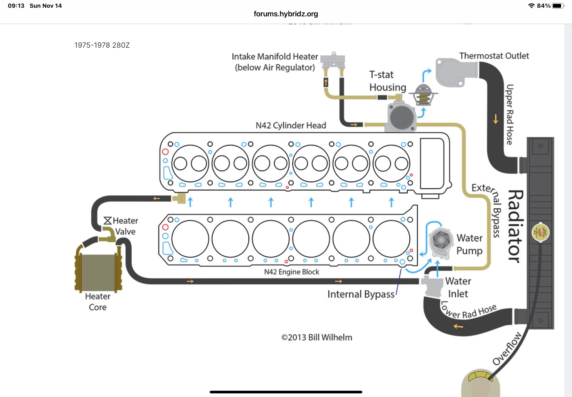

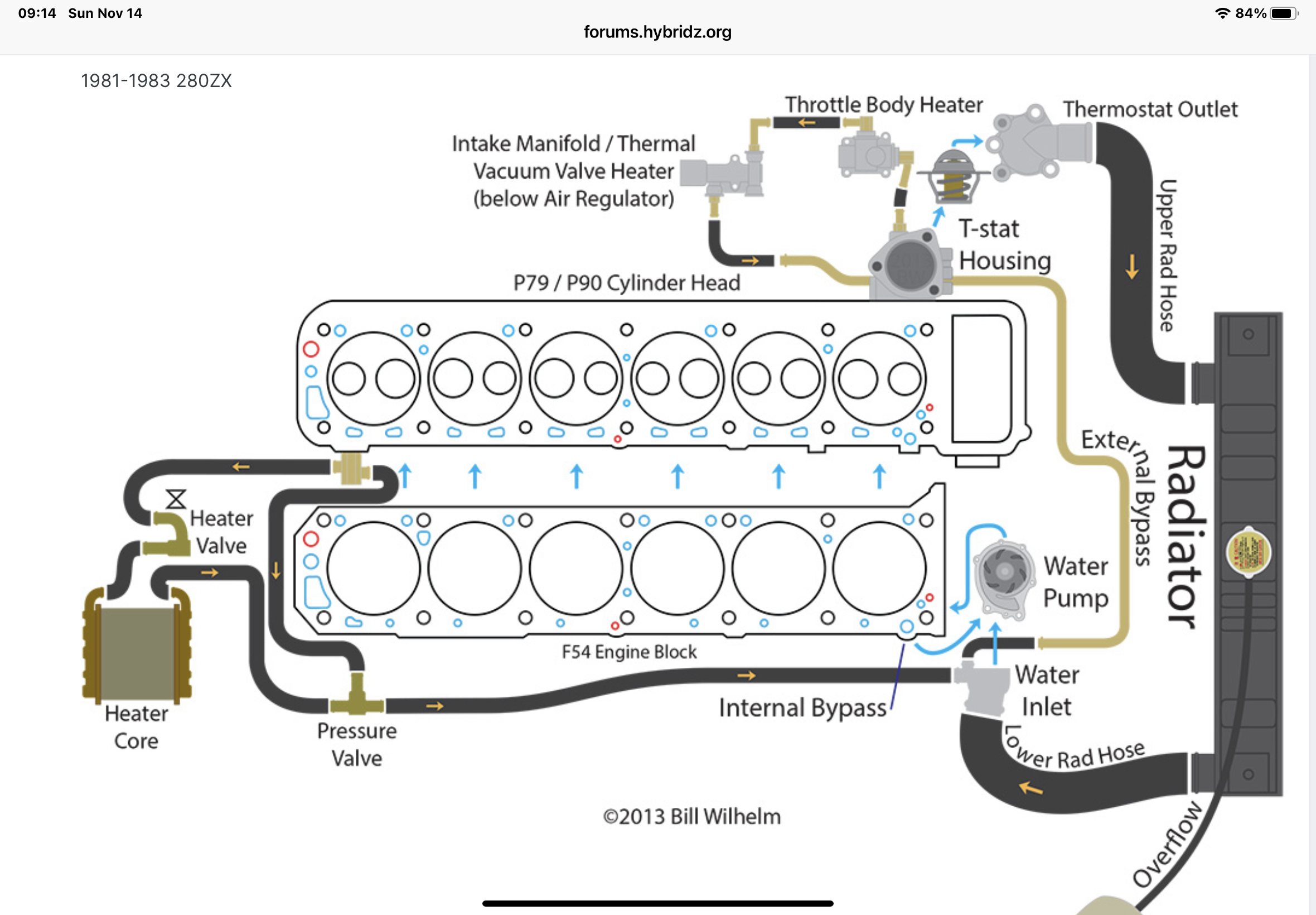

Parts finally arrived from MSA,  so I now I have all the pasts I need to get this engine started.  Two questions.
1.  The Z and Zx have different routing for the heater hoses.  The ZX has a pressure regulator on the hear hose near cylinder 5 and the Z doesn’t.   Anyone know about this?  I think have the ZX part in my box of parts they I pulled off the engine when I bought it from the salvage yard.  Is it a better way to go or just plumb it like.a Z.
look at the images below.
Very good question and just in time for me because i'm almst ready to put my 280zx N42/N42 engine back in my engineroom.
My car has a N42 head  (280zx) and is cooled as in the lower part of your picture.. i ask myself the same question..  Is that valve needed..  I know that in my first 280zx 1980 eu modell it leaked just a little bit.. (very few drops sometimes on the starter..) it was made of plastic i remember..
If i could leave it out, i would!  (Less parts less problems can occure)
The only thing i can think of is when you don't use the heater there is a bit less water movement in the rear end of the head... as i see a N42 on the 280z (the same one as i got in my 280zx orig EU modell) i think it's not a problem to plumb it like a Z..

I have been running the F54 on my '80ZX without that valve for several years and have found no negative side effects.  I have no way of knowing if my heater core is original, but being as it's no longer available, I'd guess it's at least a decade old.  I inspected it last year when the dash was out while fixing floorboard rust holes and such. No apparent problems.  I run the heat pretty much constantly in the winter.
I'm not sure if that would ave anything to do with coolant circulation to the rear of the head, but during the break in procedure of my engine, I checked temperatures from the front of the engine to the rear and did not notice any wild variations in temperature(with IR temp reader and spark plug observation). Roughly 3,000 miles since rebuild.

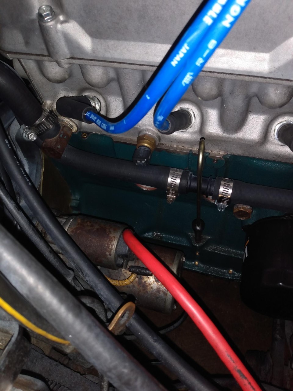

Okay, final step before filling the cooling system today was to flush the heater core. Ran a garden hose in the inlet and a hose out the outlet to a bucket. Ran for fresh water for 5 mins, then filled the core with Distilled Vinegar and let set 30 mins, flushed again and ran vinegar again sitting 30 mins and ran fresh water and then blew out all remaining liquid. The water ran brown the first 15 secs on first flush. I got a fair bit of debris out of the core and that stuff that won’t be in my engine. Of note, when flushing the vinegar out after sitting 30 mins, the water came out green for the first 15-20 secs, I’m assuming glthat was build up on the copper coils. Here’s the particles in the bottom of the bucket. Now I have to flush the tankless water heater for the house, it’s time and I have all the gear out already.

I looked over the pic as best I could and didn't find anything worth mentioning. Looks great!
