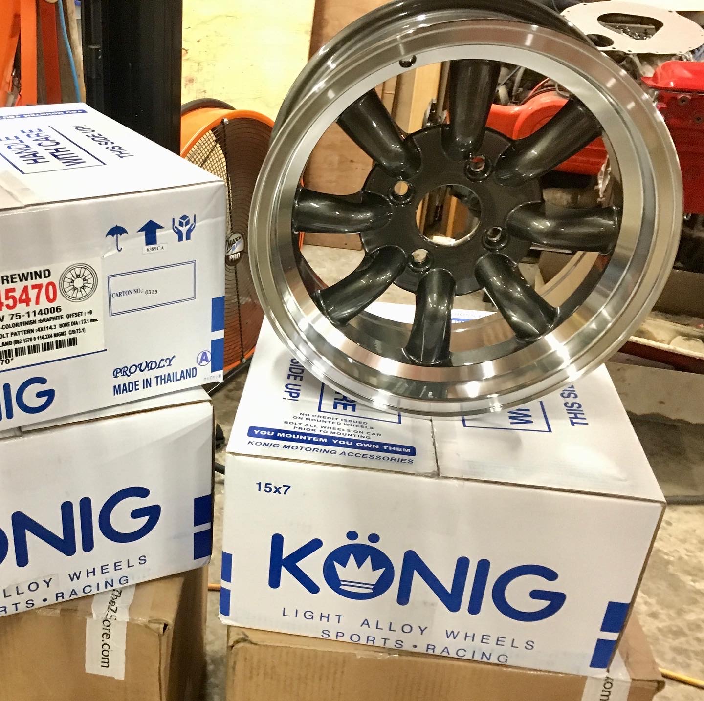

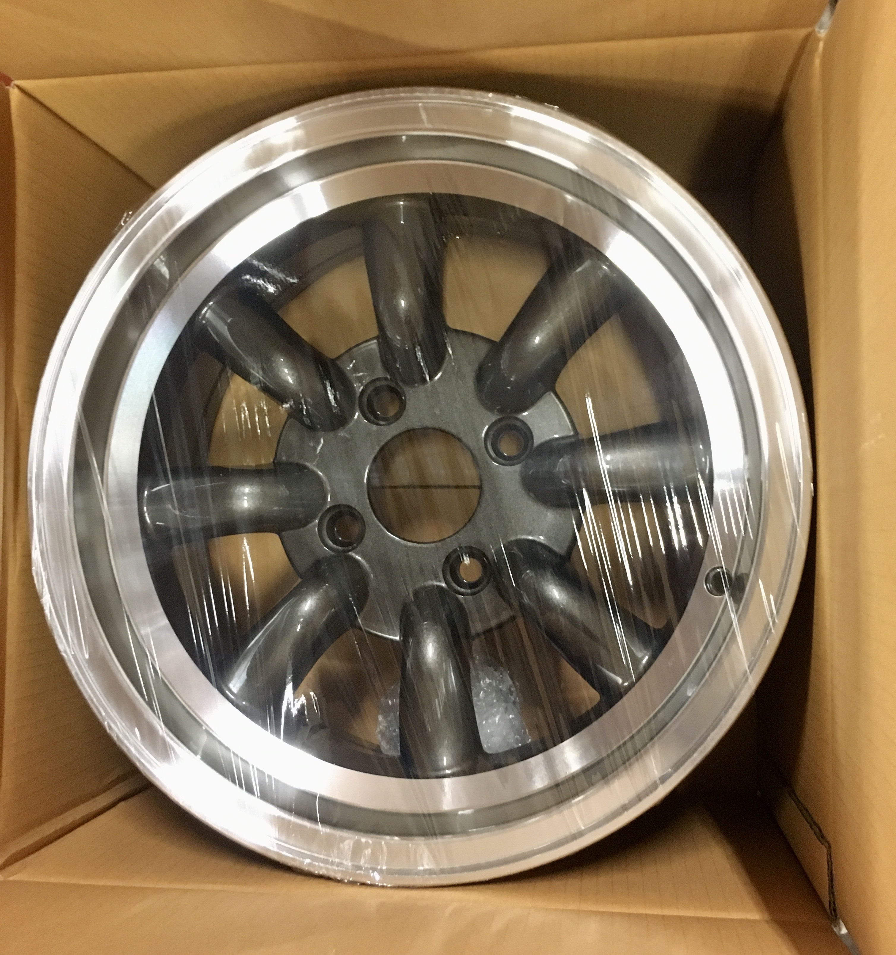

so I went with the 15" wheels and 205/50-15 Falken tires.
There seems to be a few different options available in that size, so I thought I would give it a try.
Tires are on order, so hope to see them on the car by the end of next week......

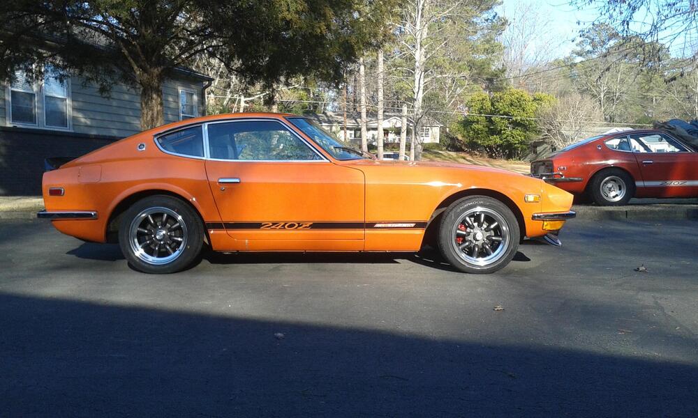

I've got that wheel and tire combo on my 240, 205/55 Hankook tires. I put the wide 5 speed out of a '79 ZX too. It's pretty accurate driving side by side with another car while talking back and forth on our phones. I have the r180 that's original to the car. Seems like I used the 4 speed speedo cog in the 5 speed transmission. I'll try and find that old thread where I asked about it later today. Those 15x7 fit perfect and look great. 16s rubbed in the fronts so they're on the 280.
