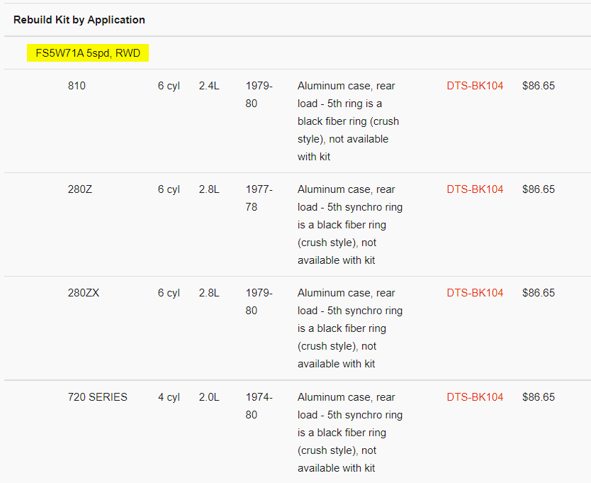

@Zed Head I was wondering about that, I included it in the video because it didn't seem right especially since that allows the constant mesh gears to become slightly misaligned. While we wait for some feedback from the others you tagged do you have any insight into my second question around the FS5W71A kit for the 280Z and whether that will work as a rebuild kit for my transmission?
Assuming it is a bearing issue I would think it is a good time to replace all the bearings in case any of the others are close to going out. I could get a rebuild kit on order in the meantime.

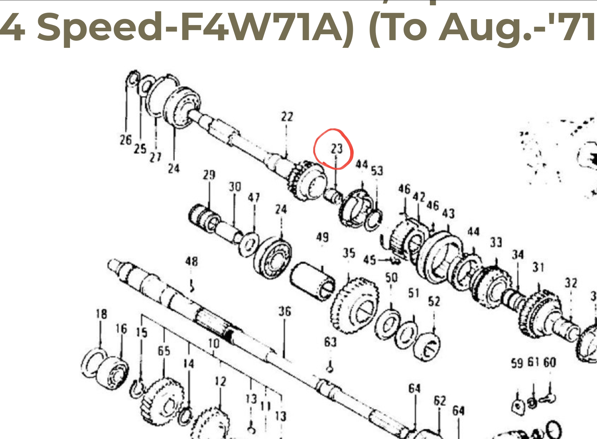

I now have read through this thread and what you are describing sounds like a failed neddle bearing between the input shaft and the main shaft. 3rd gear puts the most strain on that needle bearing. If it starts giving problems, then 3rd will show it first.
It will be interesting to see what the bearing looks like.

Out of curiosity did the 280Z come with the FS5W71A transmission as well or was that only on the 2000 Roadster? Maybe this is a typo on drivetrain.com? Their website shows that transmission in the 280Z/ZX among others:
2021-07-29 18_09_35-FS5W71 Nissan Manual Transmission Rebuild Kits and Parts - drivetrain.com.png
If you are able to find the bearing part numbers that would be very helpful, I will get to work on removing that needle bearing in the meantime and post a picture of the condition once I have it.
There is bad information out there on the various web sites about the Z car transmissions.  And the kits are incomplete.
Here is where EuroDat got that drawing.  Compare the part numbers and you might be able to confirm that it's the same bearing used in the later four and five speeds.  Then use EuroDats's writeup to cross-reference.
Click through the four speed page and you'll find the early 4 speed.  You can probably find a cross-reference to the Nissan part number also.
