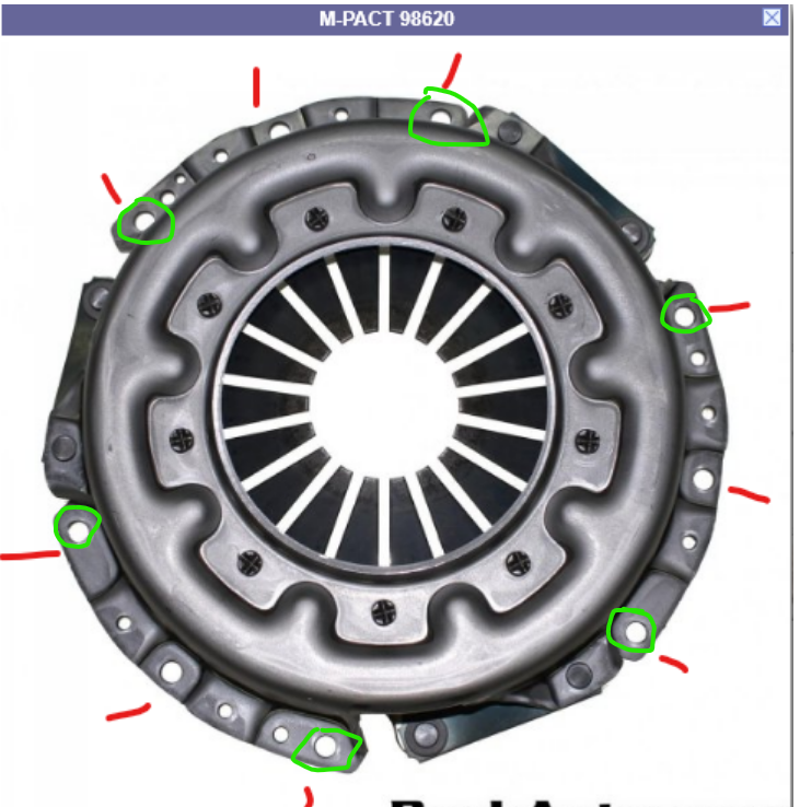

Thanks for the help, I just rolled under the car to check, I do have the 240mm setup because it has 9 bolts holding the pressure plate on. Sounds like from what you guys said this is fine to run on my car? I do intend to check the 92mm measurement before bolting the transmission back on, something I did not check the first time around. I know for a fact that I have the shorter Type A throwout bearing collar, have a hunch I will need to order one of the taller ones to hit that measurement.

@EuroDat thanks for the additional clarity, helps to clear things up a bit. I definitely have 240mm setup with the original shorter collar, it measures 34mm from the face of the bearing to the top of the ears. I removed my pressure plate today and measured the height on the forks, it is approximately 47.5mm. I was right around 10mm short on the 92 mm measurement from the ears to the face of the flywheel with the current collar, it looks like the 75-83 Z/ZX Coupe Non-Turbo collar should match up and get me very close to the 92mm.

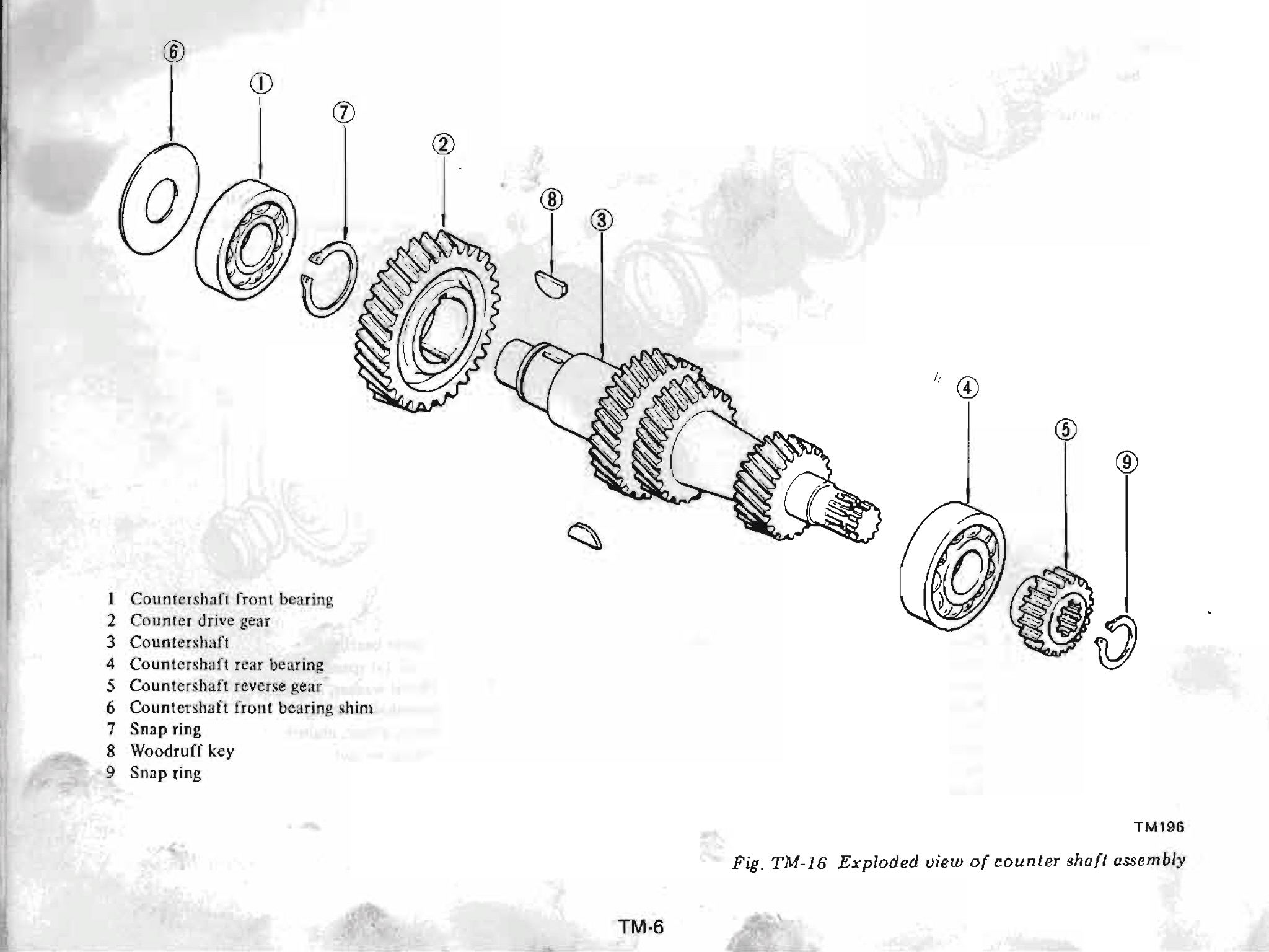

@EuroDat another question for you in the ongoing rebuild saga, item #18 below is some type of shim or spacer that goes under the counter shaft bearing in the adapter plate:
I am coming up empty on any information on the OEM thickness for this shim, it is NLA. Do you happen to have one to compare or know offhand? I am pretty sure the one in place currently is not OEM, and neither is the bearing sitting on top of it (item 16), looks like a cheap replacement. Item 17 at the other end of the counter shaft on my transmission is a Nachi bearing which is probably the OEM bearing, I am replacing both with new Nachi bearings. Just want to make sure the shim is the correct thickness, mine is a rough cut piece of aluminum with measurements O.D. - 51.5mm, I.D. 34.2mm and thickness 2.65mm.

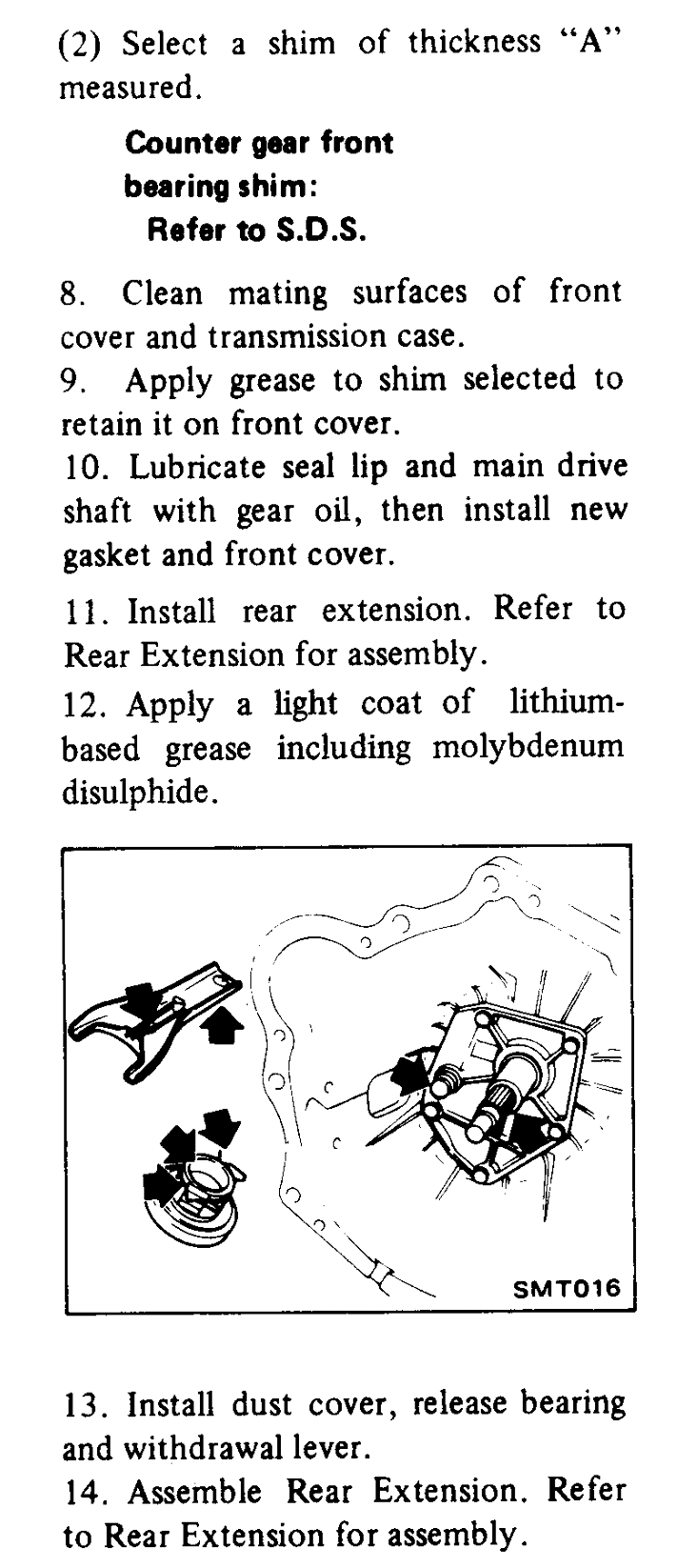

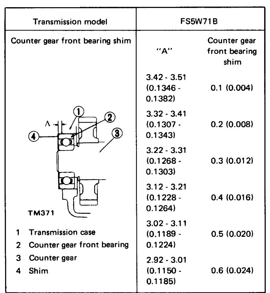

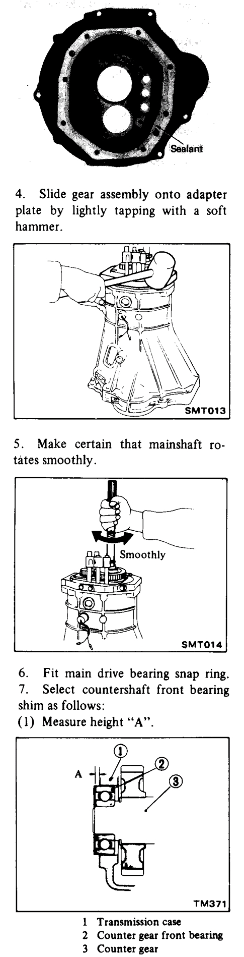

That shim is for the cluster shaft end play. The 71B is slightly different but the priciple is the same. See attachment for the 71B set up.
You shouldn't need to adjust the shim thickness after replacing the bearings. It becomes critical when you change the cluster shaft of the transmission housing. The cluster shaft and housing have tolerances and the shim compensates for this. The bearings on the other hand are precision machined parts and don't have those tolerance issues.
It does not hurt to check. The bearing should have a small amount of end clearance. Ball bearings should not be pre-loaded. They are not designed for high axial tension like a tapered roller bearing.

That is my concern with this non-OEM adapter plate shim that seems to be in my transmission, I am worried the shim not being original might not be properly compensating for the shaft and housing tolerances. Could also be throwing off measurement "A" in your post for the end float. I also did not have a front shim at all when I disassembled my transmission, can't recall if I mentioned that earlier. I found a picture of the same adapter plate shim in my Haynes Manual, the I.D. looks much larger, which seems to support my theory that my current shim was something installed during a rebuild:
Wondering if I can "reverse engineer" the thickness by installing the counter shaft without an adapter plate shim and subtracting out the recommended range for end float from measurement "A" above. Any better suggestions come to mind?

@EuroDat correction on this post, #19 is the item I was referring to as the shim between the countershaft bearing and the adapter plate, the non-OEM aluminum spacer I showed in my picture was #19, not #18. I was looking at the countershaft backwards in the diagram, sorry for the confusion.
Pos#19 is not in the later 71B versions. Pos#18 (Pos#6 in the 71B 4 speed, see attachment) is used to correct the tolerances in the transmission housing.
Pos#19 is designed to remove any axial movement between the adapter plate and the adapter plate bearing. I don't know why they chose this method to remove end play. The point to all of it is the bearing should fit neat in the adapter plate housing without any forward / backward movement.
