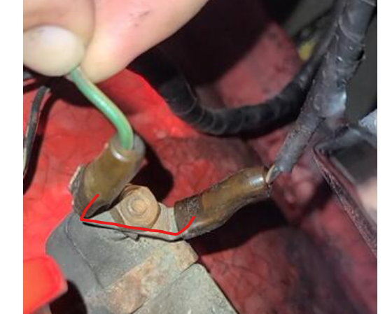

So I'm curious and tried to find the answer online but on my ballast resistor I have 2 wires. One is black and white, the other is green and white (although the white on both looks yellowish). Can I connect them or do I need to connect them to somewhere else?
Thanks for the help. I've read the writeups online and none seem to match my current coloring
Connect them together.

Are you absolutely sure they can be connected? I can't find a wiring diagram to confirm their outputs and such.

Yes, I bypassed the resistor in my 260Z that has a ZX distributor. I have done the same in my 73 with a Pertronix, though I haven't fired it up since I put in the Pertronix.

Same colors? I don't wanna burn the coil or start a fire haha. Thanks though

The wires are already connected.  They attach to the same piece of metal.  Nissan used the ballast resistor as a convenient place to create a terminal block.
