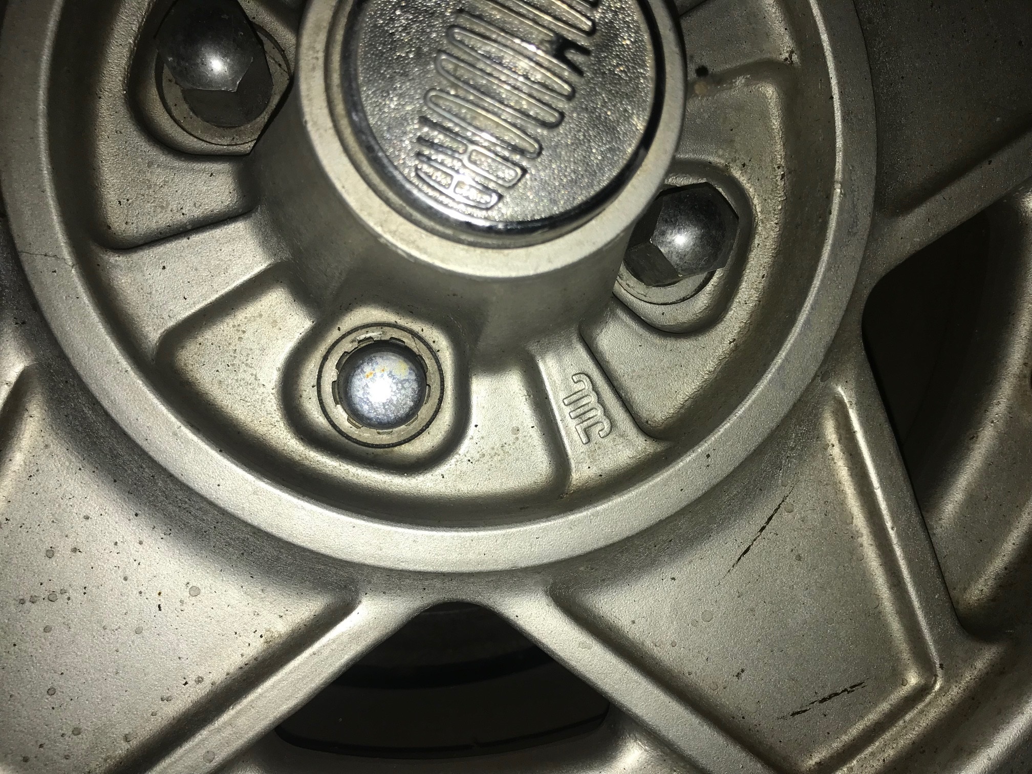

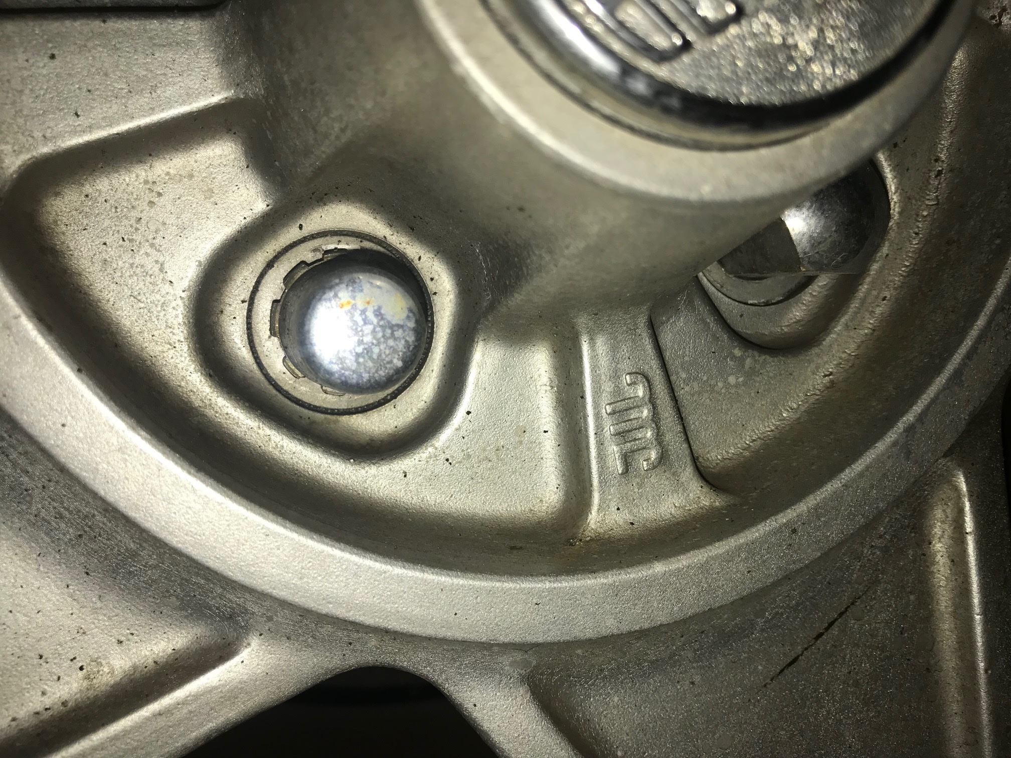

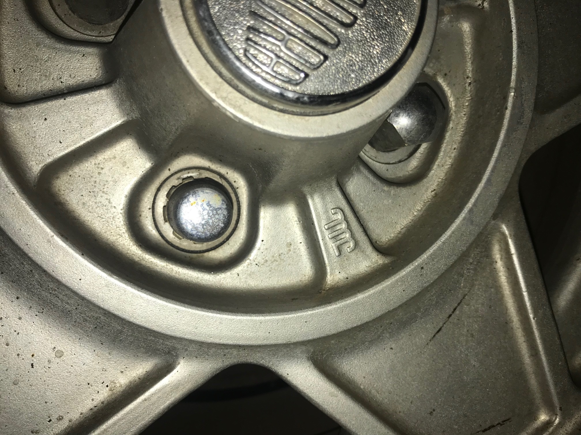

They also sell hardened cone shaped sockets with teeth.  You hammer it onto the wheel lock and it bites into the nut to allow removal.  I'd be a bit worried about grinding flats as you don't have a lot of space to work with before touching the wheel.  I'm assuming you are trying to save the Chromodora wheels.
Bolt extractor. I usually use them with a breaker bar and tap on the back with a hammer as I try to rotate it to help it dig in.

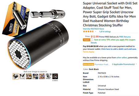

just for reference - I won an auction on this >> Sunex wheel lock remover. (Not at home right now so I can't snap a photo)
Maybe google has some better photos - at least it gives a starting point.
It was used, and some of the 'teeth' had snapped off some of the sockets. I don't recall if any of the sockets had that many teeth to fit over your application
The auction photo (credit to People's Auction Company, Inc. Chesapeake VA)
