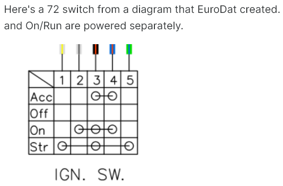

The question isn't "will it run" it's "will it start".  The later switch diagrams, like the 72 diagram from EuroDat above, show separate power circuits to the coil.  A Start circuit and a Run/On circuit.
And, yes, there is a "jumper" in the ign switch/coil circuit to bypass the ballast resistor IN THE START position. So at START the coil is getting full battery voltage and in the ON (run) IGN switch position power to the coil goes through the ballast resistor.
Sorry, my wording wasn't precise. It will both start and run with the B/W's swapped. If they are in the "incorrect positions" you will loose the tach but since the coil"+" is then wired directly to battery voltage from the IGN ON the "START jumper" isn't needed. You just lose the loop to the tach and power to the coil is not going through the ballast so it will always have full battery voltage.
Nice video.  Now I'm left wondering if a 72 will Start with the wires switched.  The switch diagram shows just one power source for the coil for either Start or On, there should be no power there at Start if the wires are switched.
The 71 diagram shows all 5 pins powered at Start though.  If we only had the 71 diagram there wouldn't really be a discussion.

@Zed Head I went back and found the 71 wiring diagram I used from the 1971 FSM Supplement and it seems to show the same thing as EuroDat's 72 diagram. If it is accurate I am still wondering how the car can start with the B/W to the Ballast being switched out of the circuit in START assuming you had that wire "swapped" (connected to Coil +)
Not to dwell on that issue too long, but I think this is what was confusing me back when I did the wiring on my car.
