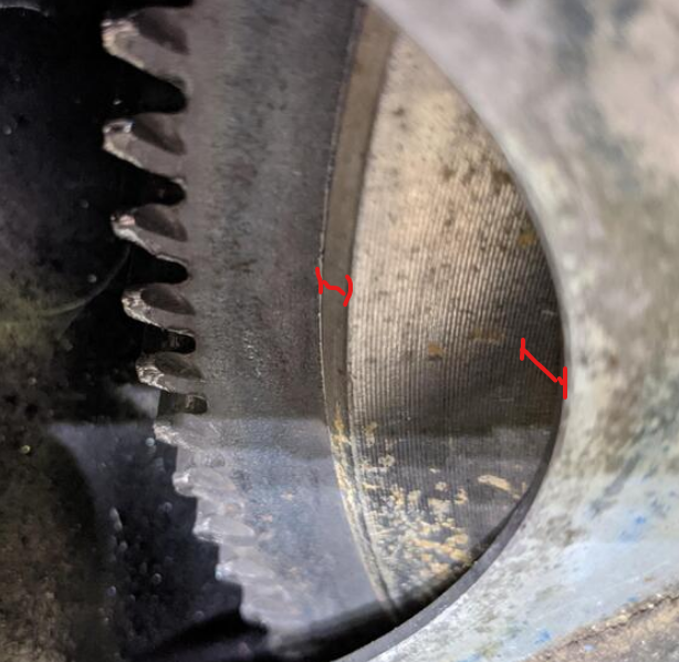

Might be that the flywheel is sitting too far from the block.  A measurement from the back of the flywheel to the dust cover (the thin metal plate) would be good.  Somebody could compare to theirs if they have an engine handy.
p.s. the ring gears are press fit on to the flywheels.  Yours might have moved.  Hard to tell, that's why a measurement to the flywheel will be best to compare to others.  If that shiny flywheel surface is flat, that's a lot of space that might have been covered (Edit - added red lines for emphasis).  I'll see if I can find an image of the back of a flywheel.

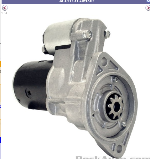

Wonder what the difference is?
https://www.rockauto.com/en/catalog/nissan,1976,280z,2.8l+l6,1209226,electrical,starter+motor,4152
p.s. if I had a spare engine a bunch of flywheels like I used to I'd go take some measurements.  Yarb might have hit on a solution.  Trade your starter in for a 1978 or ZX gear reduction starter.  Maybe it has more throw for the gear.
https://www.rockauto.com/en/catalog/nissan,1978,280z,2.8l+l6,1209260,electrical,starter+motor,4152
