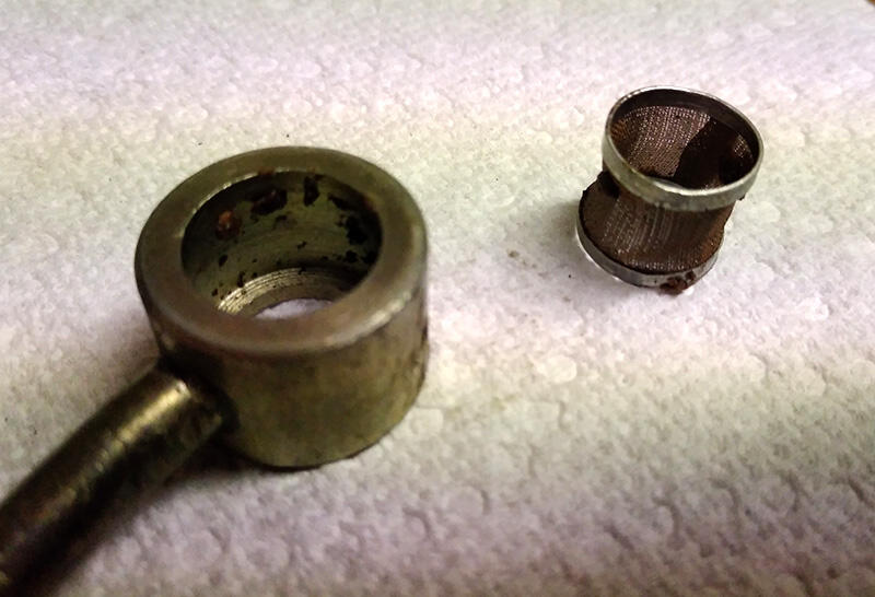

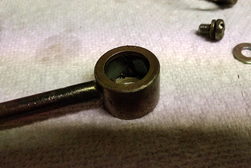

Found some gunk in the last-chance filters.  Front:
And rear:
Got it all cleaned out.

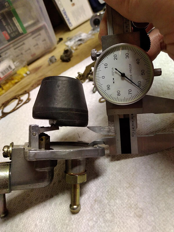

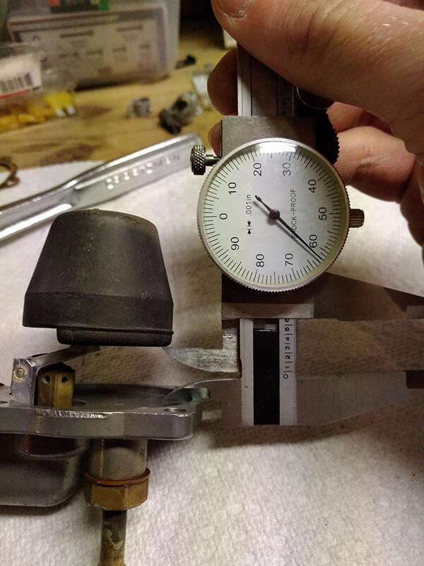

And I set the float heights to 9/16" (.5625).  Front:
and rear:

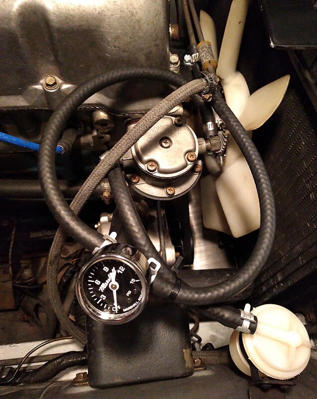

Hooked up a fuel pressure gauge thusly:
Reset the mixture screws to 2.5 turns down.  Assuming everything looks good, hopefully I'll get some insight when I'm able to drive the thing again.
and rear:

For future reference, you can put the fuel pressure gauge on the line between the fuel rail and the carburetor. I found it easier than trying to connect it to the fuel pump.

First, the metal portions of those floats looks like they have bent away from the floaty portion of the float. And one of them worse than the other. From what I've seen, the metal hinge part of the float should be pretty much parallel to the top of the float foam portion. Yours look like they have been pulled away from the foam.
Second, you are working on a pair of three screw round tops and they were designed to operate with different float levels in front and rear. So if you mechanically set both floats the same distance from the underside of the lid, I'm not positive that's going to translate to the same level once they are wet in the car. The other changes may come out in the wash, might not.
And last, don't forget that the mechanical set you did there is just to get them in the ballpark. A wet set with a clear tube is the way to confirm that the levels are correct. Any mechanical means is just a preliminary ballpark setting that must be confirmed wet.
Ah good tip.  I'll change it; it would be a cleaner install and allow me to monitor the gauge while I'm on that side of the car.
Well I'm not claiming to be qualified to check anyone's work, but I have a couple comments...
Thanks for the tips.  I'm working with what ZTherapy provided when they rebuilt the carbs (for the 2nd time) 10-odd years ago.  It looks like the pivot point for the floats is located differently b/t the front and the back carbs.  I guess the danger is the float hits the back of the bowl and can't pivot enough to open up the jet...  We'll see tomorrow.
And thanks for the insight about doing a wet set.  Depressing to realize there's more involved in getting this thing set up correctly given my motivation is where it is, but I'll just have to knuckle through it.
Yes, the pivot points are different between the two lids. And the mounting surface depth for the float valves into the lids is different too. I took a bunch of measurements of the lids a while ago an think I posted some details.

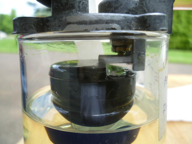

And about the bent float hinges, I'm wondering of the severe bending of your hinges was done by ZT in order to get them to work right. They shouldn't be like that, but that might be the only way they could get it to work? Ideally, here's what you want your float to look like when the level is correct:
And absolutely check the float levels wet. If the levels are OK, then you're done. if not, use the wet set method to get them right. You can't just measure them dry and assume that's good to go.
