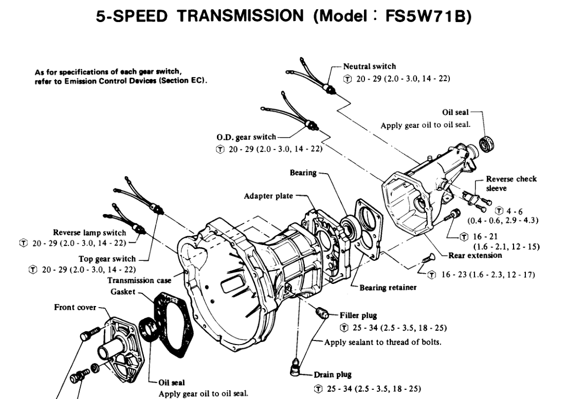

No other ports for a switch?  The 4 speeds had a top gear switch, my 76 had one.  It activated the vacuum advance solenoid.  The ZX 5 speeds had several switches.  Looks like some had top gear and OD switches, for some odd reason.  Maybe they did the same thing.
For some reason Nissan didn't label the switches in the 280Z chapters.  But I think that they'd be about the same as the ZX's.
