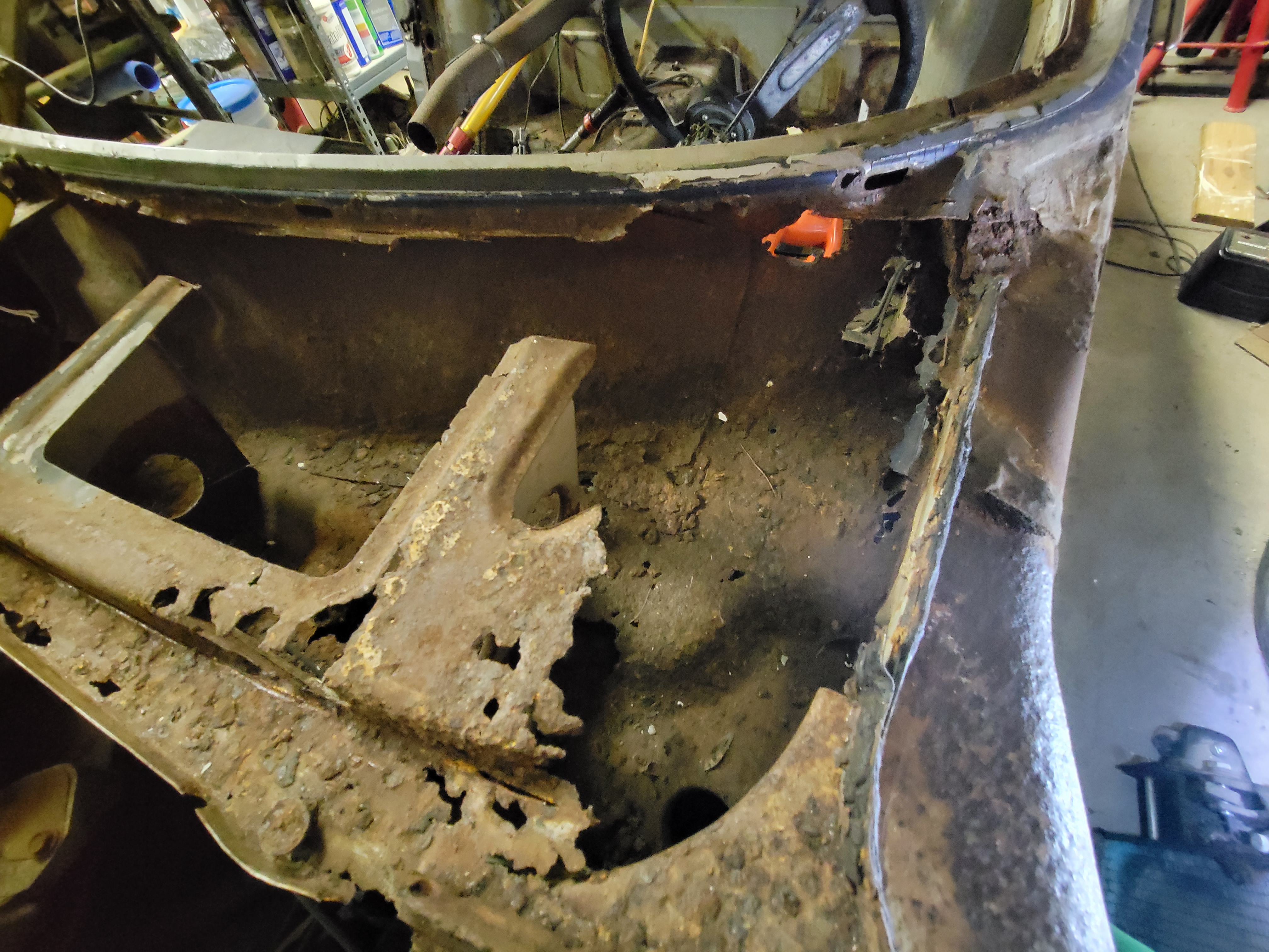

It’s possible but that’s going to be a ton of work I would almost just cut that entire part out and then graft on the donor.  Basically I would cut out the entire yellow area in my picture and then down far enough into the firewall and in straight lines to make welding in a new piece easier.  Are you good with a welder?
