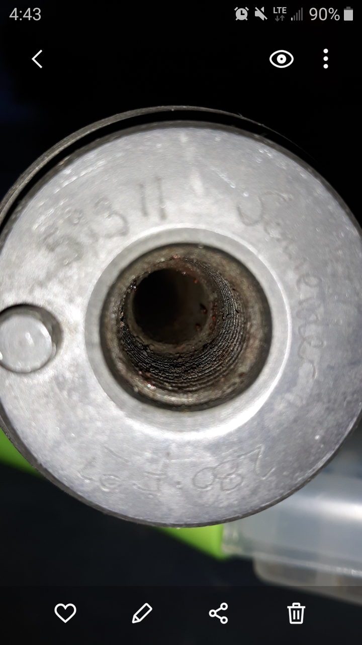

Thank you for that info. I did not get a card when I bought the car. So can I take that number and name, and google it to find the specifications? If the cam is stock- will it have Nissan printed in the same place?
Thank you
As it happens i have a reserve 1973 240z engine laying apart at the moment and looked at the cam.. it has a big A on the BACK (!!) nothing else..
Another new old stock cam i have is a so called slalom-cam and has big lobes.. that one has Datsun and a partnumber on it and the word: brown.  it was in the 70's a original datsun special cam. (new in box.. what's left of it.. cam is as new..)
EDIT:  the letter is on the back ofcourse.. not on the front of the camshaft... silly me...

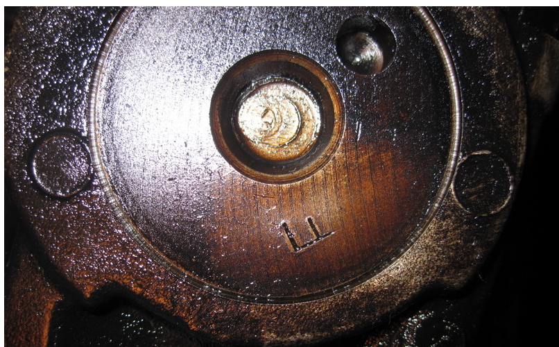

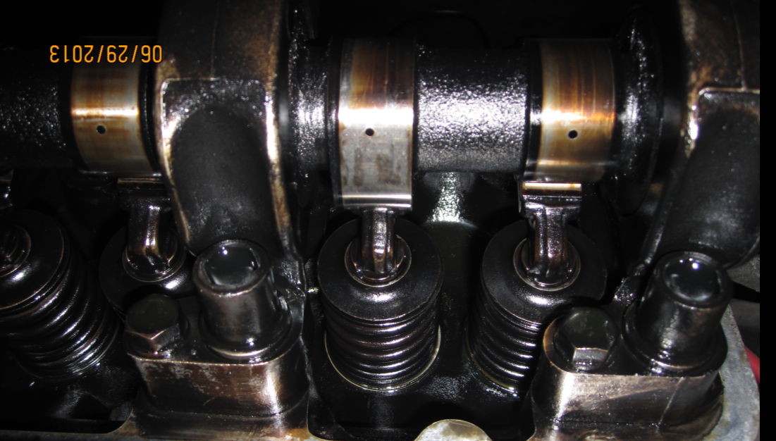

Nissan stamped letters in to the backs of their cams.  You might need a mirror to see it.  Here's an F cam.  Some companies regrind factory cams so yours might have the Nissan stamp and the marks that siteunseen/Cliff showed.  Check both ends.
You can also tell by the height of the base circle.  take pictures of the cam and post it.
