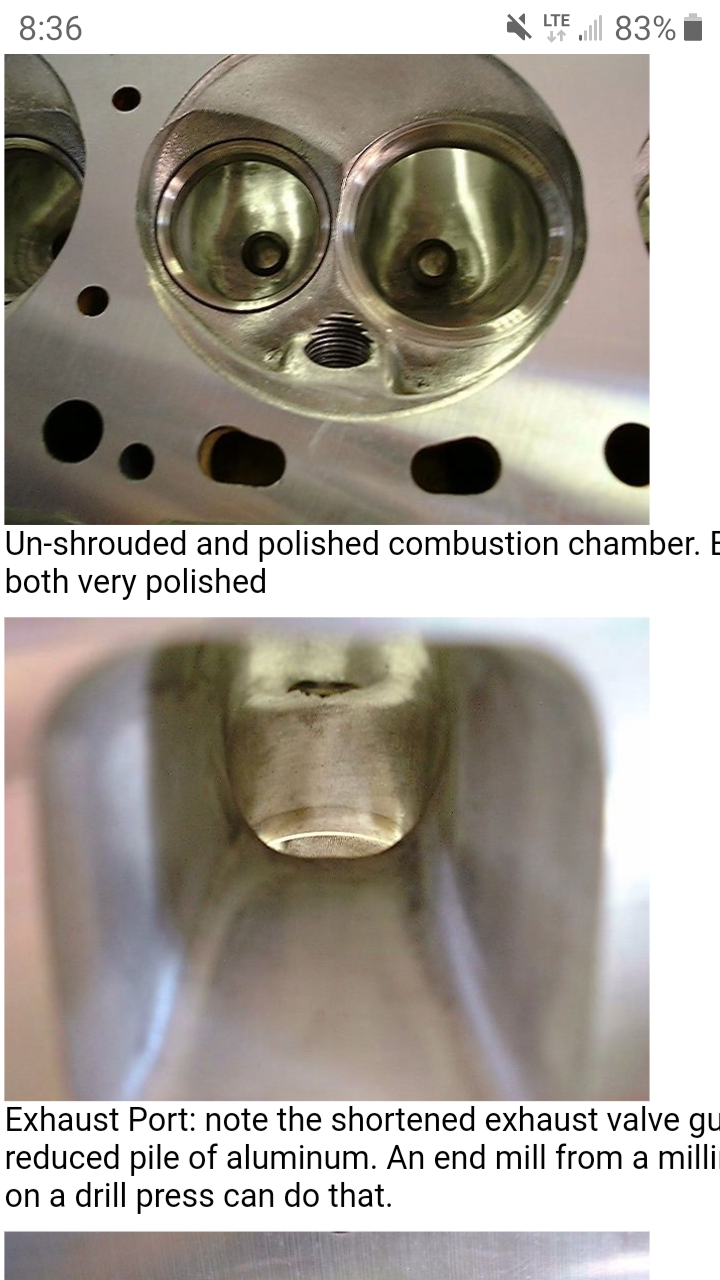

Here's some good stuff with good pics too.
Go back on this link to the main page then click on "engine".
@240260280 is the man! He put this together from info on his computer and his buddies help. It's the 1st page I go to when I need help.
https://www.atlanticz.ca/zclub/techtips/headporting/index.htm
