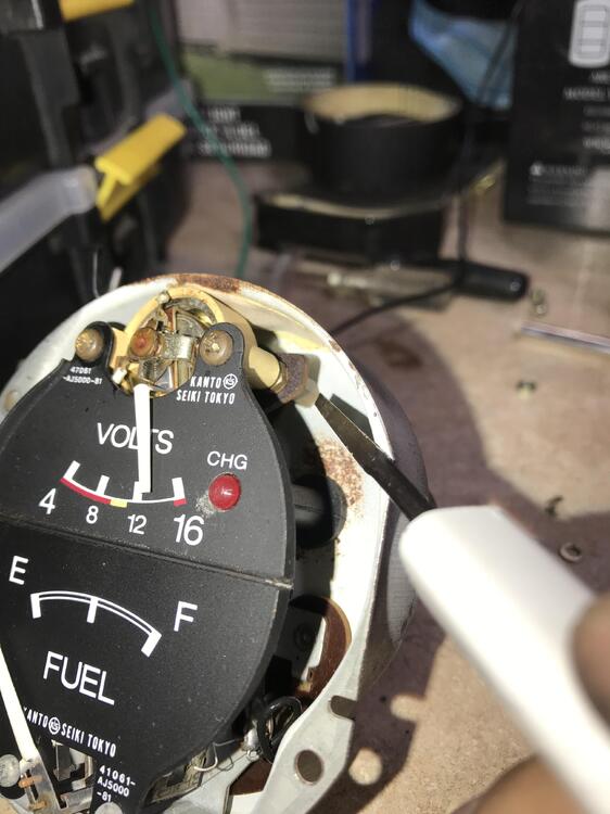

Actually I think I fixed it, there are 2 standoffs on the back side of the volt meter, the looks like 2 long hex shafts. They were loose from the volt meter. I opened it up and it looks like the voltage is stable now.
i shot some electronics cleaner into the potentiometer for good measure. It stopped waving at me.

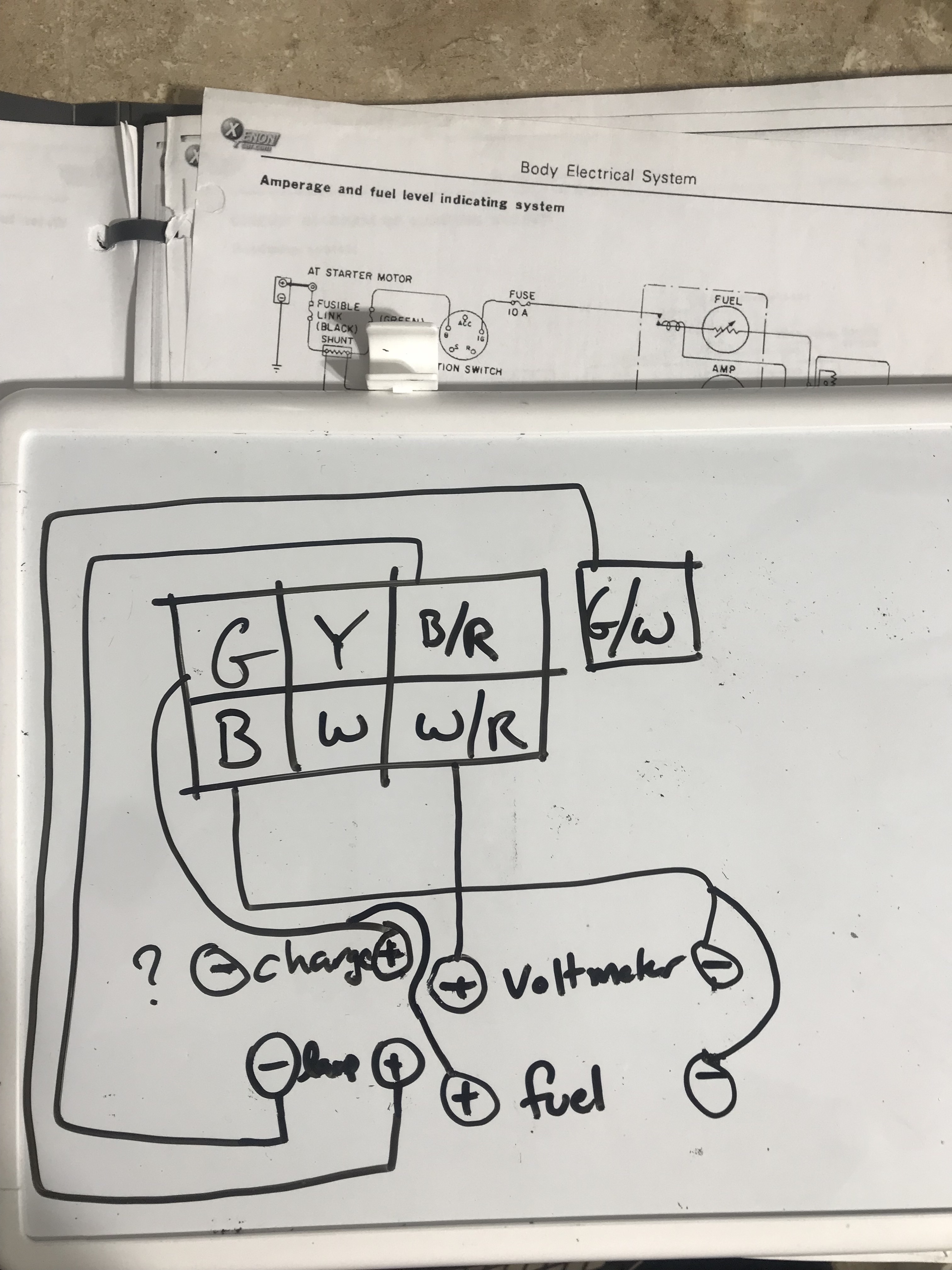

@Captain Obvious I was reading the FSM in bed (everyone’s second favorite activity after eating ice cream in bed) last night and I think your conclusion about the wiring being off is correct.
There are 3 positive connectors for the volt meter, fuel meter, and charge warning LED all feeding off the positive white/red wire on the underside of the dash harness. This 260z has a alternator upgrade, so it’s wiring is a little different, I think the voltmeter goes to the white wire (positive always on), the fuel meter goes to w/r (on with key) and the charge light goes to the L sense wire which is on the back of the alternator/ where the modified voltage regulator plug is.

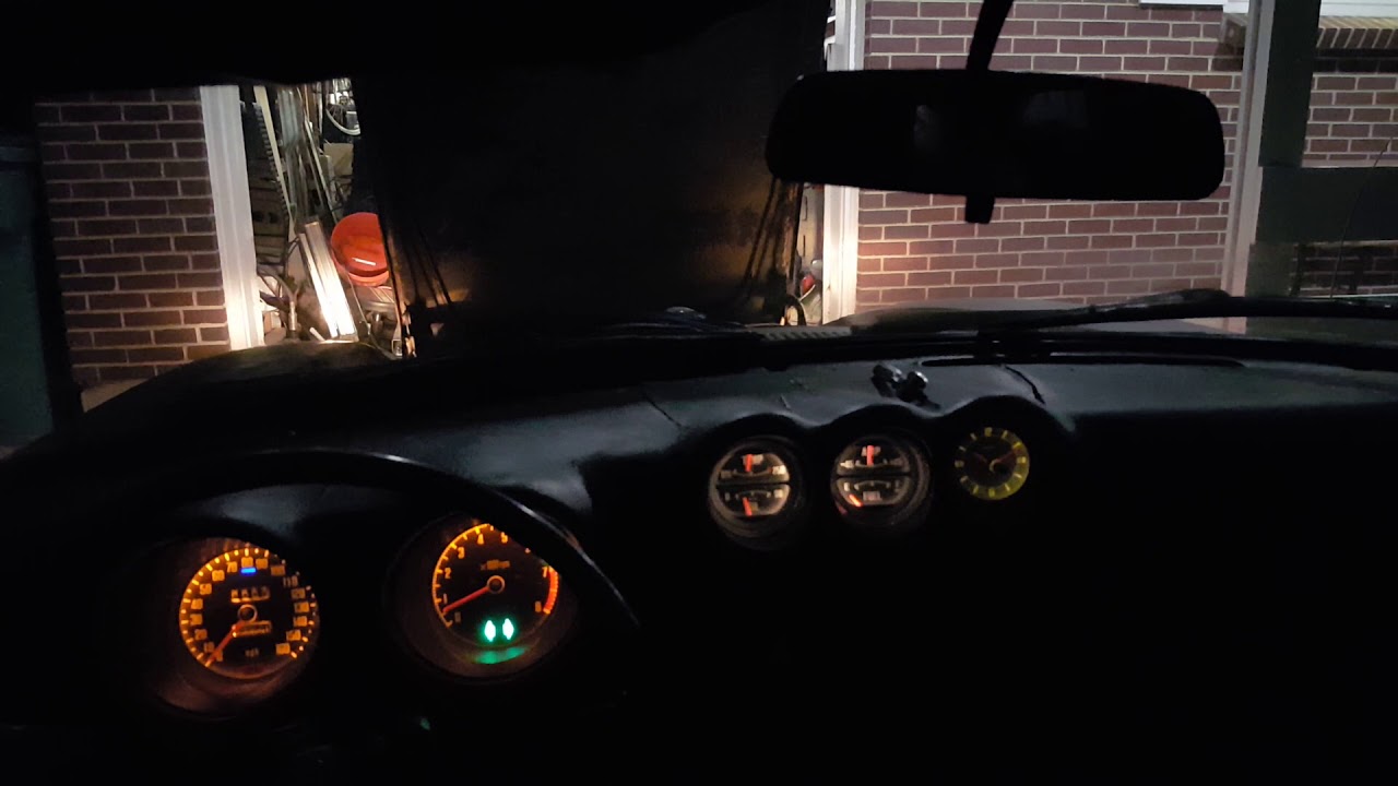

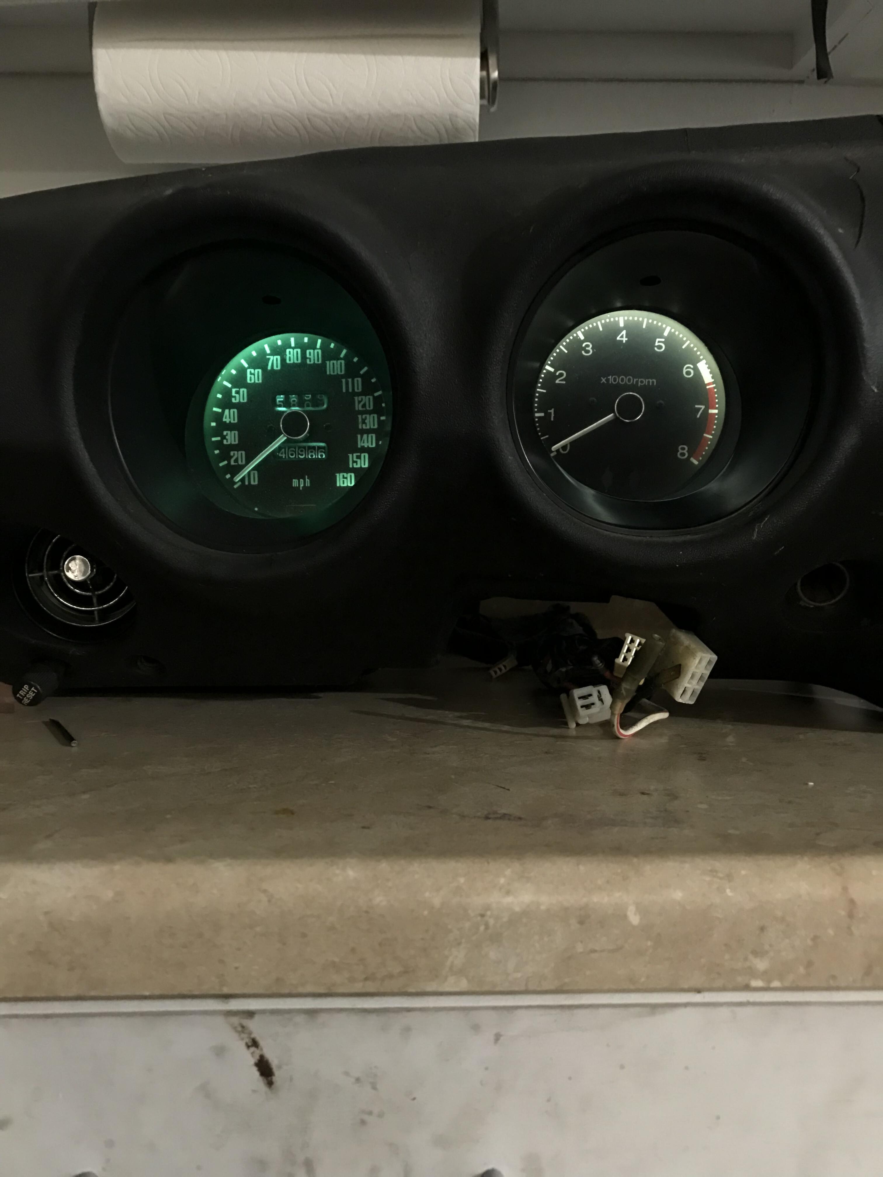

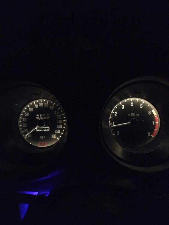

BTW anyone reading this have amber dash lights? I can’t decide between amber and white. Not really digging the green anymore.

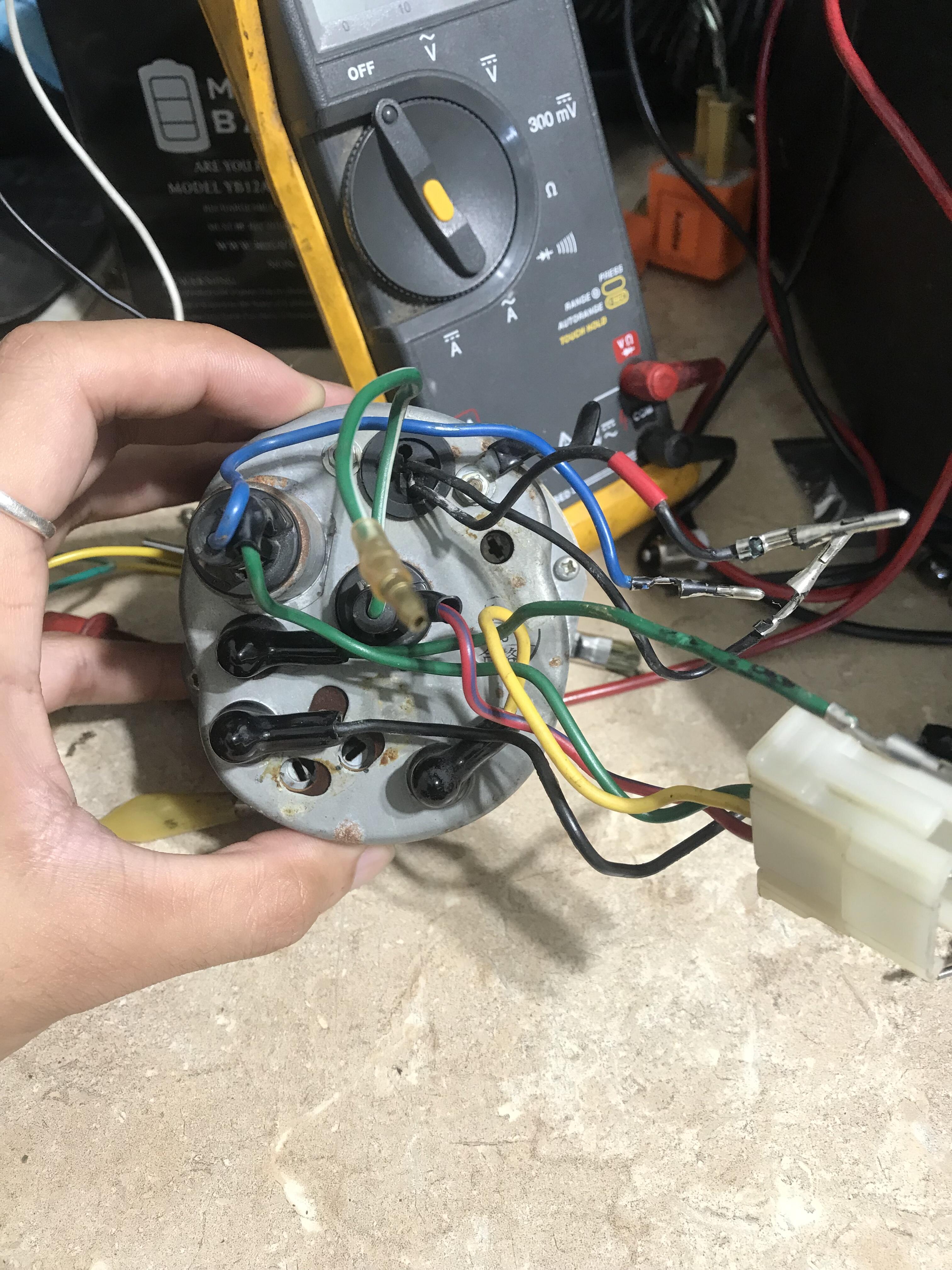

@Captain Obvious On the gauge that is in front of me I have accessibility to each wire individually. When I connect the positive/negative wire for the fuel gauge to the same power supply source as the volt meter, that’s when the waving comes back.
the black wires at the top are for the voltmeter.
the wires were joined together by shoving one behind the other inside the plastic connector. Then taping around….

The two black wires at the top of the gauge (one solid black and the other is black but has a red wrap of tape on it). Those two are for the voltmeter. I assume the one with the red tape on it is positive and the other is negative. Those two come out of the back of the gauge at 12:00 ish when looking at the back.
And then the voltmeter ground is the other black wire that comes out of the back of the gauge at 8:00-ish
Those are the three wires you're working with?

That is correct those are the wires that I'm working with. I plugged positive wire for the voltmeter to the white/red plug on the dashboard. I plugged the positive wire for the fuel meter to the green wire under the dash, b/w on key+. I dont think that I can run the charge light with the wiring that I did in the engine bay, from what I understand it needs to connect to the L outlet on the alternator, but  I tucked the voltage regulator wires when i had to snip and add the diode for the alternator.

Here is a crude wiring diagram, the negative on the charge light is what is up in the air... I ran an extra line under the dash for it if I ever redo the engine harness it will be straight forward to add....
It seems like the waving starts if the positive is also shared from the bench top battery, I wonder if this will also be the case when the dash is back in the car and everything is plugged in, the positive source is eventually the battery/alternator......
