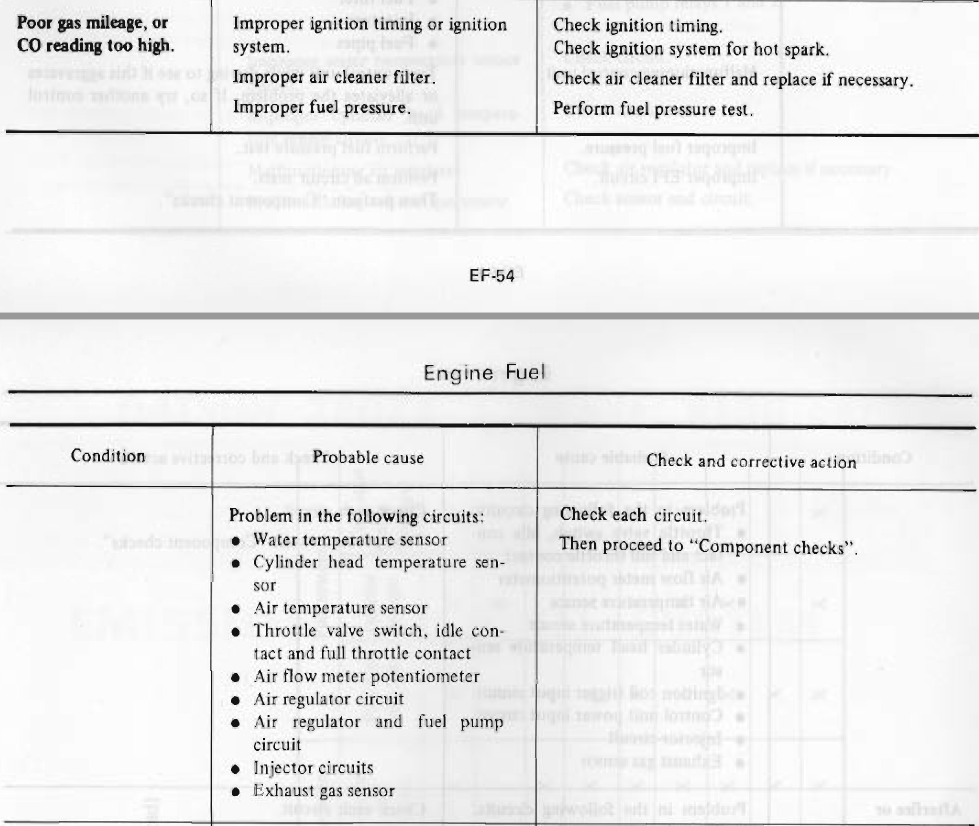

You can find the factory service manual at http://xenonzcar.com/s130/FSM/1980fsm.php. In the EF section there is a troubleshooting section. Unfortunately it is a little vague.
The sensors are definitely good things to test, though.

This book is good.  You really really really need a multimeter to work on EFI.  Hope you have one.  There's an Electrical Test section.
