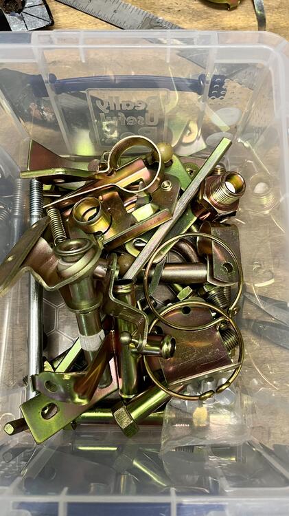

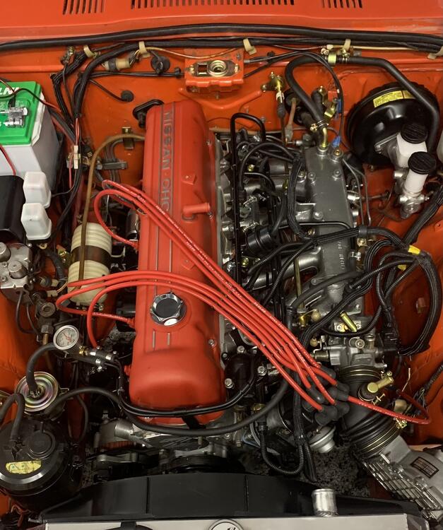

I used a place in San Diego called Anocote Metal Finishing.  They regularly do car restoration parts. I was very happy with the results and cost.  I think it was $70 per hour.  So whatever they could process in one hour.  So lots of screws and nuts will take more time as the have to wire them up.  Here is a pic of a bin of extra stuff I had done by them but don’t need anymore. All the yellow zinc you see in the engine compartment pic was done by them.  It’s not perfect but it’s well within my expectation.  I shipped a 14 lbs box and got it back in about 10 days including shipping time.  Super easy people to work with.  I don’t think anyone does the real deal chromate anymore for environmental reasons.  The stuff I had done is a yellow zinc plating.
