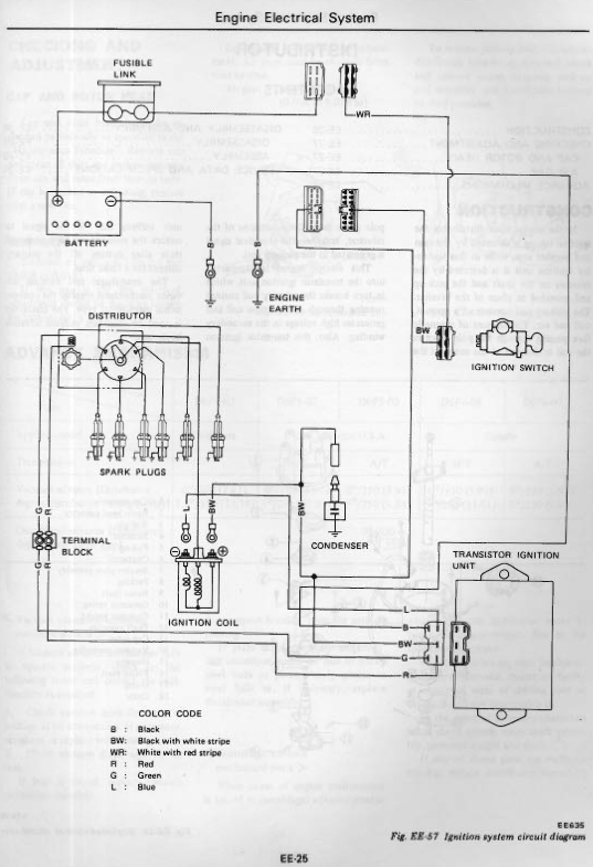

On 11/6/2021 at 3:19 PM, SteveJ said:
The black/white wire that is hot when the key is in Start or On is on the coil positive. Why is the green wire on coil negative? It would either go to the distributor or to the TIU. Neither one is in service, so it could be pulled off the coil negative.

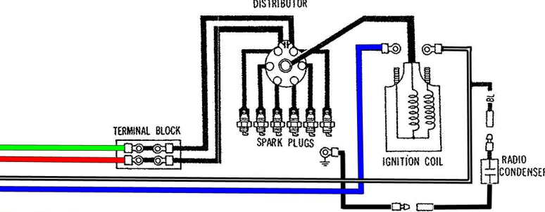

This was Zed Head's response to me asking what the "small box with six sides" was that is mounted near the coil.  Should I disconnect the wiring for this trigger now that I have the Fast system installed?  I haven't tried to get the car running yet but I believe I'm getting close to this point.
That box is the junction point for the wires from the distributor to the wires from the ignition module.  With the factory setup there would have been a green and red wire from the distributor connected there too.  On a reman distributor the wires are blue.
Since your ignition module is connected to your distributor in the engine bay, and the ignition module inthe cabin is disconnected, the wires at the 6 sided box aren't connected to anything.  They can just sit there.

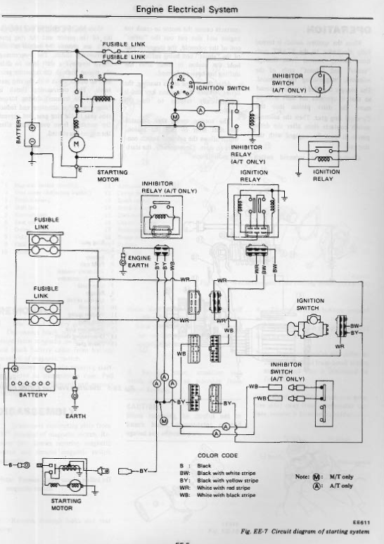

I did try to start the car today but had a fuse problem.  I'm using some in-line fuses to replace the original fusible links and as soon as I moved the ignition switch to the on position (not the start position) the front inside fusible link position blew the 30 amp fuse that was installed.  I tried again with a 40 amp fuse with the same result.  I know that position on the fusible link block controls the ignition switch.  Should I try a higher rated fuse?  Was the 40 amp one strong enough to support the ignition system?  I'm reluctant to go much higher and then do damage.  This car has be setting for a couple of years.  The ignition switch doesn't move very smoothly so I suspect it my be causing this problem.  I do have a new ignition switch on my shelf but I don't like tossing parts at a problem before I have an understanding of the cause.  Any thoughts?

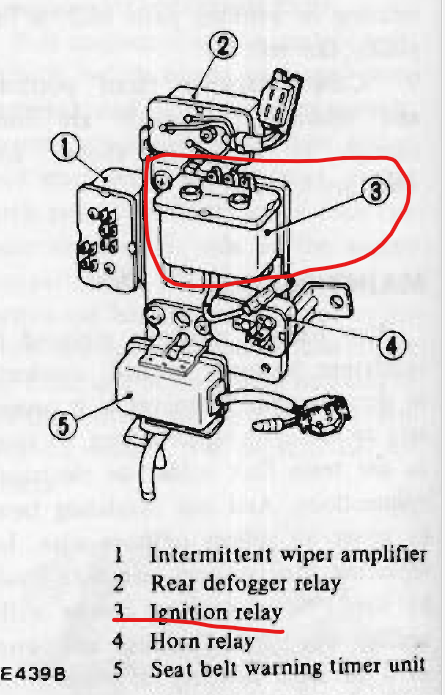

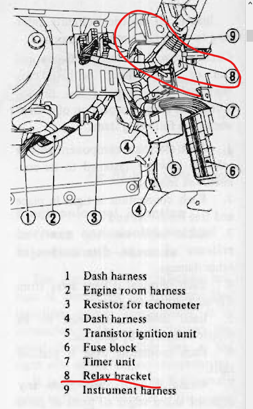

Pull the ignition relay. It's around the passenger kick panel
Put in another 30A fuse. Turn the key to ON. See if you smoke the fuse again. If not, get with me on tracing down the short downstream of the relay.

You must have a short circuit after the ignition switch.  Could be the ignition/accessory relay or something after it like the ignition system (coil, etc.).
If your car was or is an automatic there are two inhibitor devices that could be shorting.  The simplest starting point is at the plug to the ignition switch.  Unplug it and check the black with white stripe for continuity to ground and the same for the black with yellow stripe.  That will split the system in to two parts.  You have a dead short after the switch.
SteveJ just posted.  Better see what he said...looks rational (of course).  So, there's two separate things that you can do to narrow things down.
The Engine Electrical chapter shows all of the pins that you can check at the plug for a short to ground.  If it was me I'd just unplug that plug, set my meter to beep for continuity and poke, poke, poke.  The beep will be the problem circuit.
Edit - actually, the beep would not be the best signal.  You'll get a beep through the relay solenoid.  Best to read resistance.  The one close to zero is the problem.  Then find that pin in the wiring diagram and follow it out.
Here's another circuit, after the relay.  If you find that the ignition relay itself is good then check each pin after the ignition relay.  The relay will pass plenty of current to blow those fuses.
