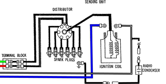

3 hours ago, mayolives said:
black w/ white stripe ( has blue shrink wrap on end)... It is hot when key is in on position.
I will need a power source to the coil.  Some advice would be greatly appreciated.
Use the factory ignition wire.  Black with white stripe.

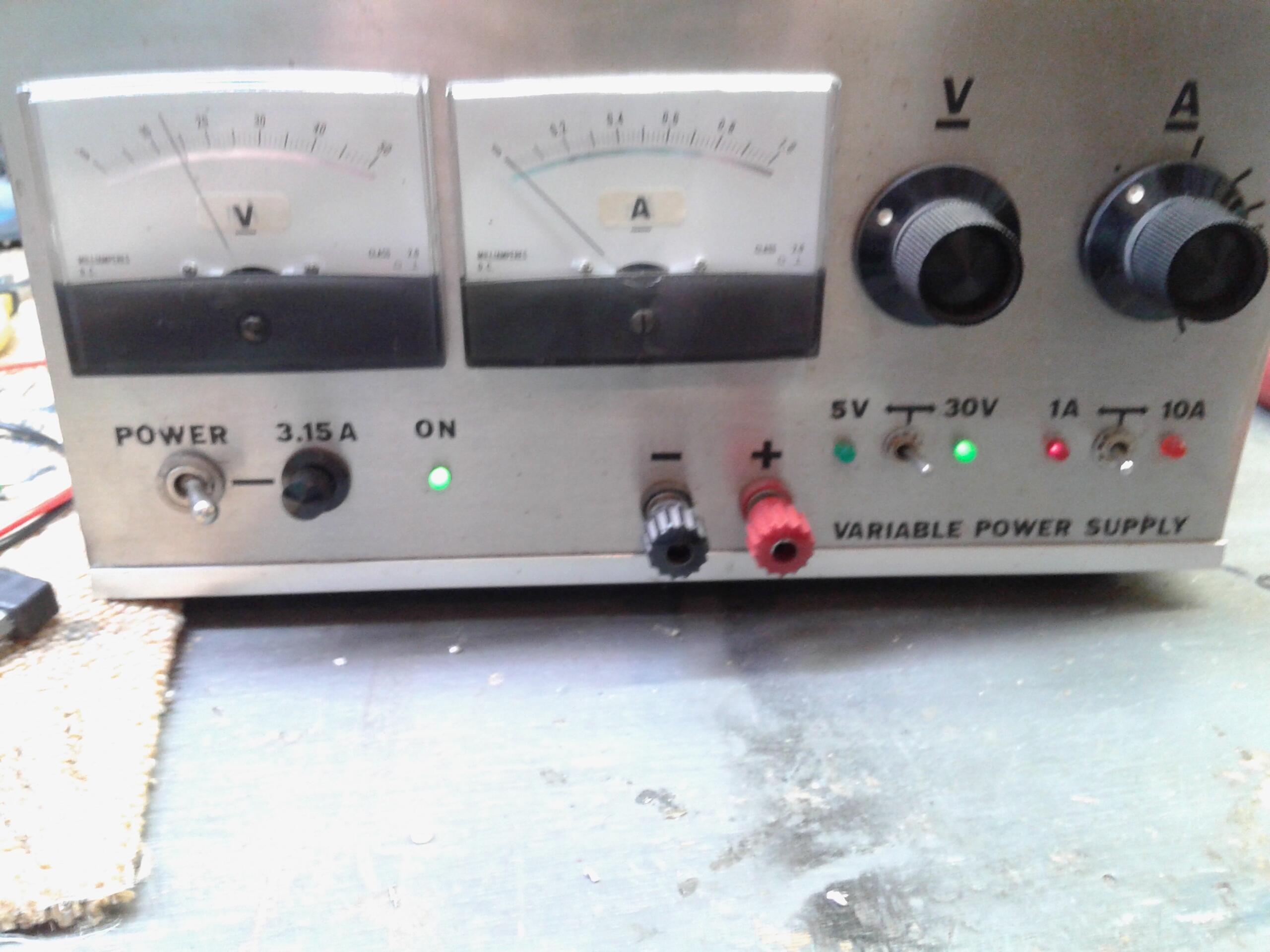

I realize that I'm late to this thread, but I would like to add my experience while I recently brought my entire electrical system back on-line.  Rather than use a battery, I used a cheap 'laboratory' power supply, capable of 12 volts at 10 amps.  The nice thing is that you can put it in current-limiting mode to limit the current to, for example, 1 amp, or even less.  This can let you do a lot of testing and probing without burning things up.  It also lets you see the current draw of the working circuits.
The price of those powersupply's are a bit laughable,ridiculous..  For that money i only had the transformer.. and in my own made one in the 1980's there are 2! transformers.. i bet these "new" supply's have none..  My selfbuild supply does 0-30 volt 0-10 amp. and... more important... it still works after these many years.. (only once needed a new IC.  the Ua723 i believe..)
All that "amazon" stuff is made with "switching" regulator..  the ingoing voltage is getting "shopped" into small peaces, It's a way of lowering voltage without a transformer.. i don't like them at all..  they say it's "durable"but they say that of everything these days.. to me it's cheap junk..🙊
