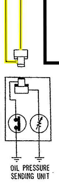

A 78 oil pressure sender can be adapted for this: https://www.rockauto.com/en/moreinfo.php?pk=488596&cc=1209260&pt=4588&jsn=830
You can get the female T connector from Vintage connections and wire the gauge connection to a female bullet to connect to the engine harness.
According to the 78 wiring diagram, the horizontal pin is for the gauge, and the vertical pin would be your switch.

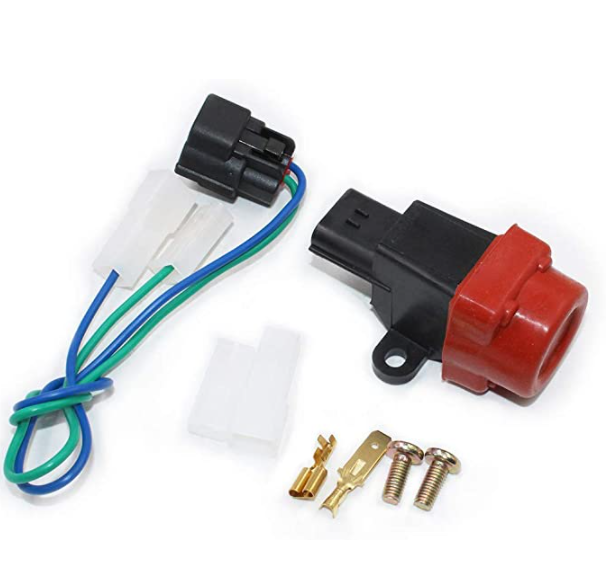

You can also install an inertia switch like this and put it under the dash. https://www.amazon.com/gp/product/B07RBK4873
The trick with the one in the link is that you need to swap one of the wires from the normally open to the normally closed position. I helped a friend install one of these in his track car, and he has not experienced accidental activation of the inertia switch.

I considered the Ford inertia switch, but never implemented it. Good idea though, especially if running fuel injection, given the higher pressure and flow rate.

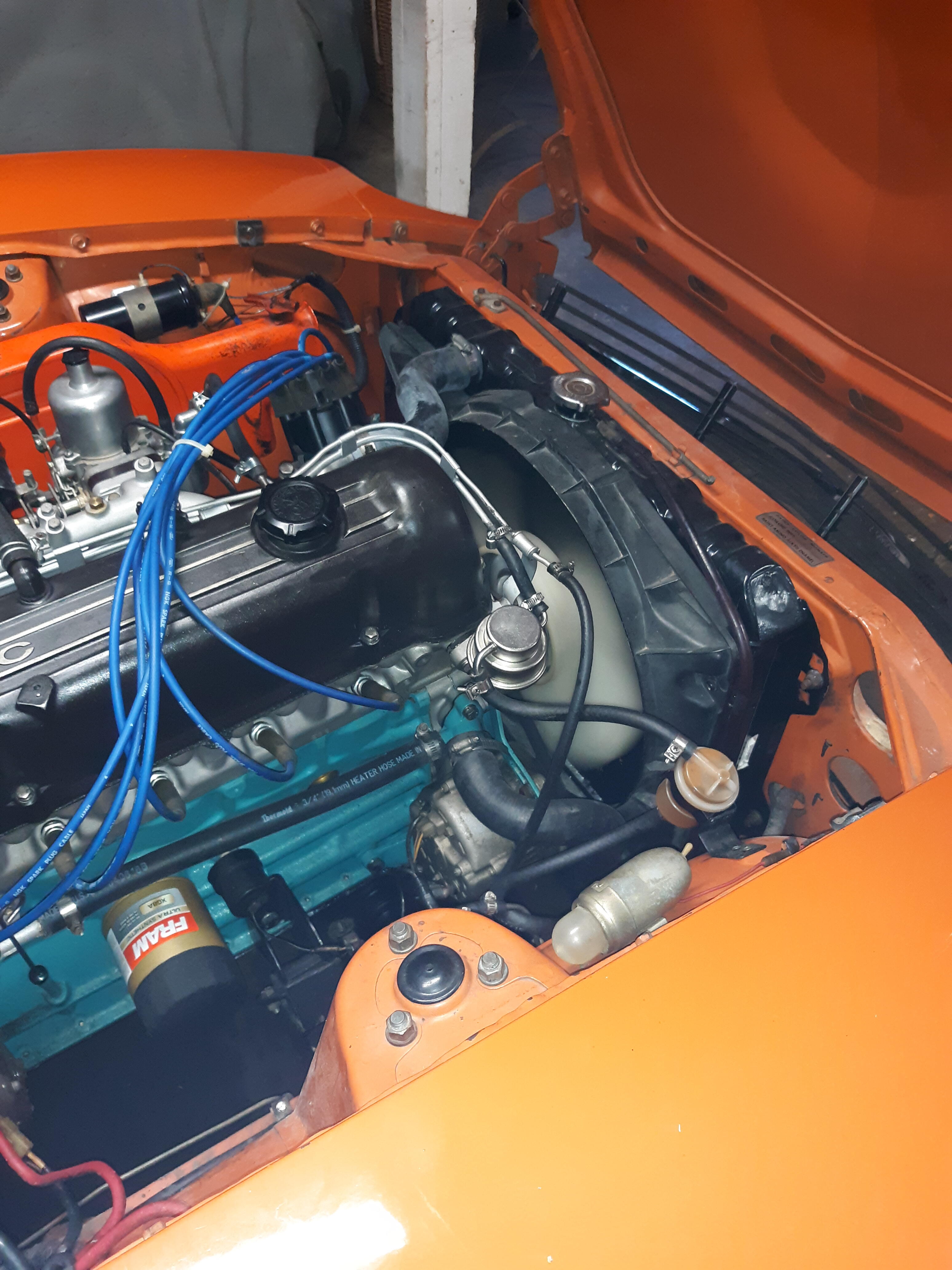

In your original post you mention that you don't run your 240z frequently and that you thought the diaphragm may have dried up and caused the pump to fail or not perform as it should.  Sorry if this is off topic.  During the restore of our car there have been long periods where the car has not been started.  I am running a mechanical pump without the benefit of an electric.  I have a fuel filter before the pump.  I too was having issues starting after the car sat for a while.  After sitting for a period of time the fuel filter bowl was always empty.  At first I did not think much of this, but that changed with time and effort.  Since the car is in the process of being restored most of its parts are new or restored.  New fuel pump, new hoses and clamps, restored fuel tank, restored SUs, restored plumbing from the pump to the SUs., ... etc.  I read that many of the cardone fuel pumps had issues so I purchased another pump, but it too was not able to suck fuel from the tank.  I got to be an expert at filling fuel bowls by hand, to get the car started.  I was thinking that my fuel pump was not strong enough to pull the fuel the distance from the tank while it was cranking and that it was taking too long to crank the car to fill all the lines and the fuel bowls. A friend suggested that there was an air leak that was causing the system to lose its vacuum, and that the tell tale was the fuel filter bowl being empty after the car sat for a while.  He talked me into checking to make sure that the right size (diameter) hoses were everywhere.  Sure enough I did have some that were a bit larger than they were originally.  While I never really proved that the diameter of the hoses and clamps was the issue, the fuel filter bowl now is able to stay full even after the car sits for months.  I believe if I checked the fuel pump that there would be fuel in the pump keeping the diaphragm wet.  Anyway, I was considering going to an electric pump but forgot about it after my issue was resolved.  Don't get me wrong electric fuel pumps are great, a little noisy sometimes, but pushing fuel at a constant rate is beneficial.  Really like Racer X's and Steve J's safety solution.
