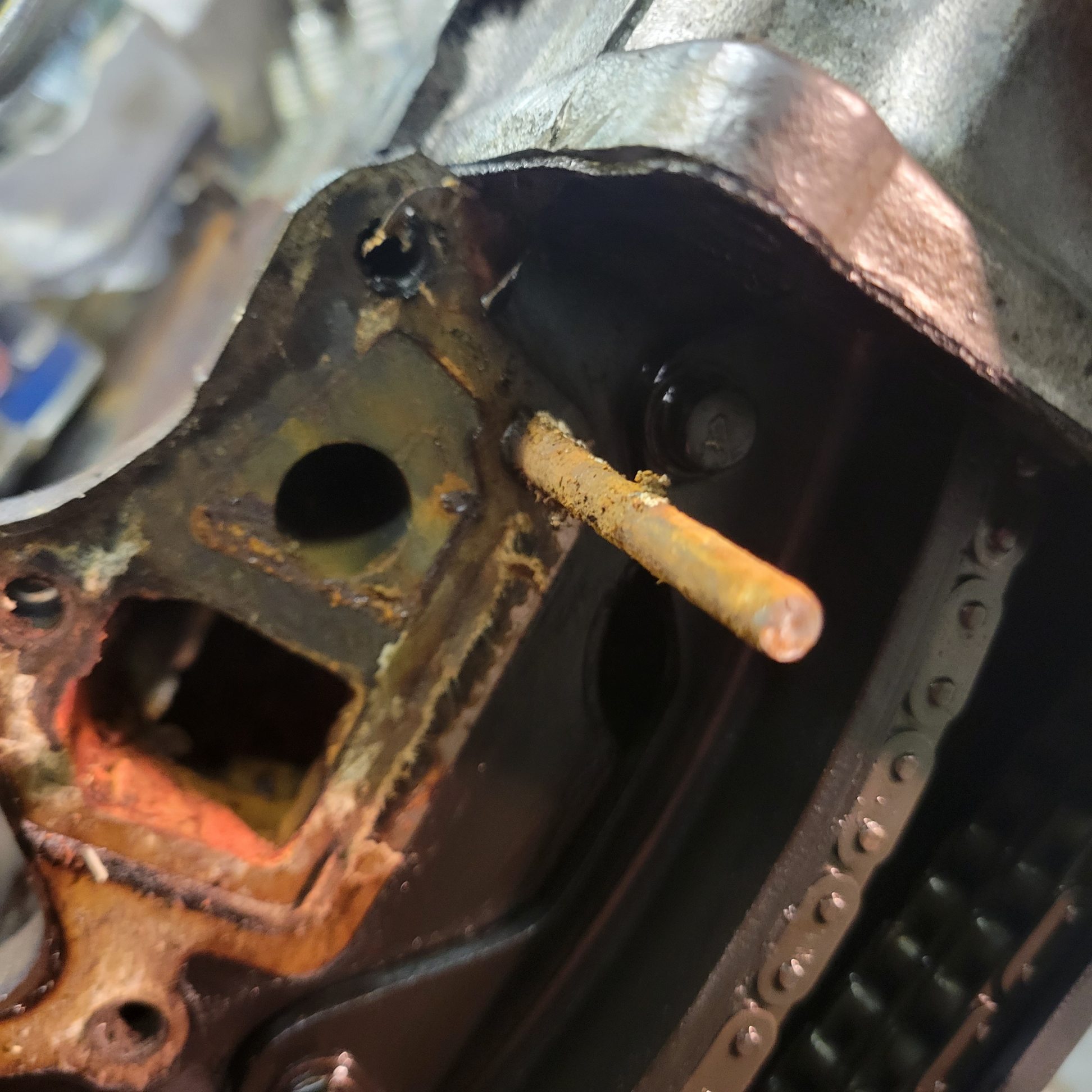

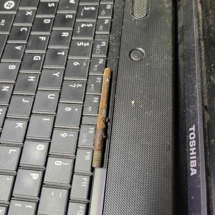

Cover is off but for the record, it does not drop down at all. There are alignment pins that prevent that. Also, how dumb is this thin long water pump bolt. I have worked on engines for over 40 years and have never seen such a bad design.
Worked on engines?  i'm sorry but you polished engines or so?:ph34r:  Well you ask a LOT of questions that are simple to answer for someone that worked for 40 years on engines? What you have there is a bolt without it's head... some guy... must have taken it right off!
21 hours ago, ennisdavis said:
Thats the point to me posting the picture. The head broke off because the bolt is thinner then a pencil. As long as one too. And thats not a bad design?
Not sure why you are trying to redesign the L motor . Take any other engine of its era and will see it’s a superior design . Properly maintained it’s probably one of the best engineered engines of its time . That bolt would have been fine if the owner had used coolant instead of water . We see it all the time . I challenge you to find a motor of that period that has forged internals for the most part and precise machined surfaces .
