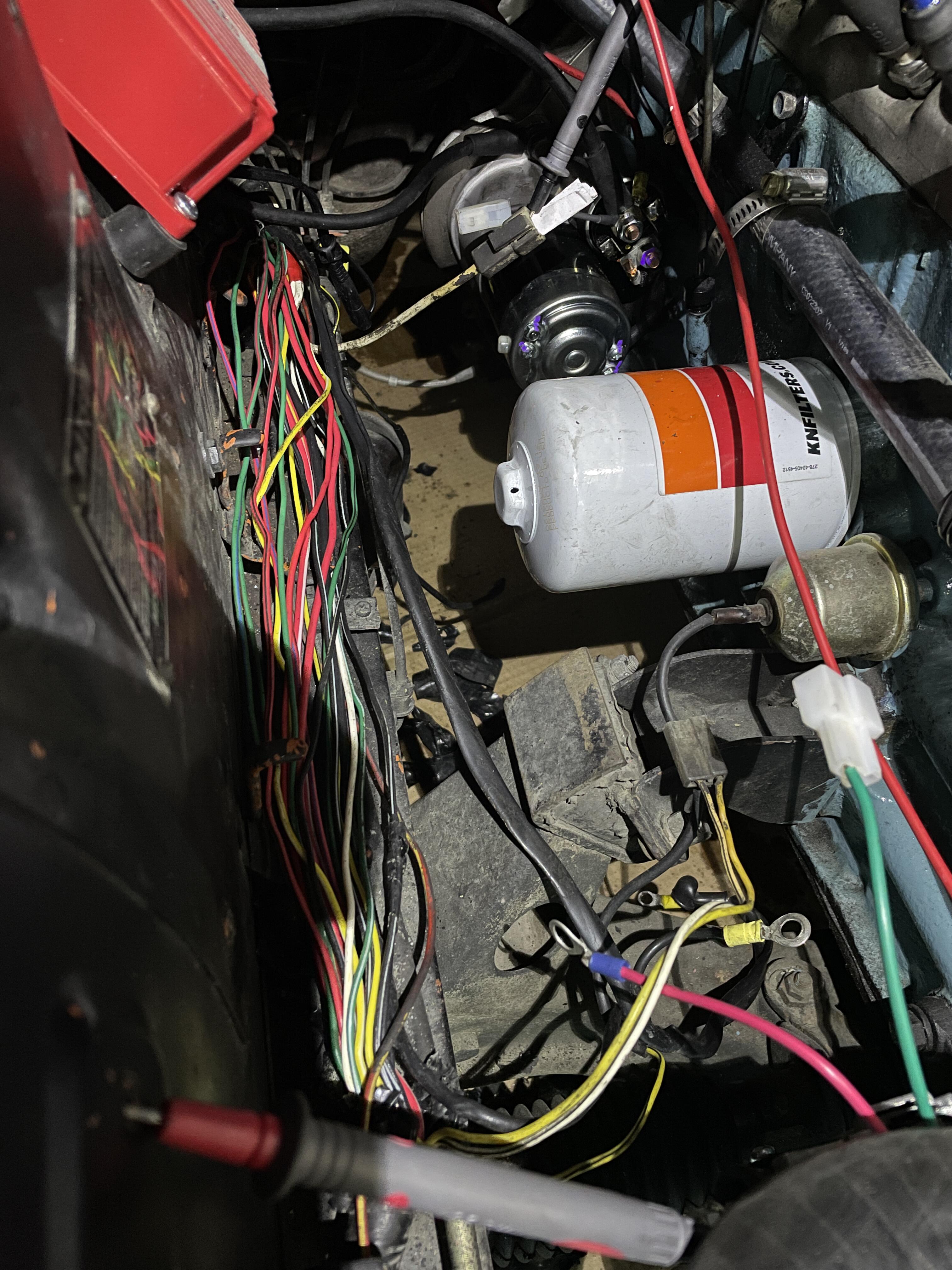

I may have not given you a clear methodology for testing. I went out to my car to verify.
For the resistance test, measure from the fusible link connector in the engine bay wiring harness to ground. See the photo.
I tested my car, placing the other test lead on ground. It was about 880 Ohm.
That would mean a potential draw of around 13mA.
Can you measure the resistance at the same points?

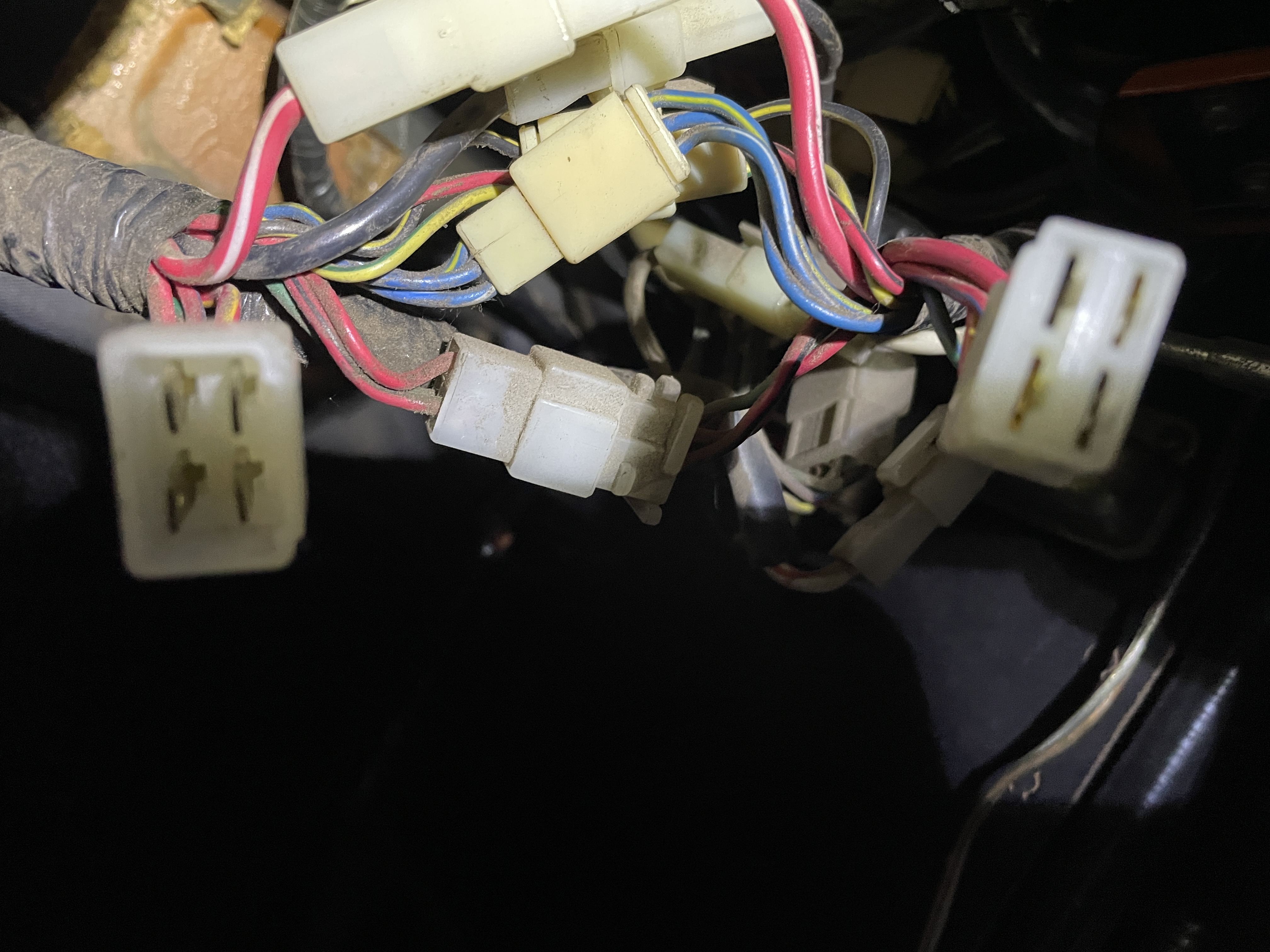

So locate the two connectors circled. They will be around the dash on the passenger side. Disconnect them and repeat the resistance measurements in the engine bay. Disconnecting those wires should isolate the wires from the alternator and battery in the engine harness from the dash harness.

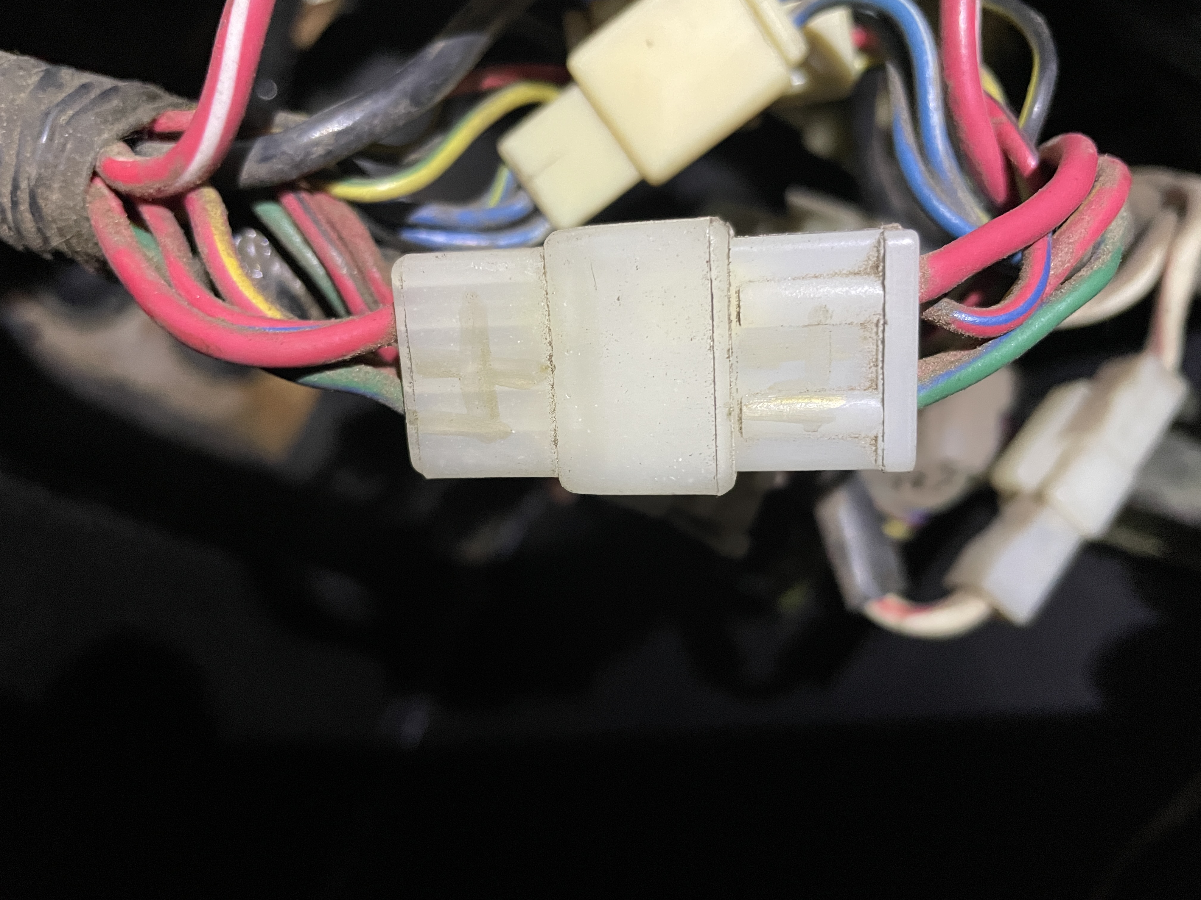

Ok, more diagnostics, and pics.
I found the molex connector in the PS footwell that links to the fusible link wire. In the pics, see a 4 pin connector; when I pull it, my impedance goes OL. Obviously, I need to figure out where this traces to, but this is progress.

1-disconnecting this single pin, white>white red connector at the PS footwell ALSO drops impedance to OL.
