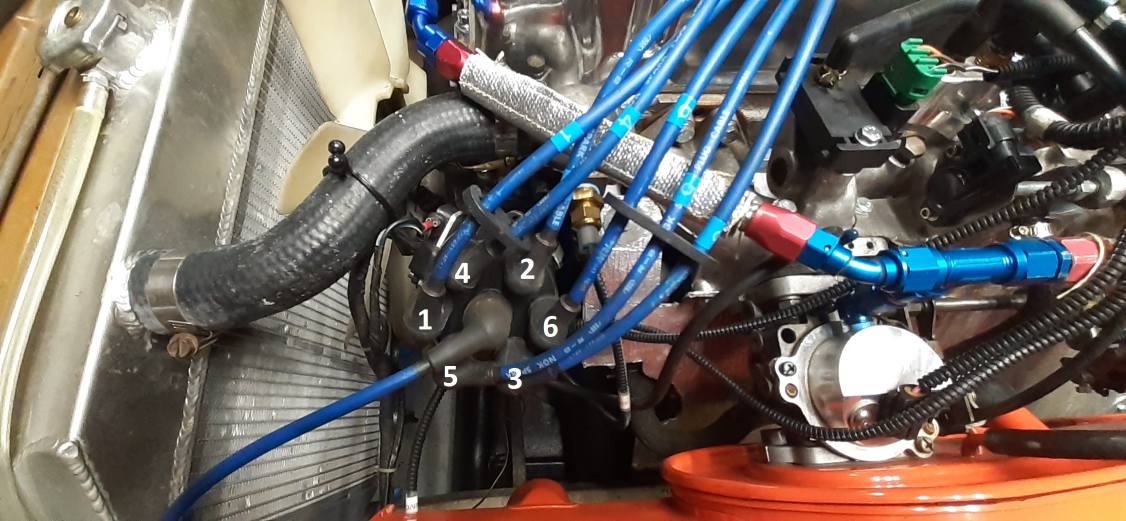

You have not said anything about verifying firing order (1-5-3-6-2-4 counterclockwise)

2.    I am 99.9% sure the firing order is right. I did this and followed that image of 1-6 order.
