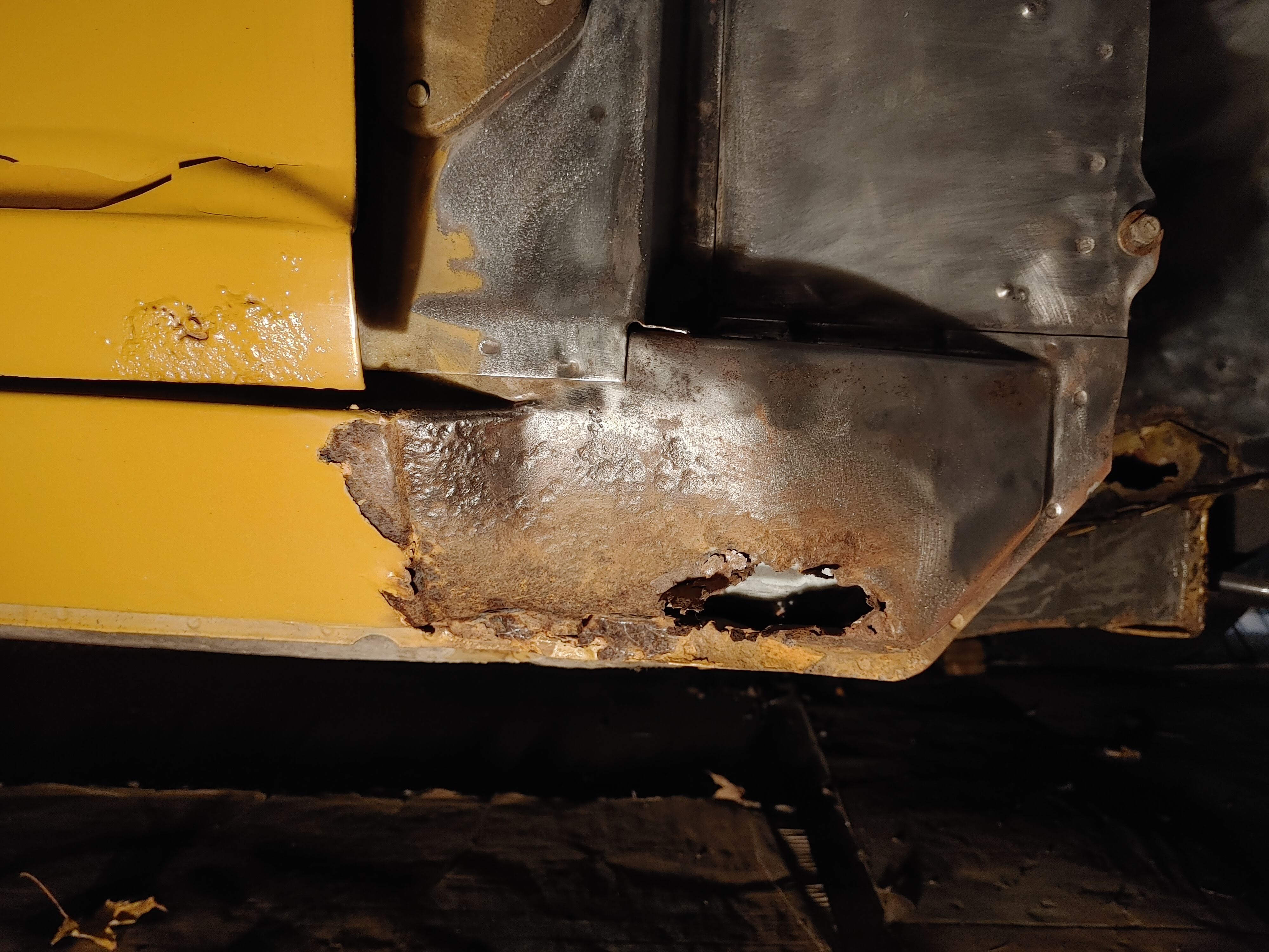

Perhaps, instead of fighting Mother Nature, you let her work for you?  Attach hoses to those cowl drains and terminate them in the area of your concern.  Then, when it rains, that water will work to flush out whatever crud that may have accumulated in the lower fender.  You could also periodically pull your cowl and then flood the drains with a garden hose to flush out gunk and follow up with a blast of compressed air.
Not a bad idea in concept, but the I think the problem is that the rear fender reinforcement panel, specifically because of how the shape of it twists at the bottom where it is then spot welded to the outer fender panel - it makes a "wedge" area which literally traps debris.  Sure, the water (gravity fed) will flush the area if you route the drain to this location, but I don't think it is accurate that it will flush out all of the debris.  Depending on the shape of the debris, it can get stuck in a way such that it will not get flushed out.  Also, focusing the drain from the cowl area, in addition to flushing with water, will add a new source of debris.  Anything that finds its way past the cowl panel vents in the top of the car will work its way to the cowl drain holes.  Think propeller seeds... or pine straw, for example.  Debris that doesn't flush out holds onto water every time it rains... thunderstorms... or possibly even sprinkles... or the car is washed, etc.  Thinking about it, I am now of the opinion that the main contributor of that debris in the first place is the cowl drain.

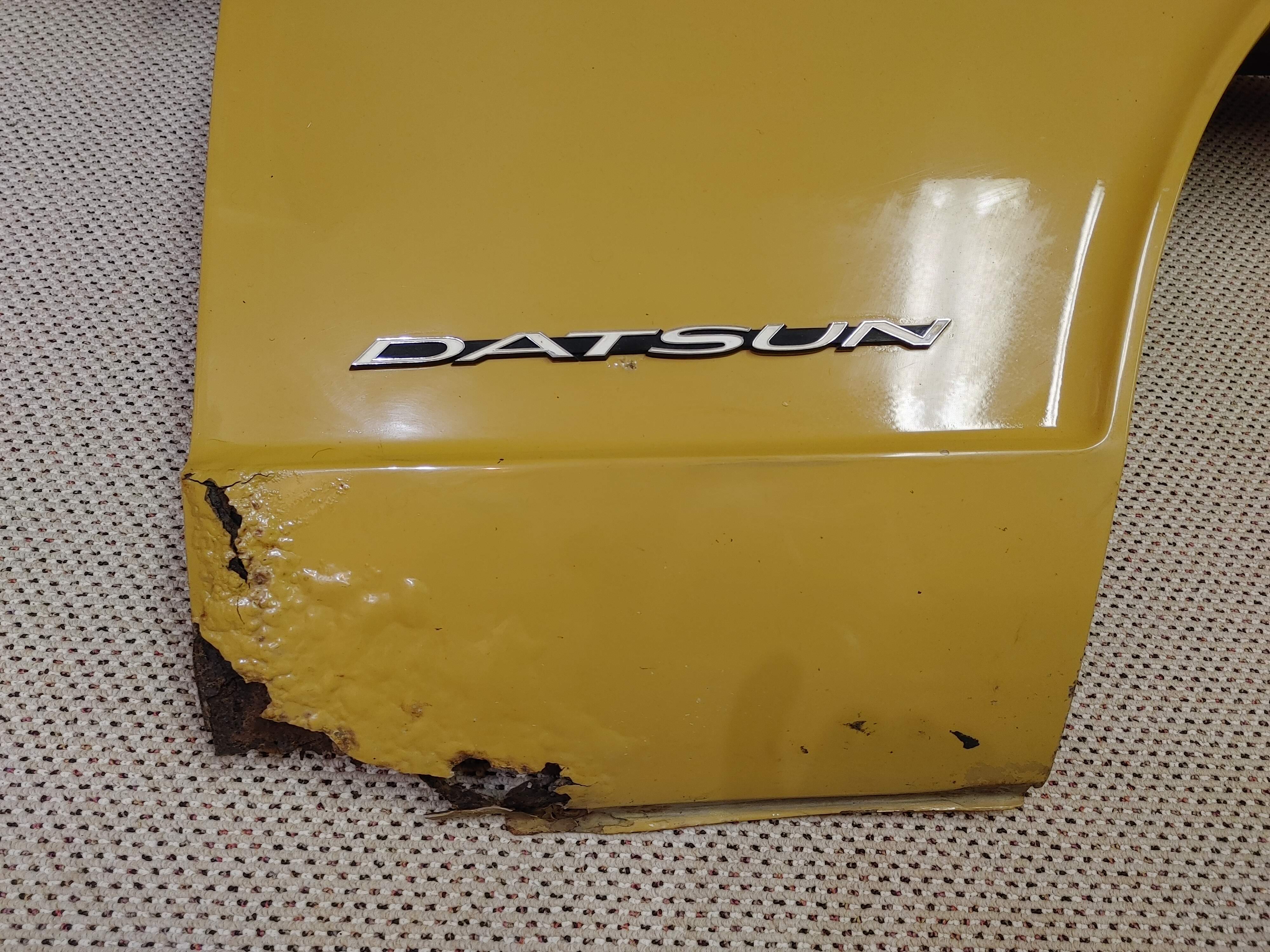

Anything functional that comes out of this discussion will be of interest to me next year (or maybe the year after to be realistic)! The driver's side is identical. It really seems like a monumentally bad design to me! Hey, how about we funnel water and cowl debris into an enclosed, invisible area between two tight-fitting pieces of lightly rust-proofed metal?!
I know!  And, all the time and money that has gone into repairing and then painting 💰💰💰💰💰 on everyone's Z before us... and possibly will go into every one after us!  I mean, I REALLY don't want to have this area rust out again on my restored Z after I spend 2000-3000 hours and tens of thousands of dollars on it.  Just not an option.
For what it is worth, I considered removing the lowest 4-6 inches of the reinforcement panel, in order to remove this "trap", but there is one of two bolts which secures the lower fender here, and without it, the shape of the outer panel will be altered, and unsupported.
