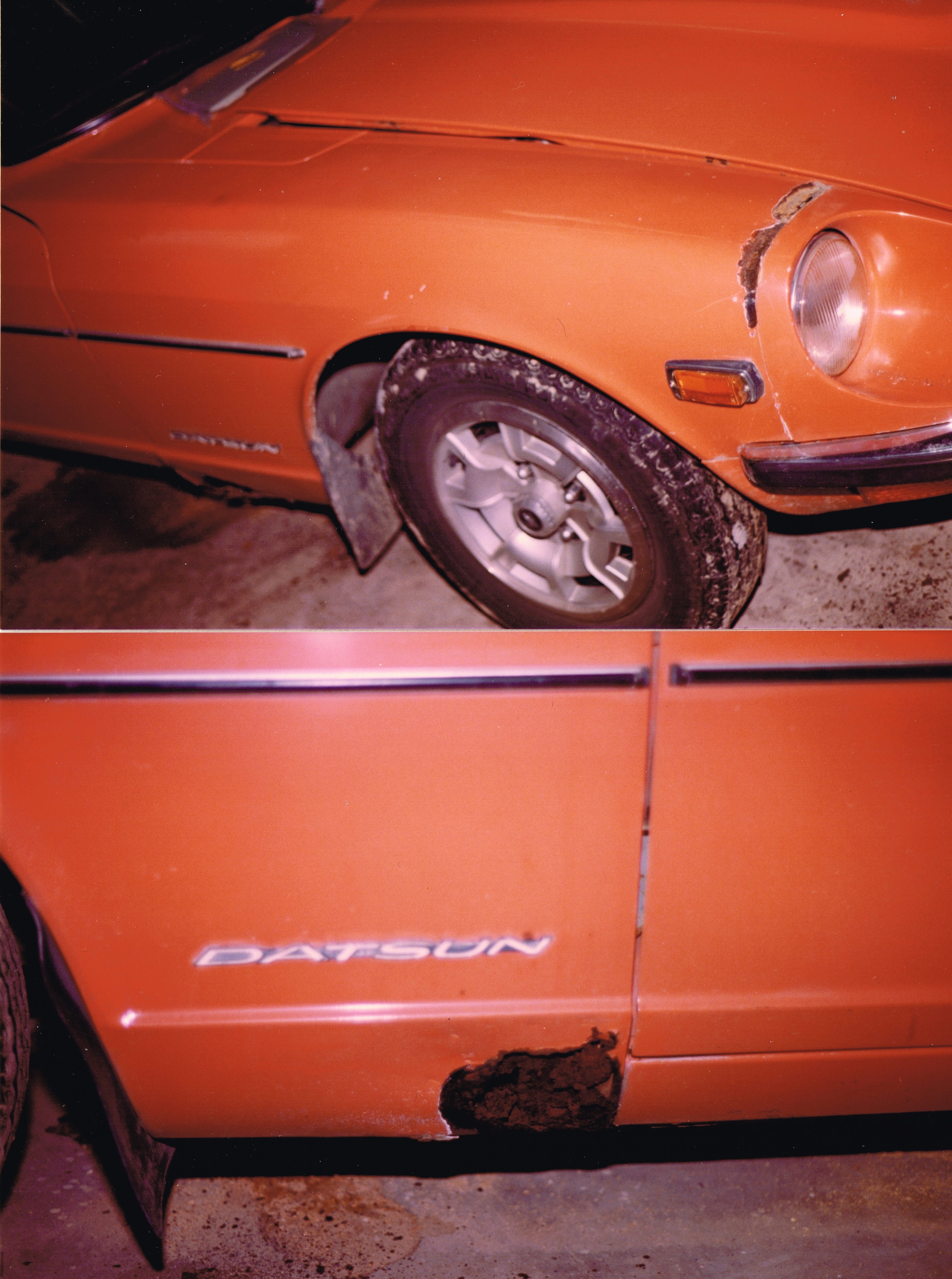

Oops, yes miles. Before the 1982 resto mine had a flapping fender as well, LOL. Here's what it looked like...

HAHA.. yeah... mine came off on the parking near the supermarket..  i left it flapping on the way home.. drilled some fast self drilling screws right through it and.... now after a year they are still in there! 🙈 oh well.. maybe in a year or 2...

Funny how "temporary" is a relative term in "temporary repairs".
