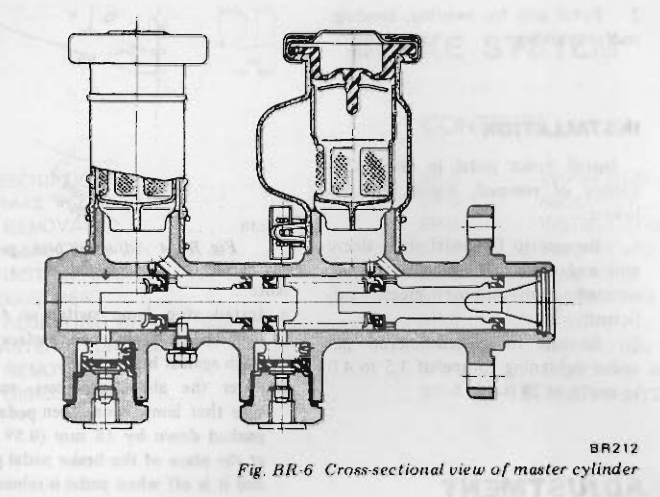

Zed Head Posted November 14, 2021 Share #17 Posted November 14, 2021 3 hours ago, Dens240 said: When I push the brake pedal to the floor, the brake pressure differential warning light comes on. Your problem sounds a lot like mine when I had the bleed screws on the bottom. But yours are on top. What method are you using for bleeding? The MC's can leak internally, the seal for the fronts can blow and the fluid just washes back and forth over the seal as the piston moves. And quality of aftermarket parts is poor, in general. Parts from the same manufacturer might have had the same unskilled person building many MCs in a row, repeating the same error. If you decide to try another MC try a different brand. I'm going to bet on bleed technique though. Link to comment https://www.classiczcars.com/topic/66038-front-brakes-dont-work-need-help/?page=2#findComment-631533 Share on other sites More sharing options...

Diseazd Posted November 14, 2021 Share #24 Posted November 14, 2021 1) Bleed the front master cylinder resevoir again 2) then bleed both front calipers again. If that doesn’t help, remove the master cylinder (you don’t have to remove the lines to push it aside), then pull the plunger and check to see if the reaction disc is in place. 3) if not in place, fish it out and super glue it on to the plunger. Good luck Link to comment https://www.classiczcars.com/topic/66038-front-brakes-dont-work-need-help/?page=2#findComment-631561 Share on other sites More sharing options...
